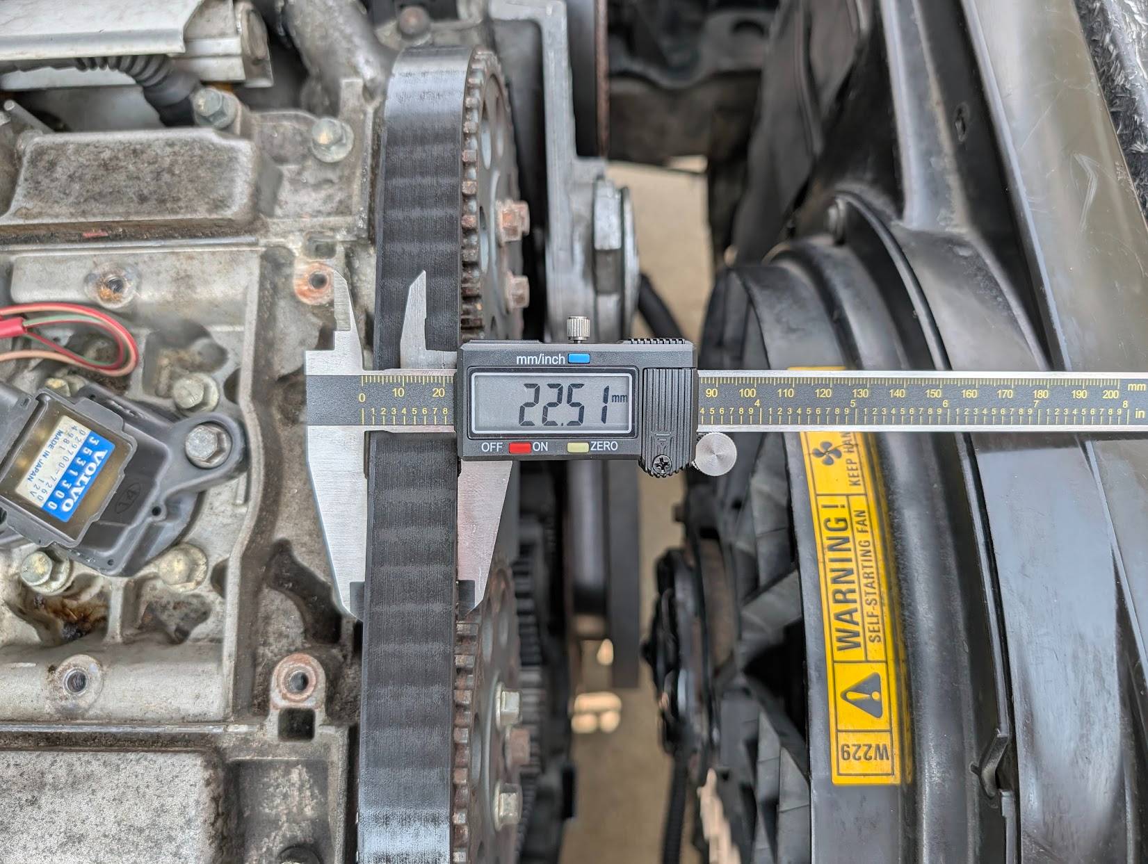

The width of the installed belt is 22.51mm.

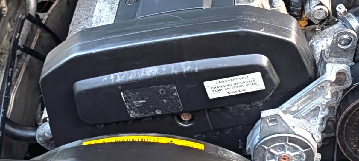

The camshaft cover has a sticker that mention a 50,000 mile change interval.
Should I be fine ordering the 23mm width timing belt? Are there any other clues I could look for that would help me determine the correct size to order?
