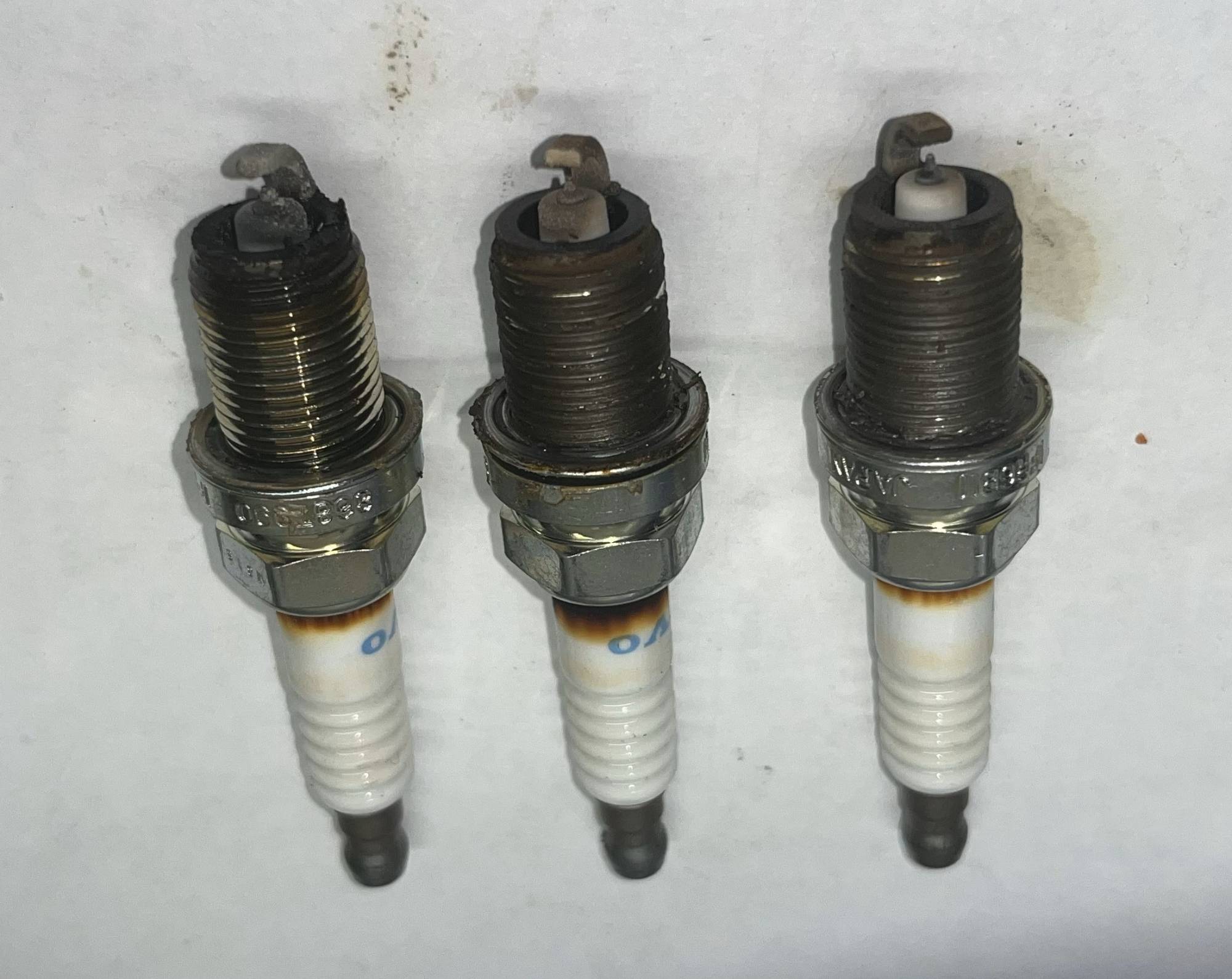

Here are the spark plugs for #1, #3, and #5 that I pulled out when I was first troubleshooting this issue. The fouled one on the left is #1.

Any thoughts on what this looks like? I can't decide if it's because it's running too rich, or if it's because there is oil getting into the cylinder. Or does it look like lean misfire?
Opinions please, I appreciate the input!

The #1 spark plug could be all of the above as far as rich, lean, and oil. Do you have a picture of cylinder #7 spark plug because it looks like the plugs get gradually better the further away it is from cyl #1. The #3 spark plug's ceramic looks like it was running hotter than the other two. Is this a boot issue or has any oil dripped into the spark plug holes? The gradual difference, following the cylinder order, may be a sign of a vacuum leak at or near cyl #1 and the average A/F of bank 1 is taken with the O2 sensor for fuel trim adjustments.
An alternative scenario, but the same repair
It could also be the opposite where the issue is with, or closer to, #7 getting lean with a vacuum leak and then the fuel trims richen up bank 1. Cyl #1 is working fine, but gets too rich with the fuel trims, fouling the plug. If there's a vacuum leak making #7 lean, then that could also affect the cold start.
Were these pictures taken before the PCV? Did you clear the codes after you did the PCV and hoses?
When you took the upper manifold off, did you happen to take pictures inside the runners?
Also, check the timing if it's being pulled or if there's a healthy advance. The borescope could be small enough to get a closer look if there is a sign of a vacuum leak; it's worth a try for cylinder #1 or #7. Nothing to lose. You might even be able to run the borescope inside the upper manifold (and TB gasket & boot) to see if you can spot any light poking through from the outside, a sign of a leak. Just keep an open mind to where a potential leak could come from.
One last question, what oil are you using?
Have you read this post: https://www.swedespeed.com/threads/oil- ... st-8046070
