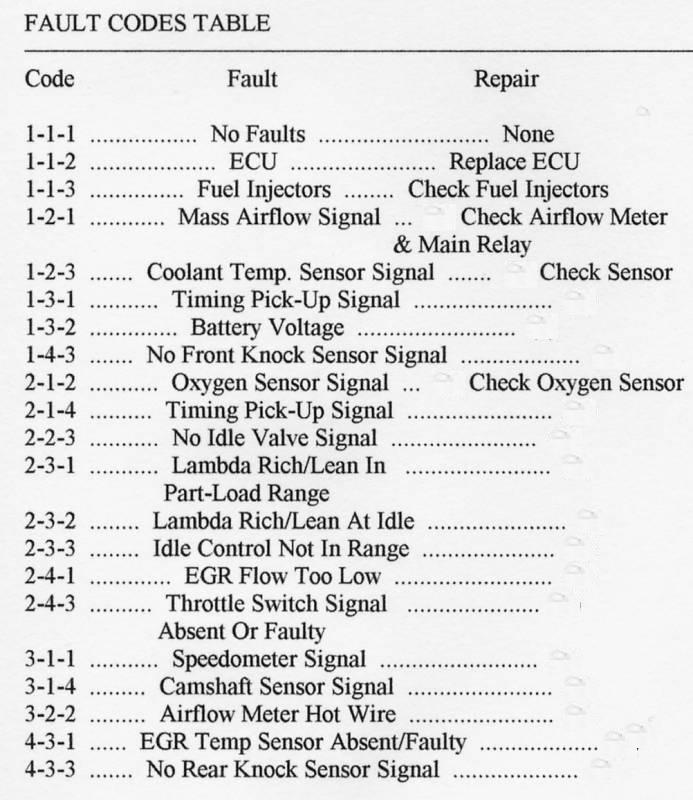

No special tool is needed. The On-Board Diagnostic (OBD) is in the engine compartment.
To use it see: https://www.matthewsvolvosite.com/forums ... c&start=12
The method of use does apply to your car although headed for the 740 but the codes are different.
The 960 codes are:
Bill.
The 960 codes are:
