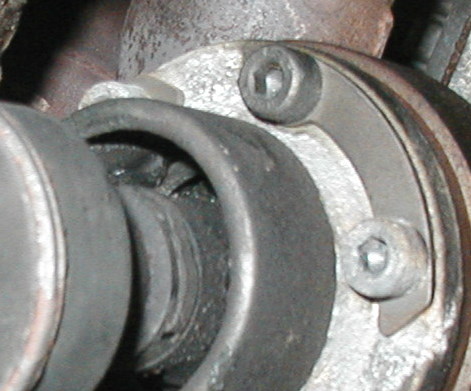

This site in incredible. I am in process of removing rear driveshaft from my 99 xc70 to make it front wheel drive.(Driveshaft is bad and I am curious if I will feel any slight increase in power w/FWD) What size torx do you use to remove driveshaft? The closest size I have in my set is a T40 and it was stripping. Has anyone removed the driveshaft and made a generic plate/ cover to place over viscous coupling to prevent debris from going inside? Thanks...
Remove rear driveshaft- 99 xc70
Some people on the V70xc forum have removed their driveshafts. Check to make sure what the bolts take, I think they take an allen wrench rather than Torx. Here is a picture of the front coupling.. The coupling was bad on mine but I replaced it.

Commlend, if you do remove it, please post back to this thread any observations/impressions you have. We don't have anything on this; I searched the far reaches of the site just now and turned up nothing.

Just one other suggestion. In other posts I have read that it's important to mark the bolt locations if you plan to put the same driveshaft back on at some point. This is for balance.

ummm more AWD fun
1: FWD owns AWD in reliability from 98-02 (USA market)
2: The first image has a ripped boot
3: If you strip the bolt you are in for some fun, go a little oversized and hammer it in there with all you can!
4: You don't need a place for the VC
5: It if VERY VERY common to remove AWD! I HIGHLY recommend it unless you have the funds and know how to work on the system yourself. I am going on a stock pile of 3X drive shafts, 4x couplers, and 3x bevel gears JUST for if I buy another AWD
6: The 03+ systems do NOT apply to this system so the ebrake will not work. The 03+ have the electronic Haldex VC so you can run sets of 2 tires instead of a complete set of 4 tires. As in you don't have to worry about the 3/32 tread difference from front to back. 03+ systems OWN 98-02 systems
