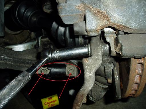

Here's a pic of where they are. Disregard the wrench in the photo - the photo was taken for a different purpose. The Stop Limiter is in the elipse and is held on by the two bolts - I think they're 12mm.

Aha, that must be it!
Thanks for posting.
