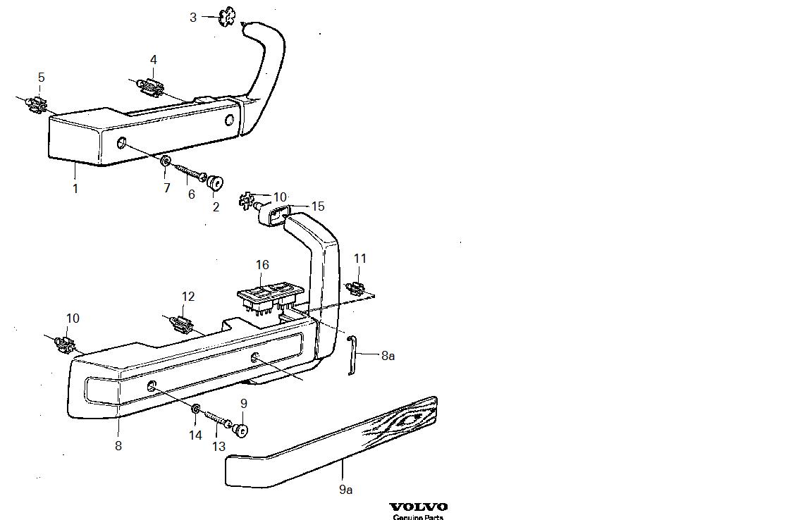

Look up under the handle for a screw (see photo). If you don't see one, I think you'll have to remove the whole panel from the door first. It looks like there are two other screws in the lower part of the armrest (not shown in your photo) that need to be removed (according to the VADIS parts diagram).

Here's the parts diagram:

Thanks for your advise and diagram. I took the three screws loose in the lower part of the arm rest, two behind plugs and one exposed in the front. Then, based on your diagram I decided to turn the whole thing. I turned it clockwise about a quarter turn and out it came. It has a metal ear on it that fits int he hole. Simple but hard to figure out the first time.
