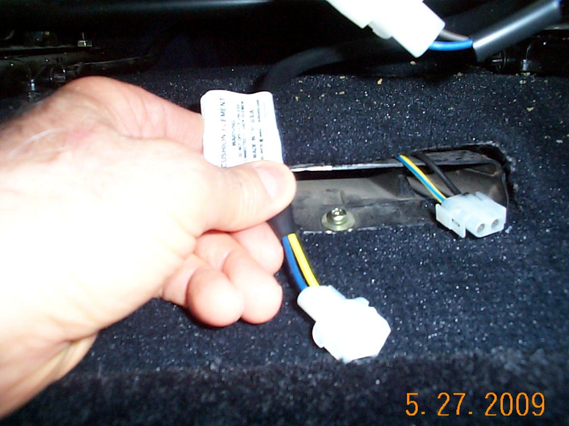

Looking at the wiring harness and the Volvo connector under the seat by the A/C duct.

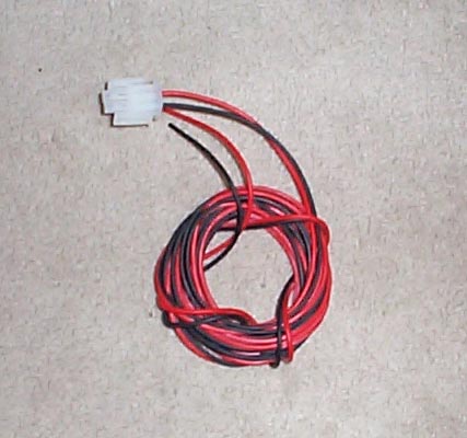

Picture above is hand holding the connector to the after market seat heater. Other connector is the original Volvo connector.

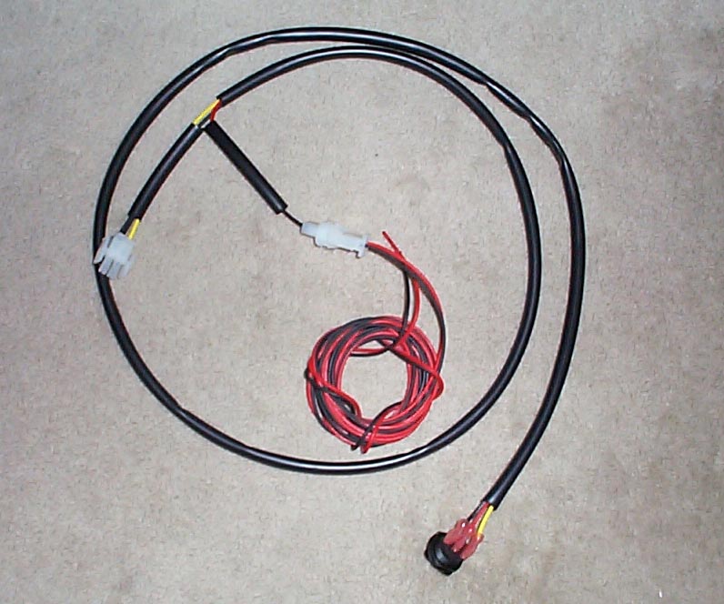

Above is a picture of the wiring harness which has a switch and a fuse (fuse not shown).

The Volvo connector has a BL/Y (hot-?) wire and a BL (ground-?) wire.
I would cut the Volvo connector off.
Disconnect the male connector off the wiring harness (which has a R and BLK wire) See below picture.

1. Splice “one end of the after market in line 7.5 amp fuse” to the BL/Y wire (on cut-off Volvo connector).
2. Splice the other end of the after market in line 7.5 amp fuse (not shown but furnished in the package with the after market heater) to the Red wire on the after market male connector that was on the wiring harness.
3. Splice the BLK wire (on cut-off Volvo connector) to the BLK wire on the after market male connector that was on the wiring harness.
The above would basically place a new male connector with an in line 7.5 amp fuse on the “original Volvo” wire above the air duct underneath the passenger seat.

Welcome to Matthew's Volvo Site.
That should work and save a lot of time rewiring.
Bill.
