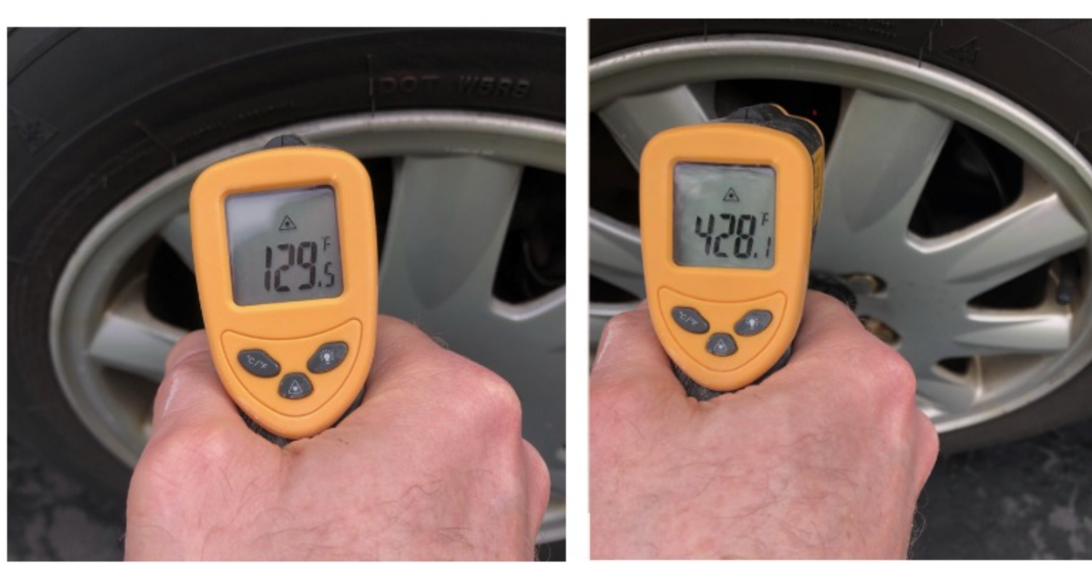

On the day I noticed this, I was driving normally and applying the brakes in a normal manner. I could smell the burning brakes and could feel the heat from about 1 ft away .How hot did it get? Did the rotor glow red? I did that once on my truck, and I'm assuming that's why the unit bearing hub needed to be replaced before the other one.
On the drive home, I drove to minimize applying the brakes to avoid having the brakes get locked on.
On the highway, I don't think I tapped the brakes at all (having a manual helps with this). Once off the highway, I still drove to minimize applying the brakes but had to use them occasionally. With minimizing brake usage, here is what the temp differences looked like.
129 = passenger side = working fine.
428 = drivers side = sticking side
I am guessing on the day I first noticed this , the temps could have been twice this. With the temps below I had to hold my hand near the rim to feel it.
even on the first day with the higher temps I did not notice any visual color or glow.
And thanks for all the great replies and suggestions.

Those IR tools are much better thn fingertips.
Replace caliper , new pads? , leave rotor
