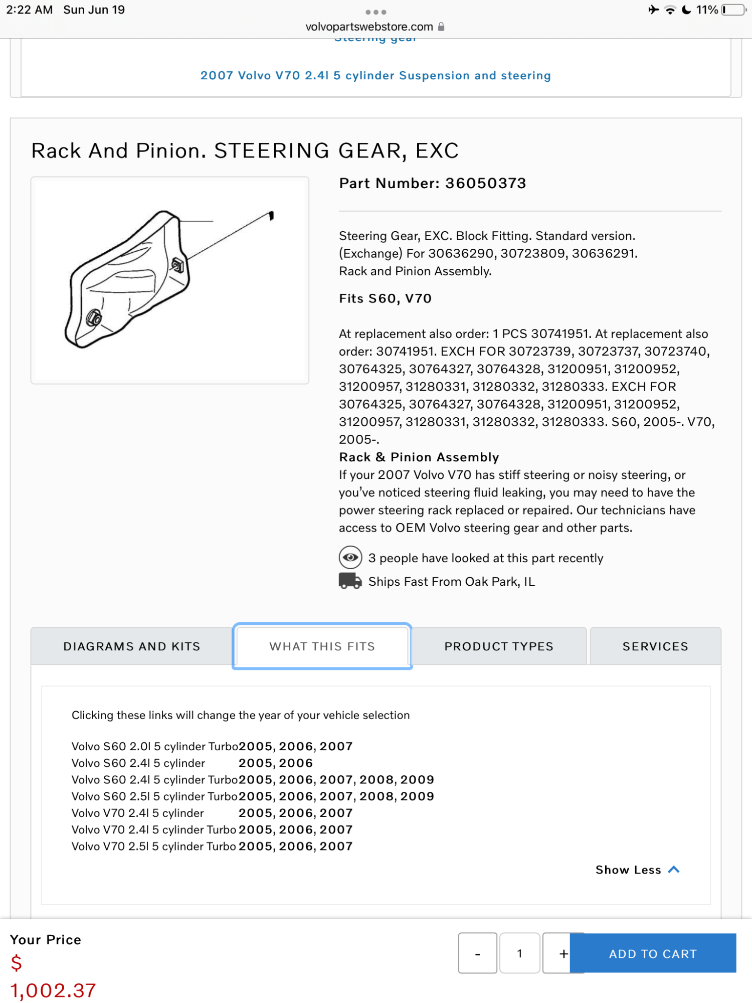

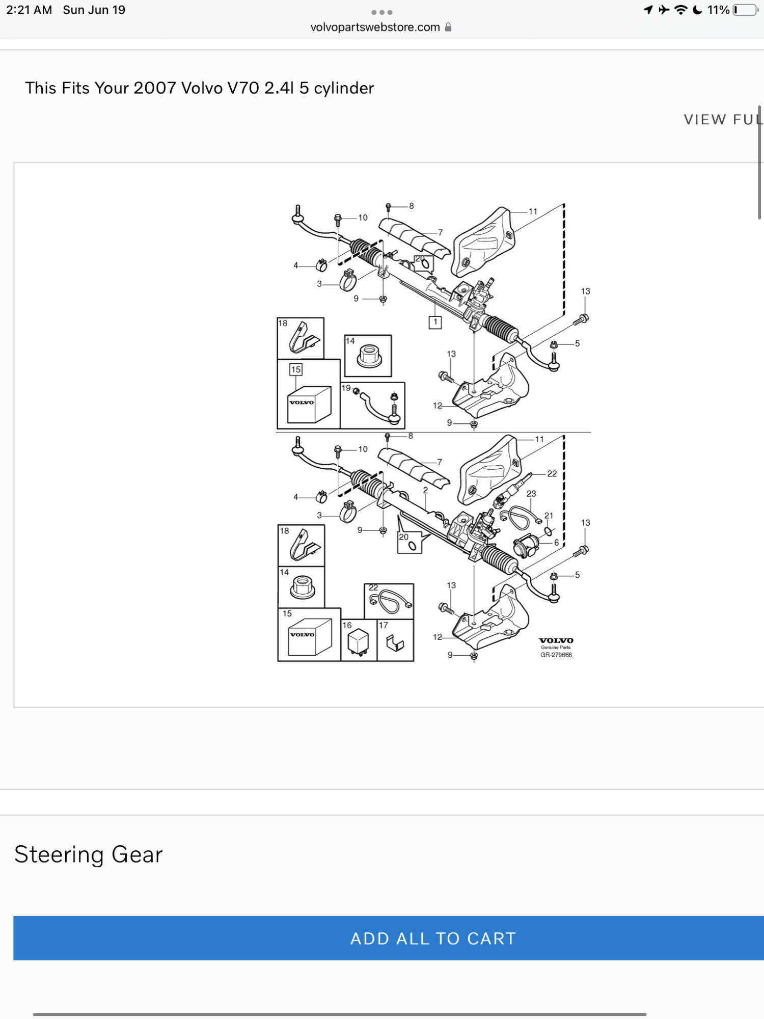

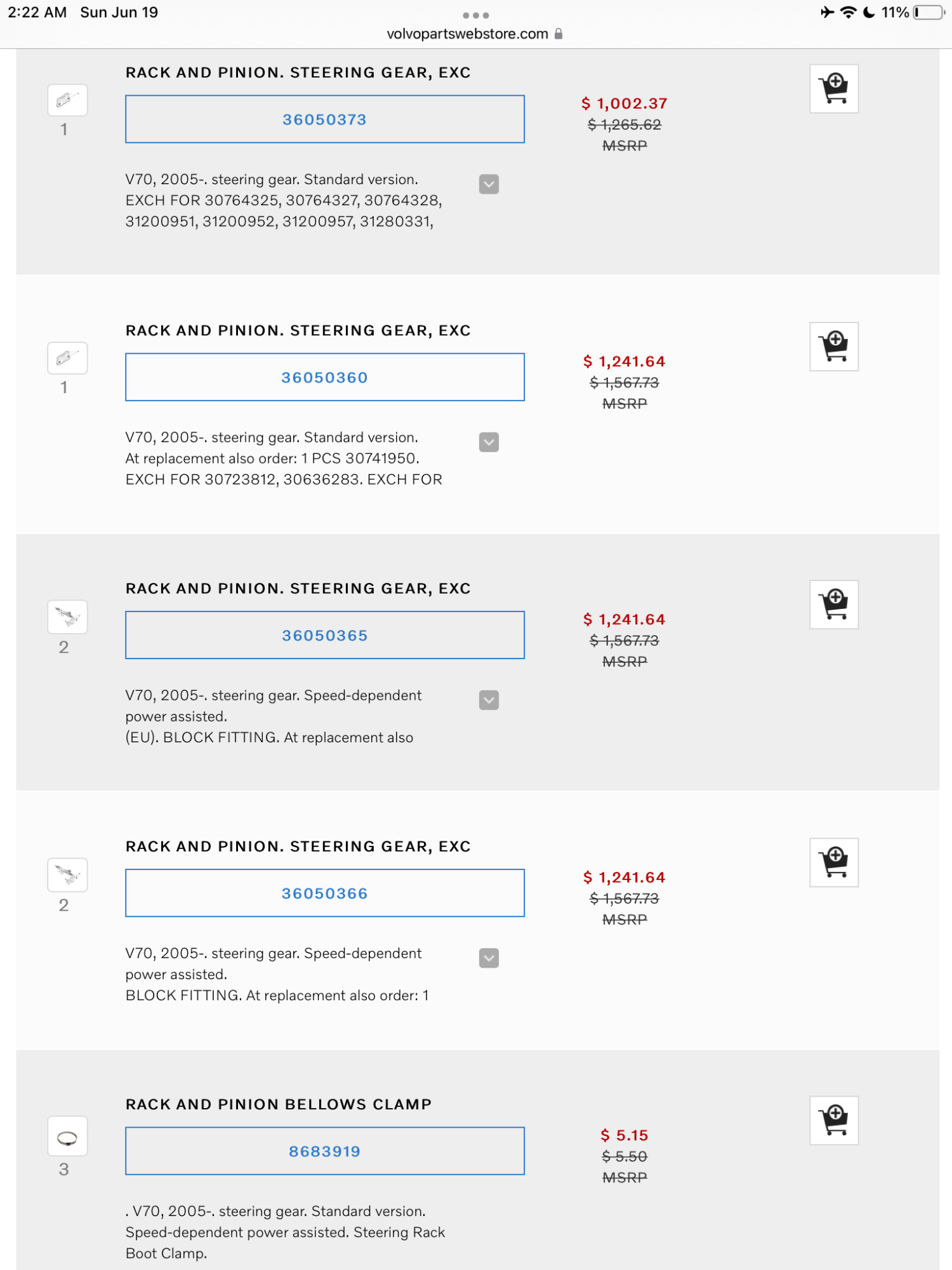

If i go cruising junk yards for a steering rack,…what other models and years would cross over to my 2007 V70 2.4L as far as steering racks go?
Posts: 36137
Joined: 17 Feb 2013, 17:54
Has thanked: 1609 times
Been thanked: 4063 times
SteveV70 wrote: 18 Jun 2022, 14:45 So this is my first foray into the Volvo world.
I know there’s some cross over with parts on other models.
Welcome, Steve
The online Volvo parts webstore lets you punch in your VIN, then pick parts. On each part description is a fitment chart which tells you what other models it fits. I use that to guide me for compatibility.
Here’s link to the store, andacouple of screen grabs to give you the idea
https://www.volvopartswebstore.com/prod ... 50373.html
