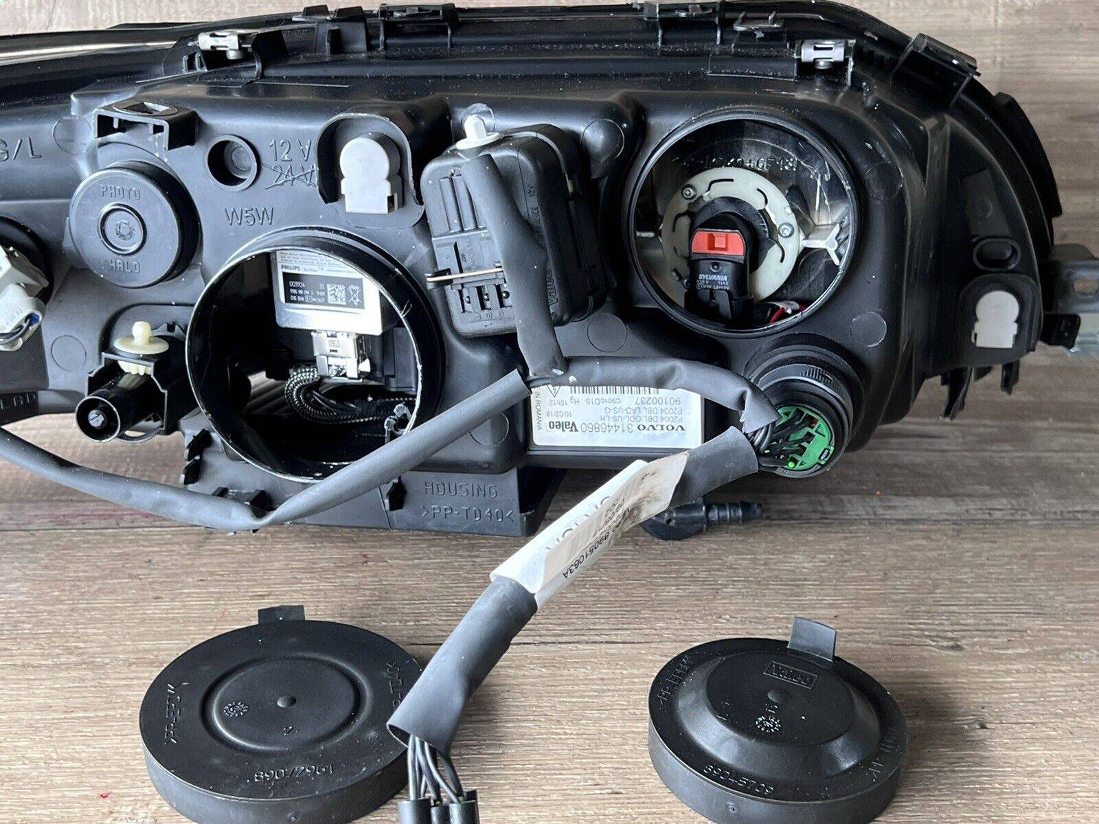

Hi guys,
I have the D2R bulb type...how do you remove it?
Correction, my bulb is D1S for 2007 S60.
I already disconnected the connector, but the bulb holder (which has no metal clips) would not come out like they said on YouTube videos!
What is the magic in removing the bulb holder?
I took a random photo from the internet to show you what I have in the car now:

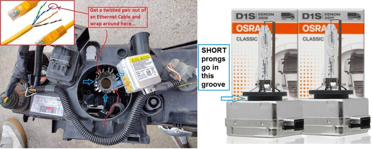

The D1S bulb was installed in July 2024 is good but somehow it is darker than usual.
Then found the problem, it came loose!
The D1S bulb was installed recently...if you ever dealt with it, you will know...it is held (from factory) with metal prong and some hard crazy glue.
When replaced, the prongs alone are not enough to hold it in place so the bulb came loose!
Anyway, I used the thin wires from Cat 5E Ethernet cables I have lying around. Used one twisted pair of wires, on each side: wrap around the prongs (find a place that it would not come loose, you will see some prongs with a 90-degree angle, just use common sense). Inserted the bulb, join the 2 ends of the twisted pair of wires together and gently twist them to hold the bulb in place. See photo.
All is good now.
PS: why can't they make bulb changing a 5-minute event lol?
Seriously, the 2005 XC90 HL bulb change is 5 minutes!

Alright,
O.P. here and an update for those with Xenon D1S bulb...
- Ignore my comments above re glue found in the RH side. As it turns out, there is no
glue at factory. The P.O. replaced the RH bulb but the SHORT prongs were bent outwards
to ease the installation. What happened was: the bulb could not stay in place, so they
used glue to hold it in.
- Now I learned from the opposite LH bulb because it was burned today. I removed the HL
assembly from the car (loosen bumper on left side, no need for complete bumper removal).
It took quite a bit of force to remove the LH bulb.
- As it turned out, the D1S bulb was designed with a circular groove (see BLUE arrows).
The SHORT prongs are supposed to fit inside the circular groove. Easier said than done:
I could not push the bulb in, so I bent the SHORT prongs a bit and the bulb went in fine.
- However, I still used the ethernet cable trick mentioned above just to secure the bulb
better bc I don't want to play with this again. Who would think replacing a HL bulb is such
a PITA job? Halogen bulb: 5 minutes. This particular 2007 S60 Xenon setup: one hour!
- NOTE: the connector part of the bulb must be at 6:00 o'clock position.
- I put together the photo so you can see...
