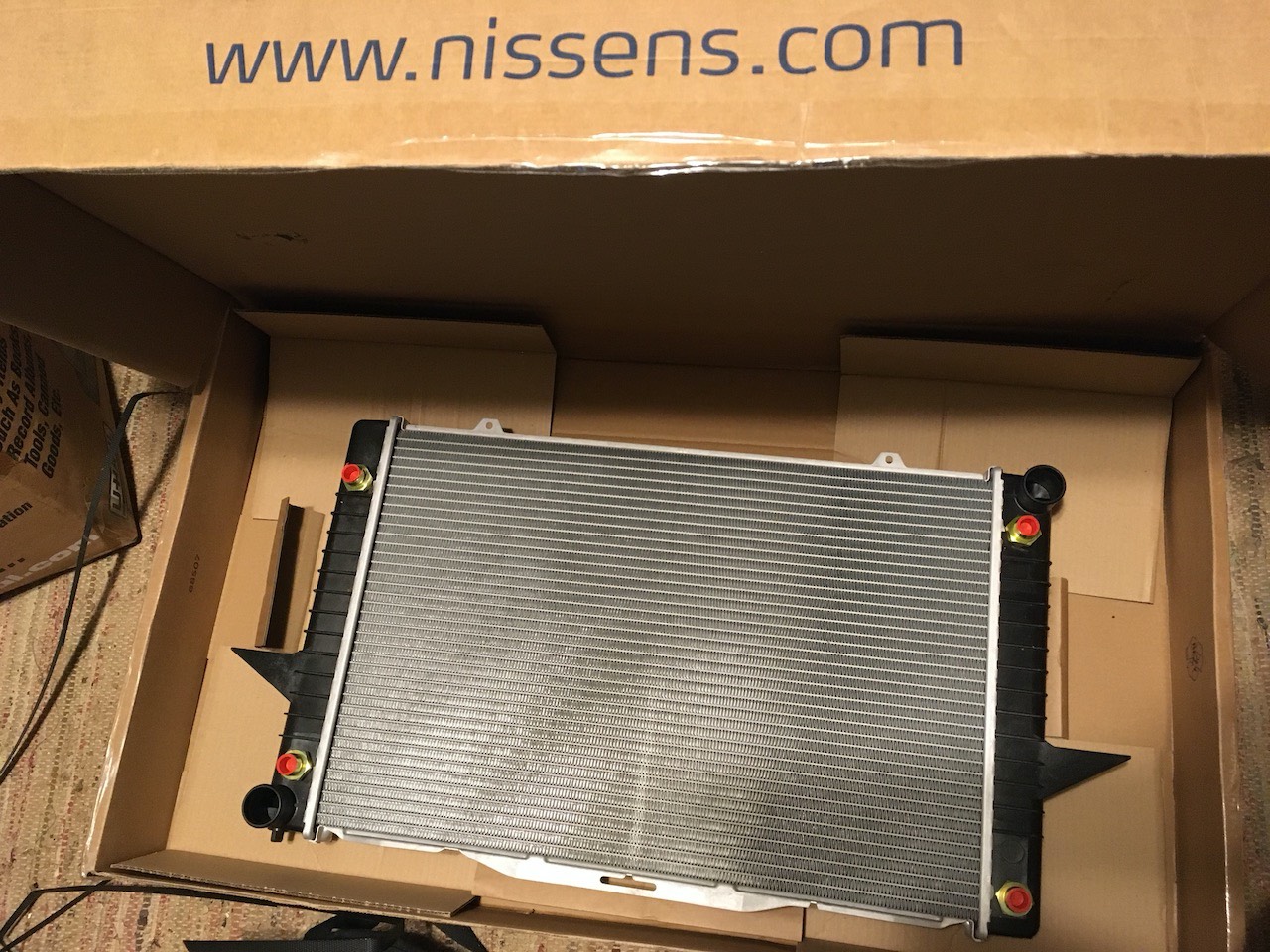

The new Nissens (p/n 8603770) radiator from FCP arrived... they are quick to ship and deliver. Waiting on Tasca to source and ship some of the other parts I know I'll need from the last time I did this repair... clips, ductwork, hoses, bushings.
- Posts: 36138
- Been thanked: 4064 times
Make sure you move the rubber bushings over ftom old to new. They usually don’t ship with them. Can be fabbed if missing

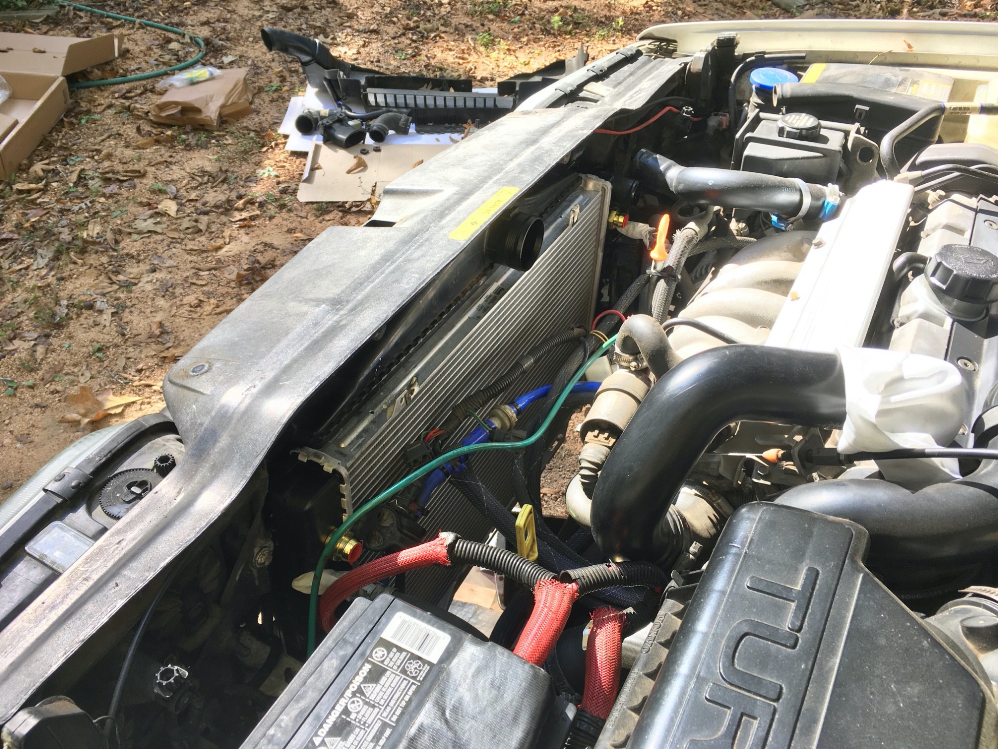

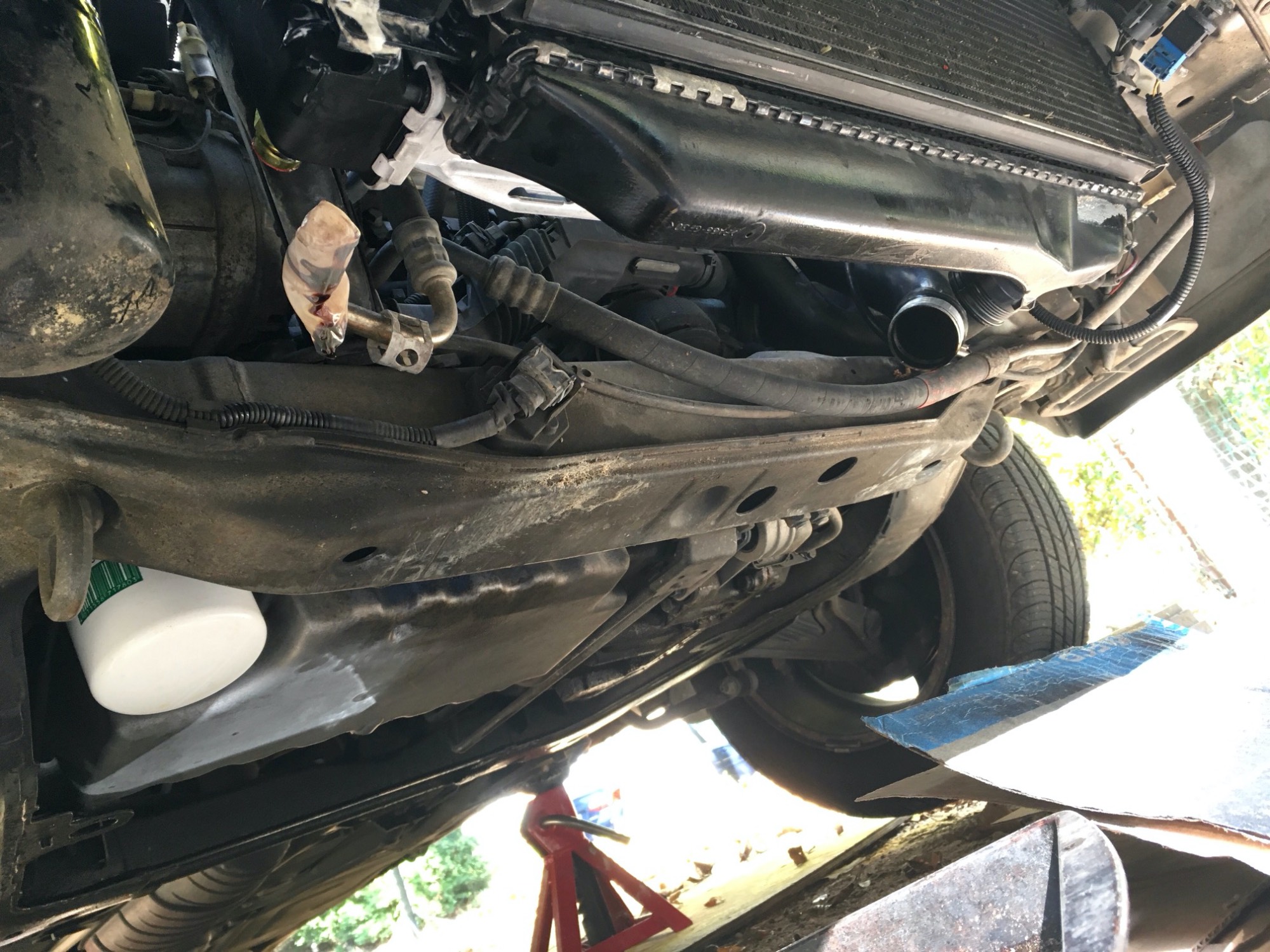

Installed the new Nissens radiator. Fit was excellent. The metal oil line fittings were tight as received and did not need tightening.
Installation went smoothly, followed the step-by-step I put together a few years ago viewtopic.php?f=1&t=55629
Luckily I had a set of the rubber bushings and metal collars that I bought from Waltrip Volvo about 9 years ago, still in the blue bags.
No leaks so far, still need to take the car for a run to get the coolant system to do its traditional 1 liter burp/gulp of coolant so I can top it up.

It is so frustrating seeing the underside of an old Volvo with no rust or rusty fixings!
Looks good and always helps when someone took the time to do a how to for us all! Thanks for that.
