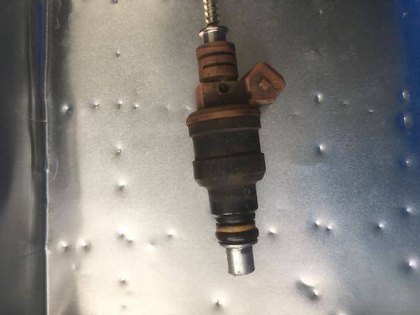

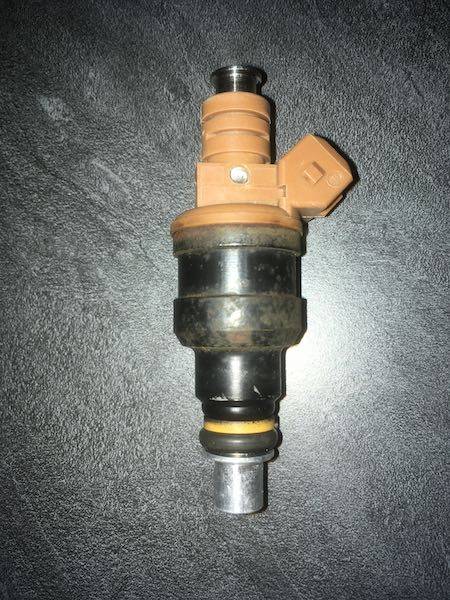

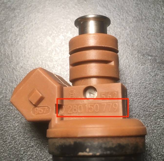

Today, it's injectors party. I've cleaned the outside. It's not what will make them getting better. But it's done.I will test them later.
The reference of mine is :
Injector reference.jpg (59.42 KiB) Viewed 357 times

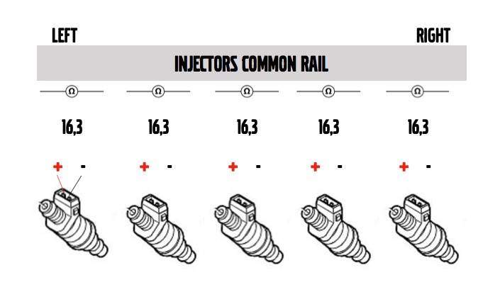

Bosch gives me 15,9 ohms (Haynes), my ohmmeter gives me the following values, all the same :
Capture d’écran 2022-11-05 à 20.15.53.jpg (29.02 KiB) Viewed 357 times

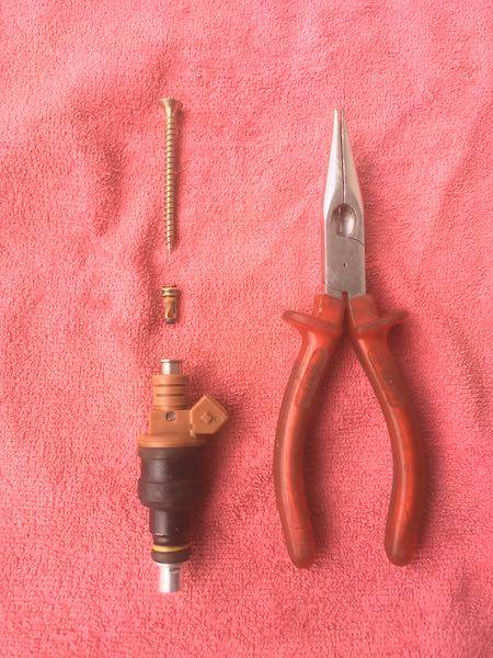

Get the inside filter out
Seals episode
Injectors seals kit (5a - 5b)
the protective cap is crimped and i don't know how to get it away. Have to simply pull the cap out ? When it will be out, the kit gives new yellow flat seal

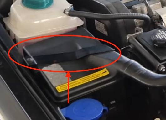

Does this part tells something to someone ?
Capture d’écran 2022-11-06 à 21.19.50.jpg (25.4 KiB) Viewed 336 times

Post by Goupil »
The only point of this part is to keep people from getting to the ECU (warranty reason, thieves, insurance...)

Post by scot850 »
Wow, never seen that bar on the ECU/TCU cover. Maybe it is a EU thing?

Post by manovlov »
manovlov wrote: 06 Nov 2022, 13:05 Does this part tells something to someone ?
Actually, not sure if it's an OEM part...

Post by Goupil »
scot850 wrote: 06 Nov 2022, 15:58 Wow, never seen that bar on the ECU/TCU cover. Maybe it is a EU thing?
Could be, I've seen it on a few cars here. Mine had already been messed with so it didnt have it.
I've parted out a 940 where you also had to destroy the bracket security rivets to unplug it from the car.

Post by scot850 »
Maybe it was an emissions control to stop the ECU's being removed and modified? Strange though.

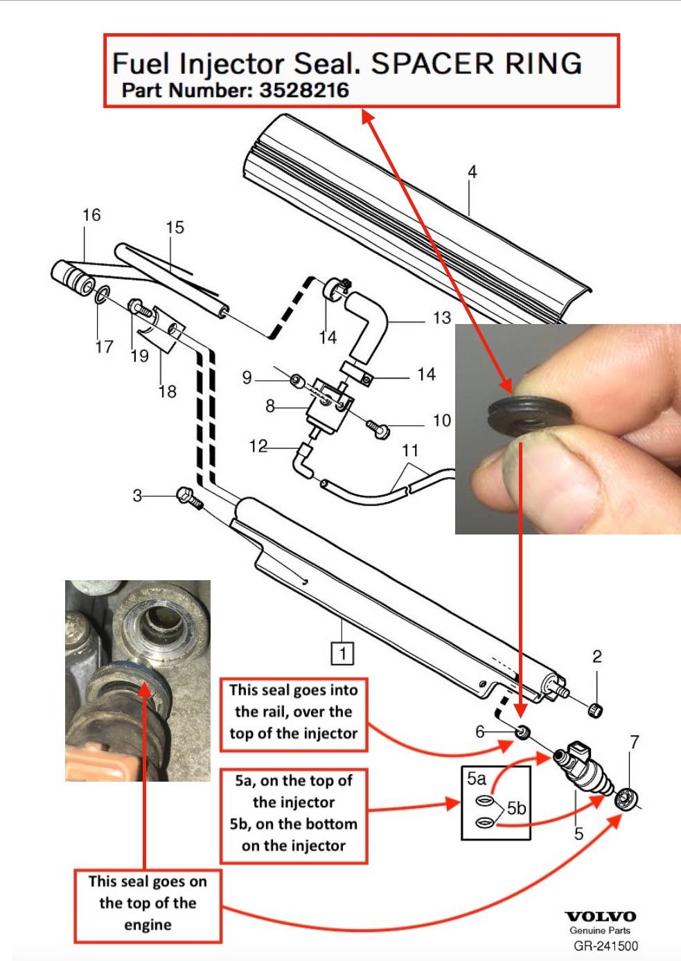

The gaskets that go inside the fuel rail are available from Volvo for $6 each. Order now!

Post by manovlov »
Considering the shape of the thing, I think it's more of a DIY, the fold of the hoop doesn't really match the fold of the lid.
