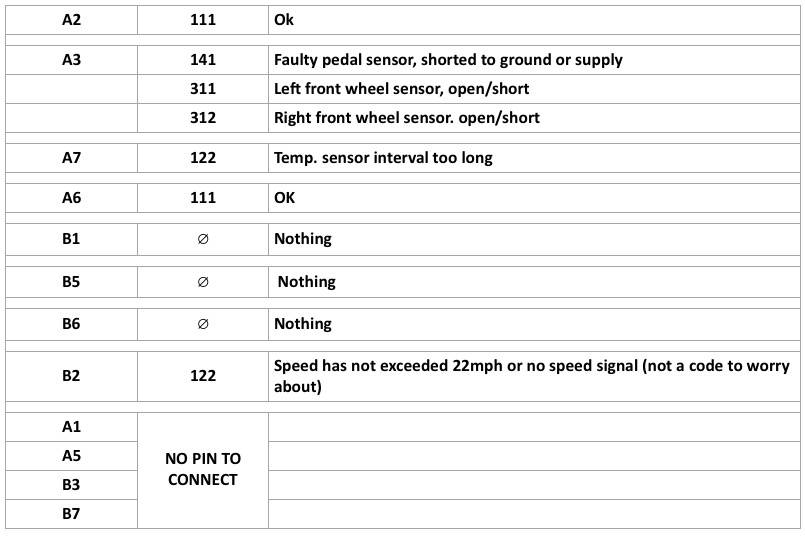

Codes read today :
For codes A3 - 311/312, I've cleaned up brakes recently. I will replace sensors by new ones soon.

I've ordered the sensor and will replace this week.

I can't recall if the sensors are the ones that have the wire clipped to them on a connector or are solid wires. If they are the solid wires, then they can break internally. If it is the ones with the clips, again make sure they are clean at the contacts and pushed fully home.
Also check the cog wheels/reluctor rings on the end of the axle in the hub where the sensors read for cracks/rust build up/ dirt that may cause issues for the sensors reading the rings.

I would look into the 141 and 122 for your engine issues. 122 may be the engine coolant sensor (ECT) at the thermostat, I am not sure on what 141 is triggered by as you car is not fly by wire. I'll have to do some research!
You may want to reset the codes and see what comes back incase they are old codes that were not cleared and see if they come back.

scot850 wrote: 10 Dec 2022, 10:17 I would look into the 141 and 122 for your engine issues. 122 may be the engine coolant sensor (ECT) at the thermostat, I am not sure on what 141 is triggered by as you car is not fly by wire. I'll have to do some research!
