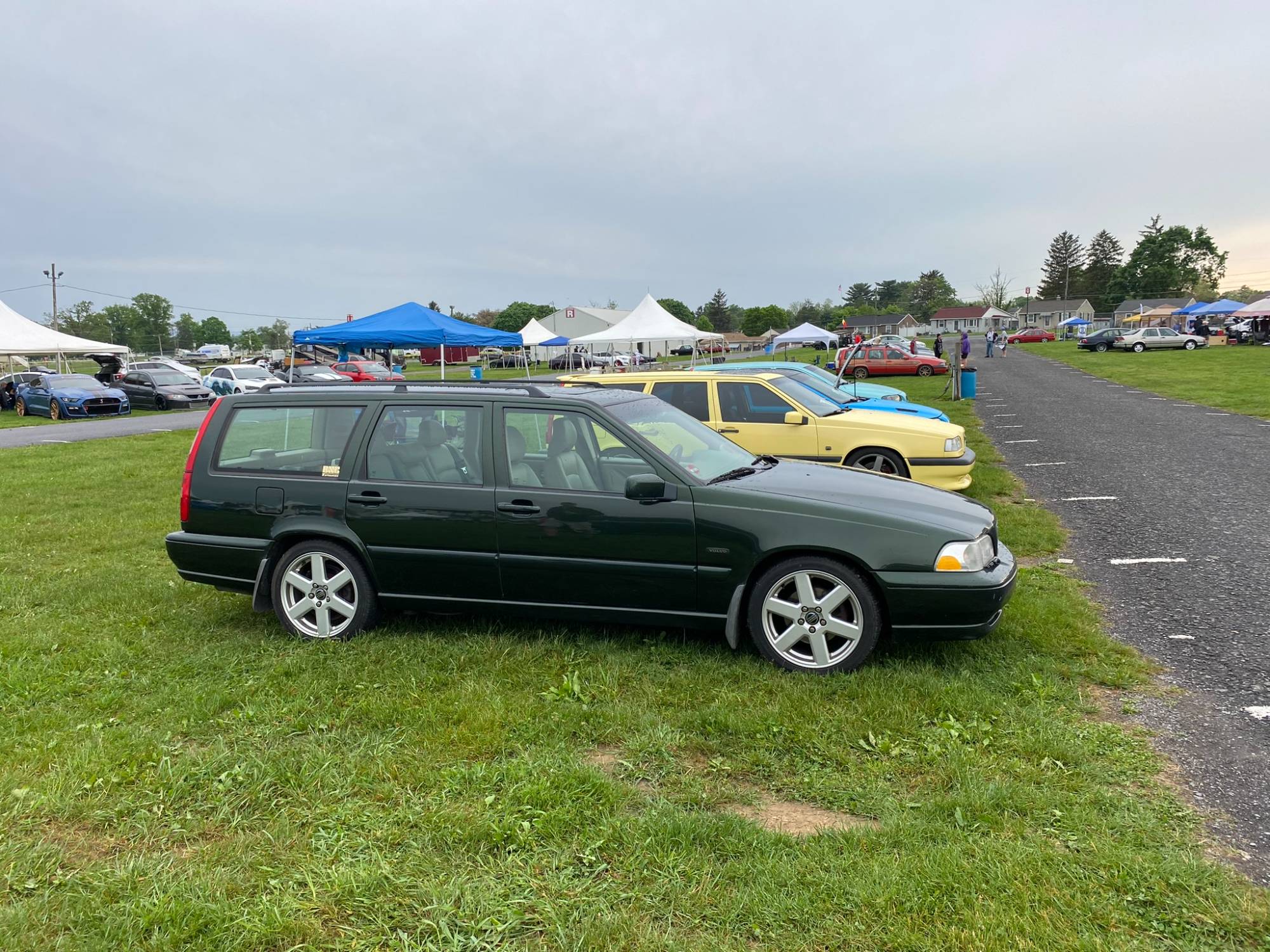

Enjoy the car! Here's a picture of mine
1998 V70 AWD - Emerald Green/Tan - M56/Delta link swap, VAST tuned, lots of fun

Tropic Green is rare and attractive but I'll always love Emerald Green the most. Fits right in next to the GUL and Sonics.
FireFox31
Posts: 35272
Has thanked: 1497 times
Been thanked: 3810 times
All th Volvo colours are gorgeous but the Emerald Green and Nautic Blue define class
