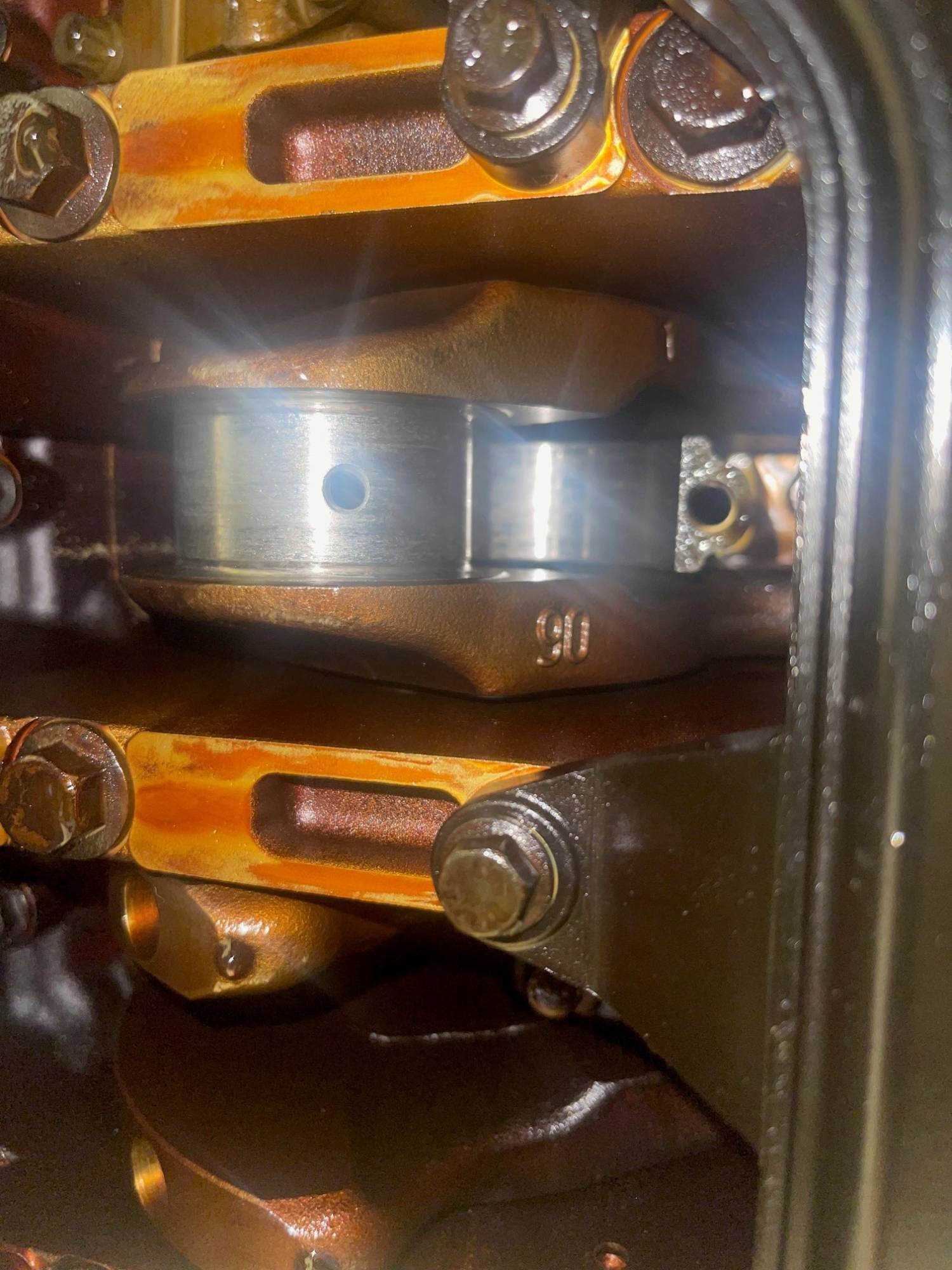

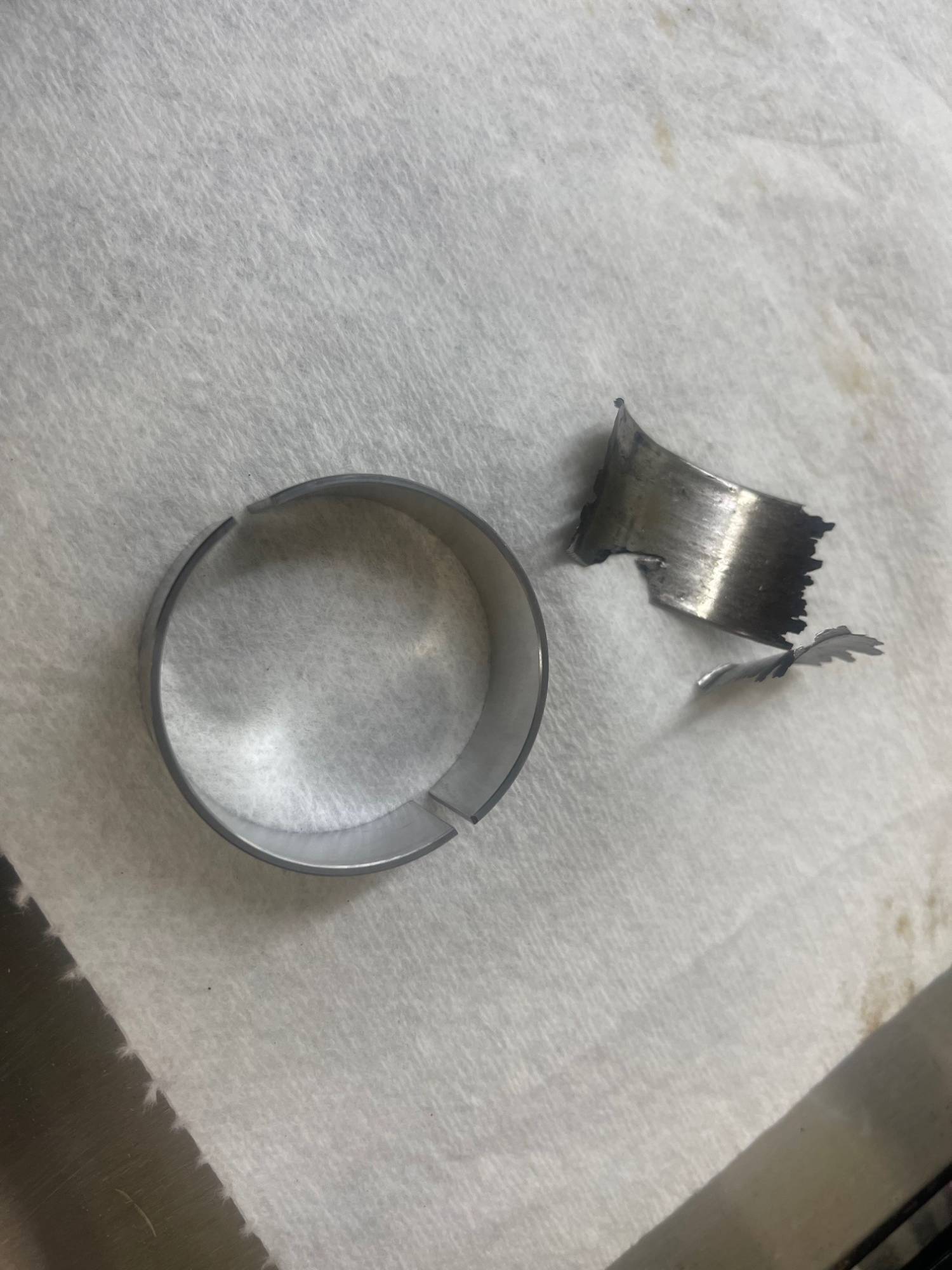

Back to the engine...I dropped the pan and that #2 bearing was beyond shot. Only two thin pieces remained:
Old bearing remnants vs new bearing
I didn't get a picture of the pan but it was in pretty decent condition. Will just need a good cleaning. The journals don't feel that bad but I'm planning to polish them up:

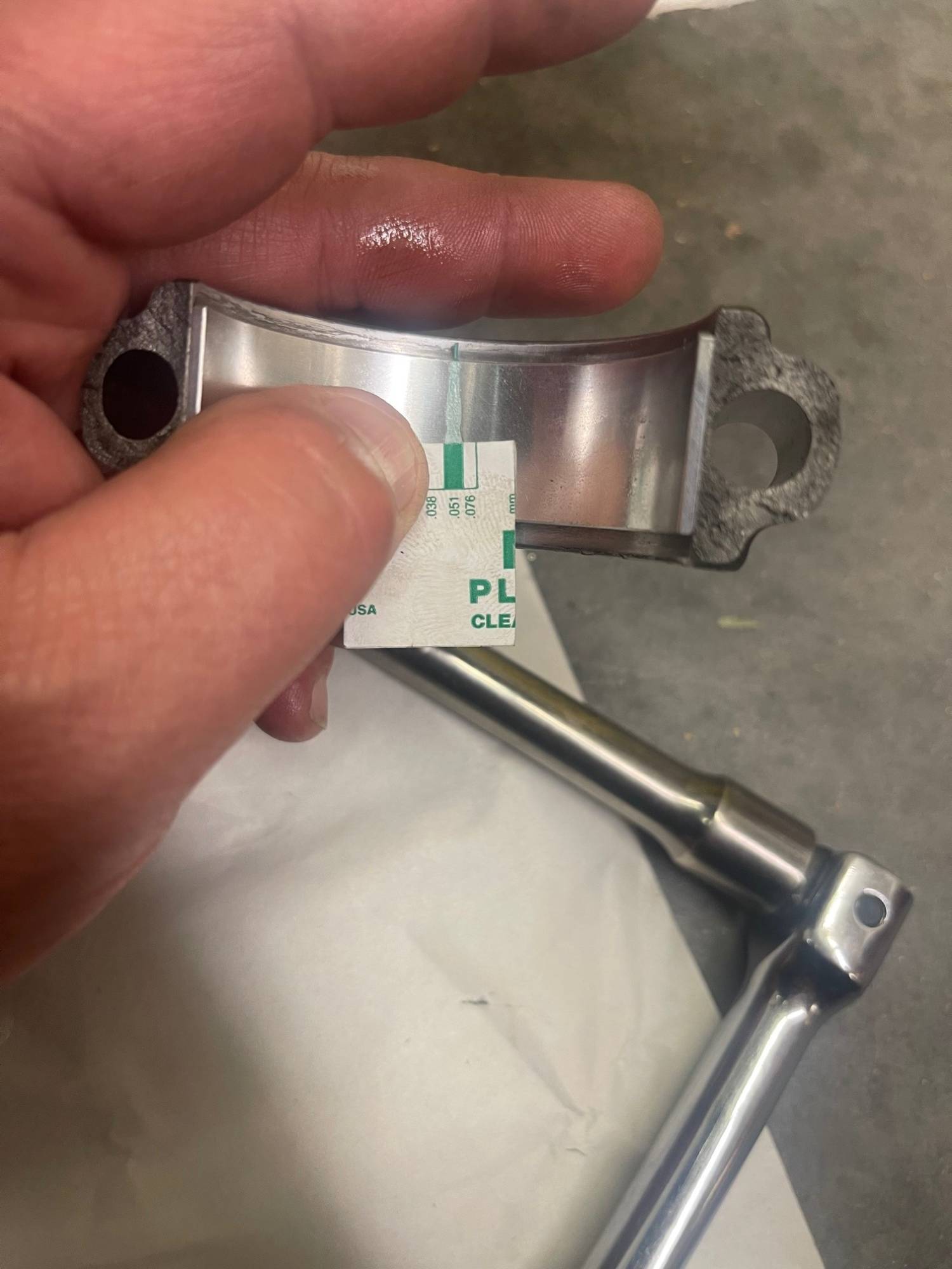

When I ordered the bearings, I didn't see the size options and of course I ended up ordering the smaller ones. I didn't realize it until I did a test fit last night with plastigage. I could tell there was a tiny bit of play in it before I pulled the cap to check the plastigage. The clearance is definitely off:
I'm going to go ahead and polish the journal and find a micrometer to double check the size before ordering the right bearings. Hopefully I can get that done and ordered within the next week. I did pull the cap off of one of the others just to see how it looked and it appeared to be fine. I'll probably go ahead and order new bolts for them all and pull each one to confirm there are no other problems or potential problems.
