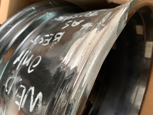

Is this rim repairable, and then safe to drive?

xHeart wrote: 22 Apr 2024, 14:19 Is this rim repairable, and then safe to drive?
Something bad has happened to that wheel. The bead will hold air for now, but note the crack is traveling down from the lip into the bead.
Is this aluminum? There are wheel shops that can restore alum wheels to new. No idea the cost compared to finding a good used one.

BlackBart wrote: 22 Apr 2024, 22:01 Something bad has happened to that wheel. The bead will hold air for now, but note the crack is traveling down from the lip into the bead.
Found a replacement over Ebay; but then got the crack welded. The weld specialist says, aluminum wheel repairs and lasts forever. It won't crack at the same spot again.

xHeart wrote: 15 May 2024, 08:48
Did you go to a wheel specialist or welder?

MoVolvos wrote: 15 May 2024, 09:07

xHeart wrote: 15 May 2024, 09:32
Chicago Wheel Service in Elk Grove https://www.chicagowheelandtire.com
Did you require some straightening or just welding? If you don't mind sharing the cost so we all can get an idea in case we need to find a local shop. Thanks.

MoVolvos wrote: 15 May 2024, 09:41
The quote was $140, it included removing wheel from the car (this-that-this-that) and then putting it back on after the repair. I walked in with just the rim and got it back the next day for less.
