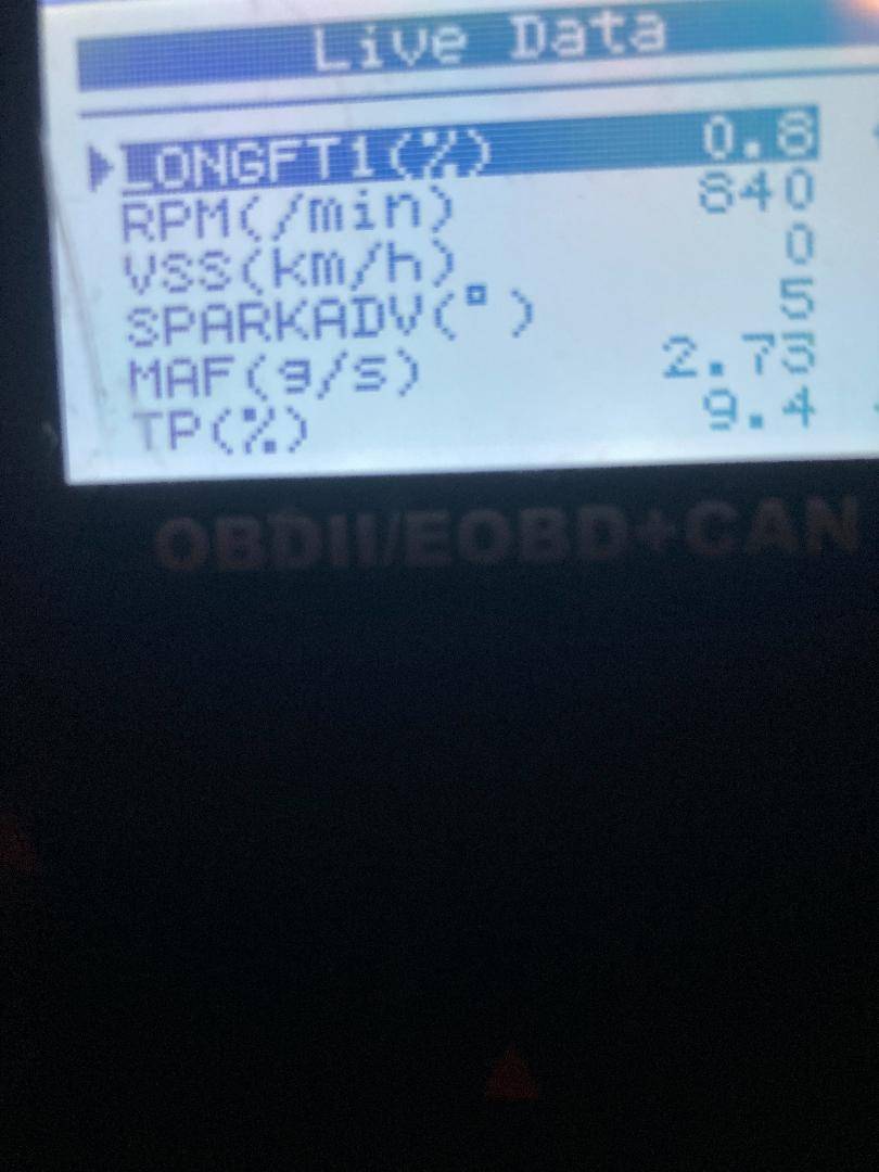

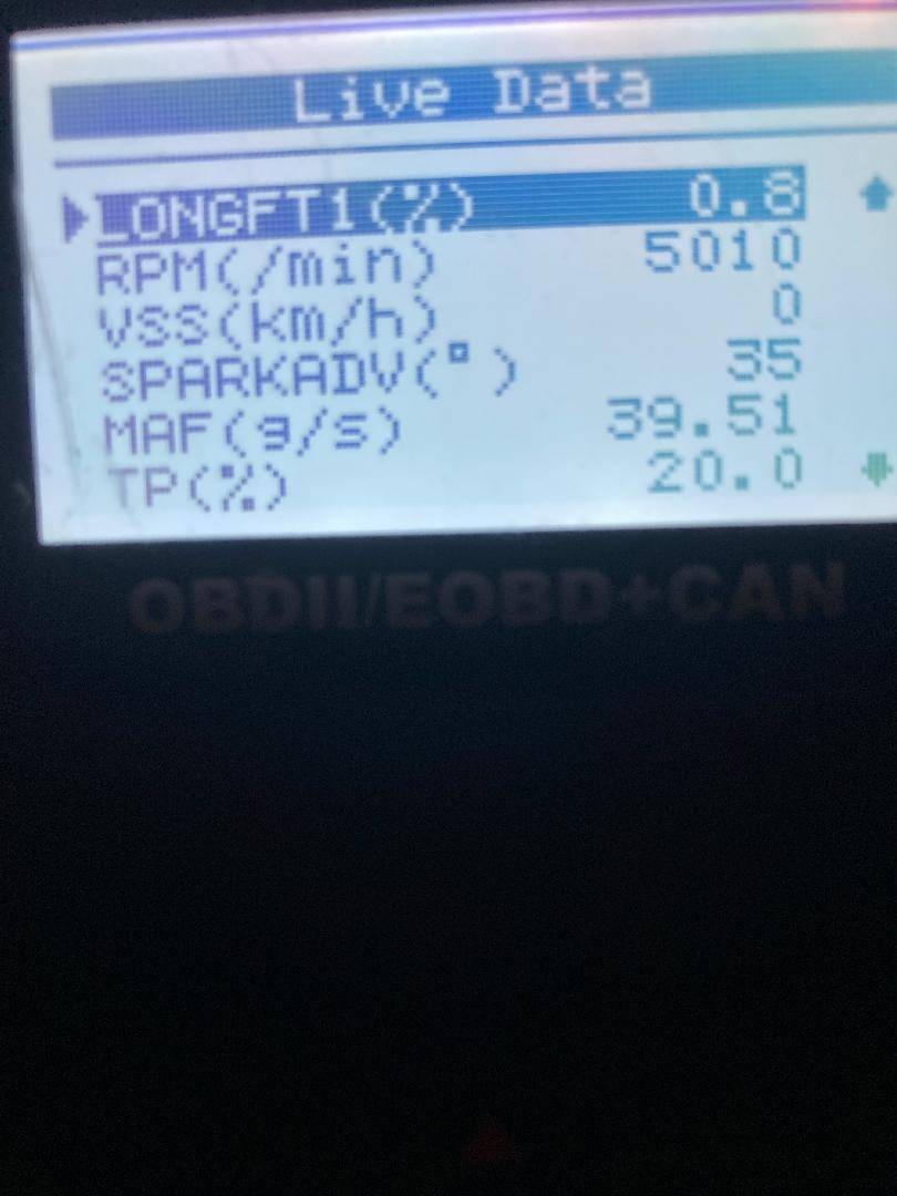

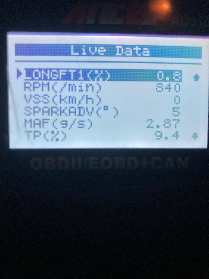

Hello again,
Answer is on page 2. No mats in the way, factory Volvo floor mats, the pedal goes all the way to the floor. I could have pushed past 5k a little but didn't think is necessary. 0.8 id LT fuel trim. No wispy white smoke at idle, just when pulling away.

The throttle position sensor probably needs to be changed based on your ohmic readings. I am unsure if that would cause downstream performance issues. Your LTFT seems to be on the money so probably not a fueling issue, spark, etc.
Time your car going from zero to 60 and post it up. Just a stopwatch or video as these cars are not exactly fast as an NA.

It has the symptoms of a clogged exhaust system. It could be any component in the exhaust system. A clogged Resonator or clogged Muffler has the same effect as a clogged Cat. Pulling a O2 sensor relives the back pressure and the symptoms go away if the clog is down stream of the O2 sensor.mghdi1120 wrote: 06 Nov 2023, 09:47 Any recommendations of what to check? I was thinking maybe to pull the O2 sensor at the cat or front ( which one?) to see if it could be a plugged CAT. I haven't replaced that in a very long time... Is that a wise move?
If you pull the front O2 sensor and the symptoms go away, it could be any of the three ( Cat, Resonator, Muffler ).
No change and the problem some place other then the exhaust system.
If you pull the back O2 sensor and the symptoms go away, it could be Resonator or Muffler but not the Cat.
In park, rev the engine to about 5K and hold it. Does the exhaust system whistle?
