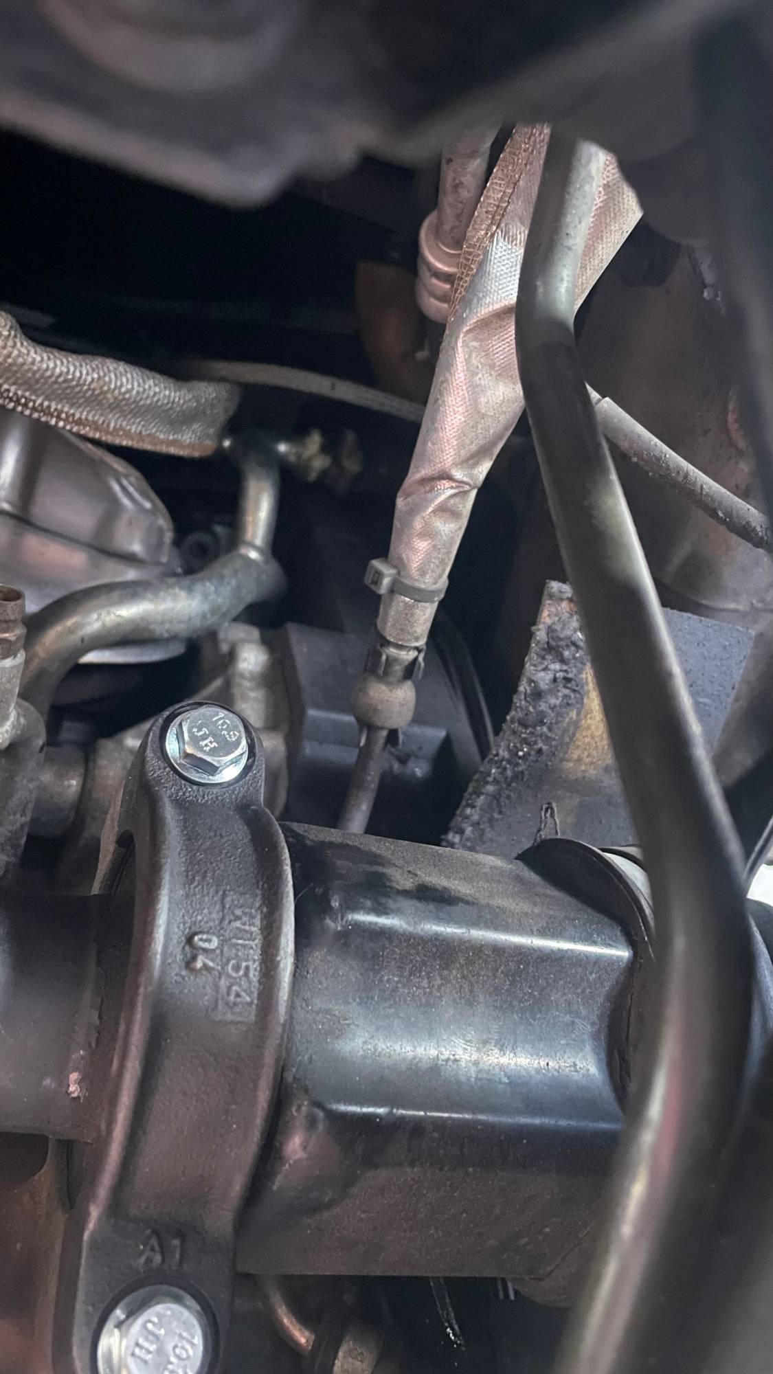

You don't need to take the wheel off. You should be able to get to it from underneath without removing anything. Be safe.

Yup, up on ramps, it was right there. No problems. About 1/4-3/8" movement forward and aft. No side play at all.
Before and after pics attached. Thanks again everyone!
M :D
bearing after.jpg (196.44 KiB) Viewed 120 times
bearing before.jpg (177.05 KiB) Viewed 120 times
