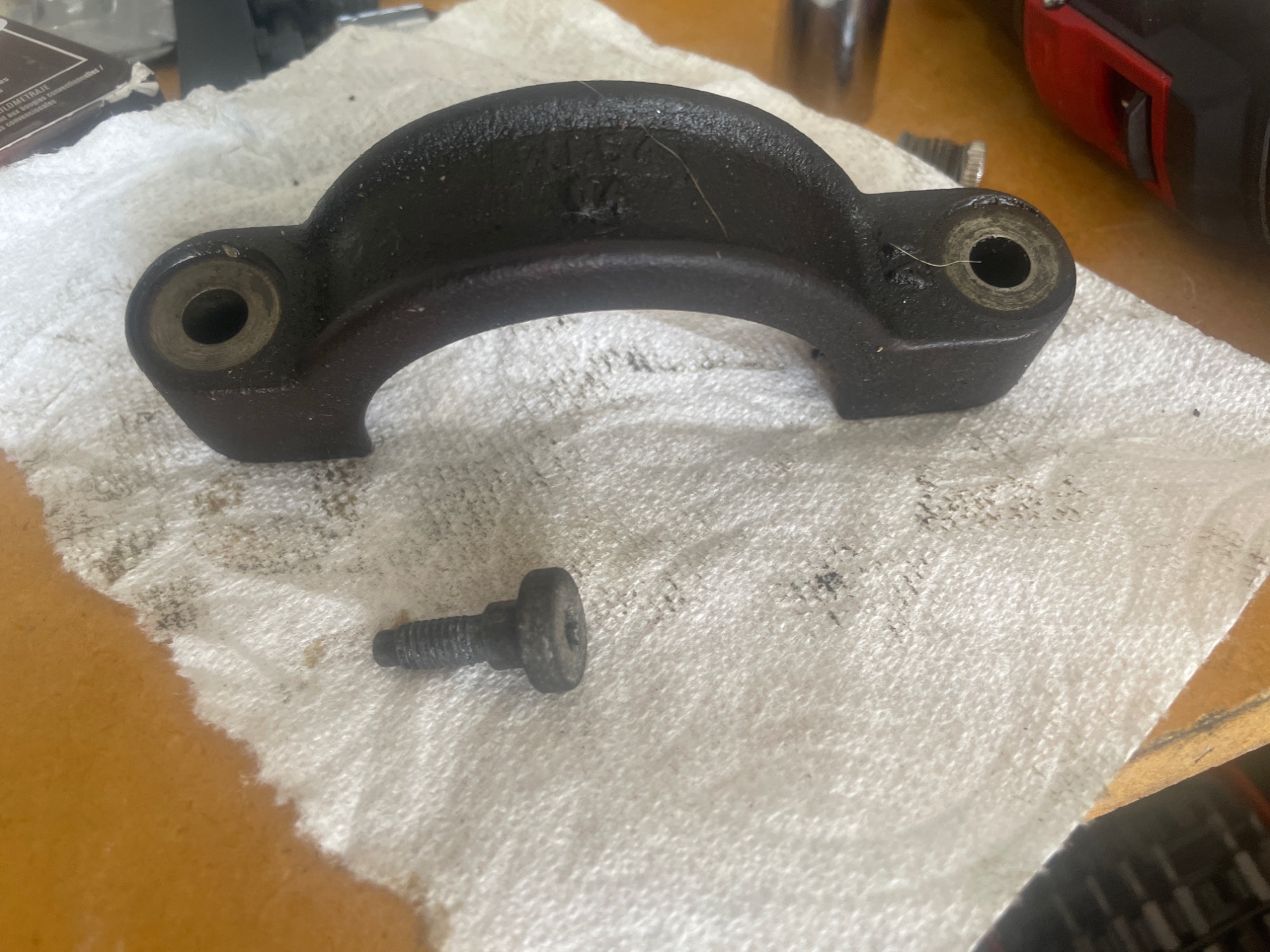

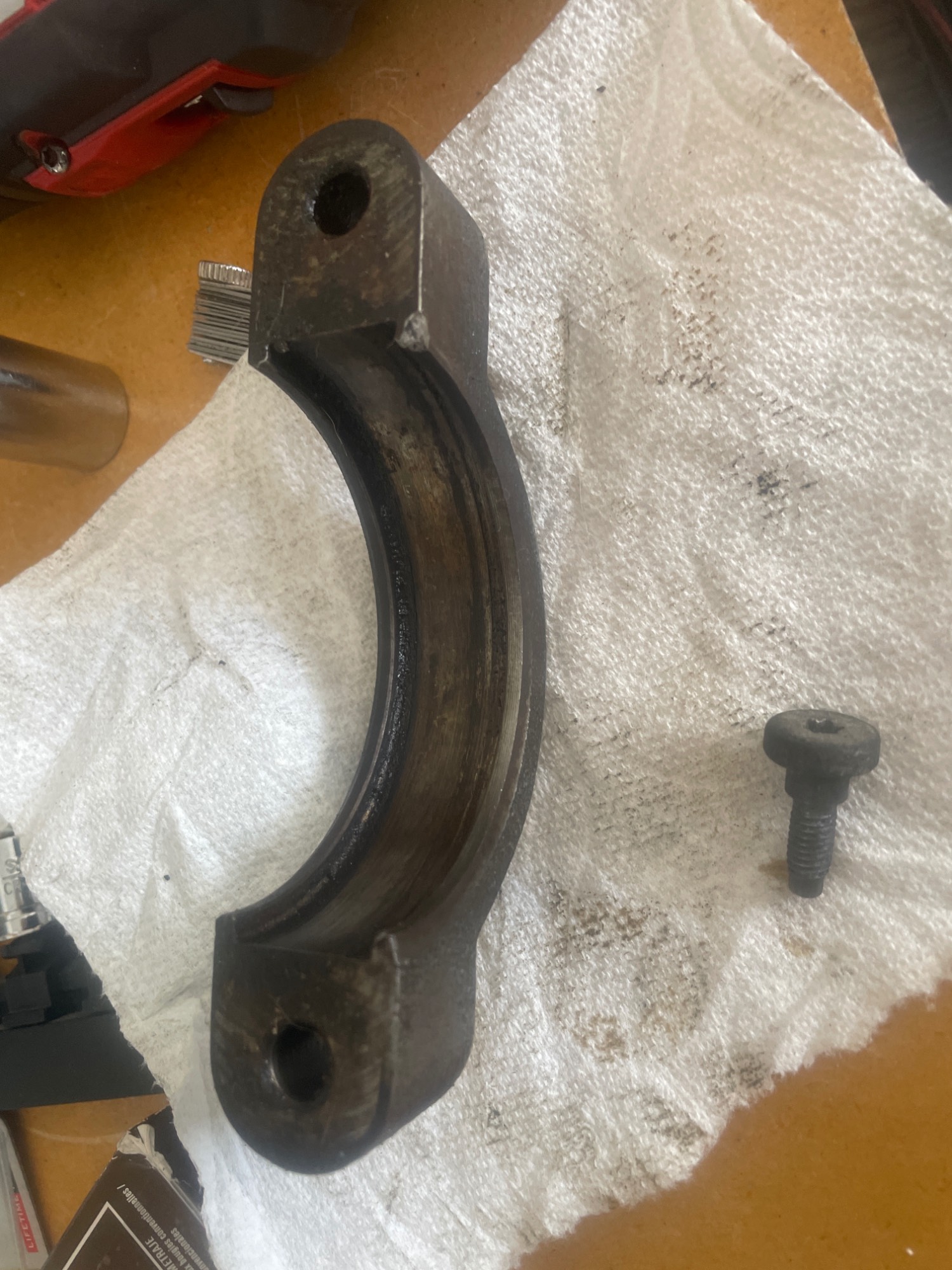

What looks like a main bearing type half round casting w bolt hole on each end
About 6 in long
Any idea what it is???[img][/img]
And where it goes???

Post by Antoine240bk »
looks like it is coming from the passenger axle shaft carrier bearing housing.

Post by markdbenz »
Ack! Yes it does look like ones in online diagrams! Thank you very much. Any idea what the 2 bolts are??

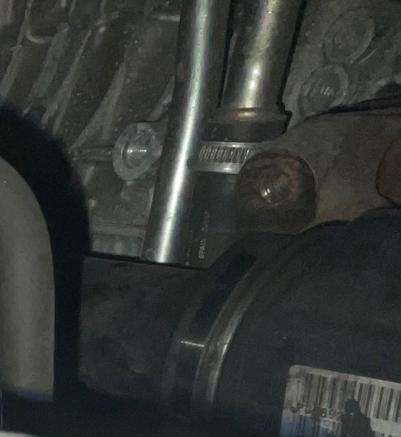

Any ideas how to get to it w/ wrench etc?[attachment=0]IMG_7086.jpeg[/attachment]
Seems to be a flange screw M8 x 35mm, pn: 988983

I guess it goes without saying that the screw does not go with the axle bearing. :)
I'm assuming your two bearing bolts rattled out and are gone. They are M8x35 flange screws, Volvo part #982797. If recall they are angled such that they are pretty easy to get to with like a 6" ratchet extension. 12mm or 13mm I think.

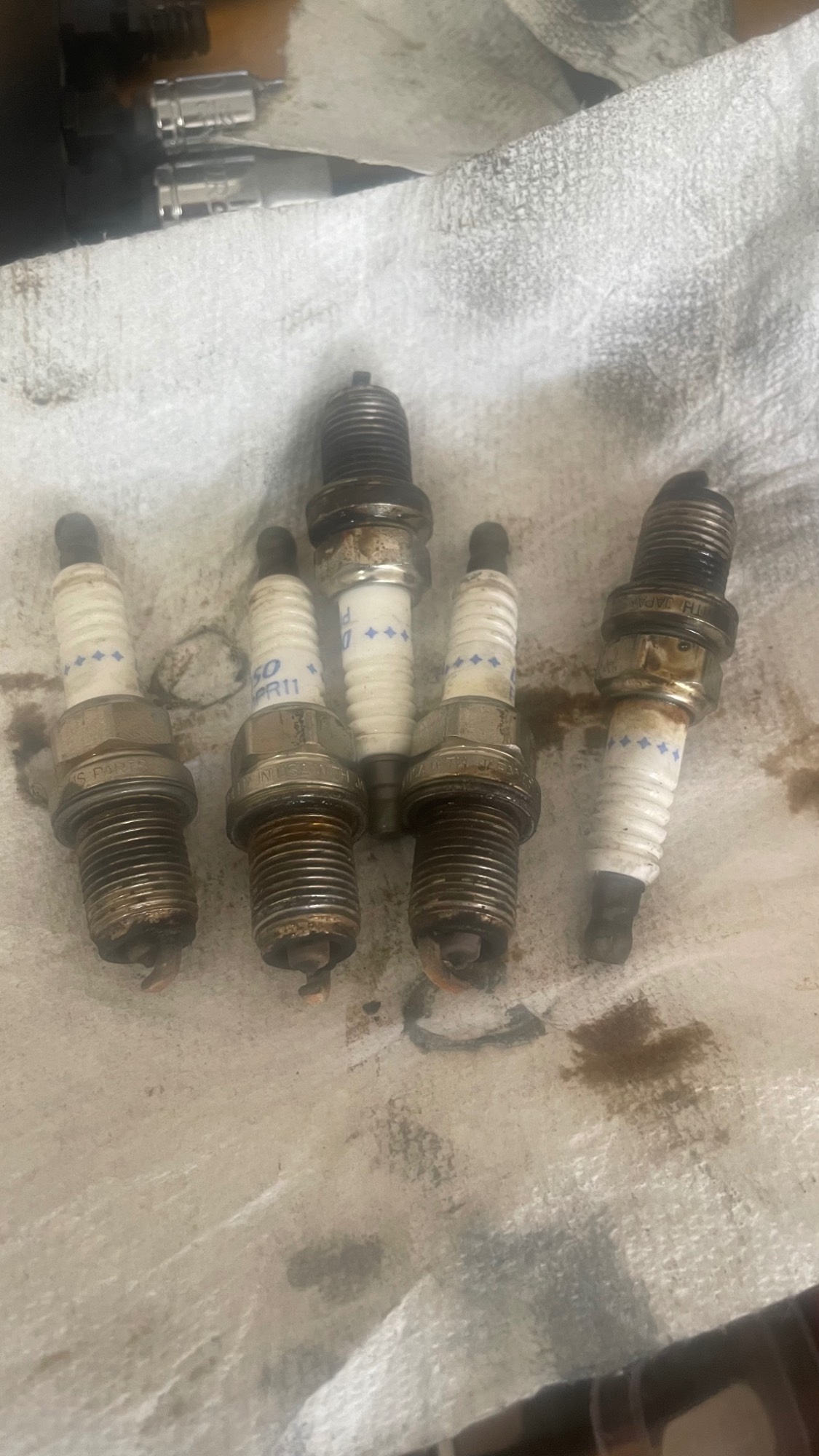

Btw plugs were pretty bad
