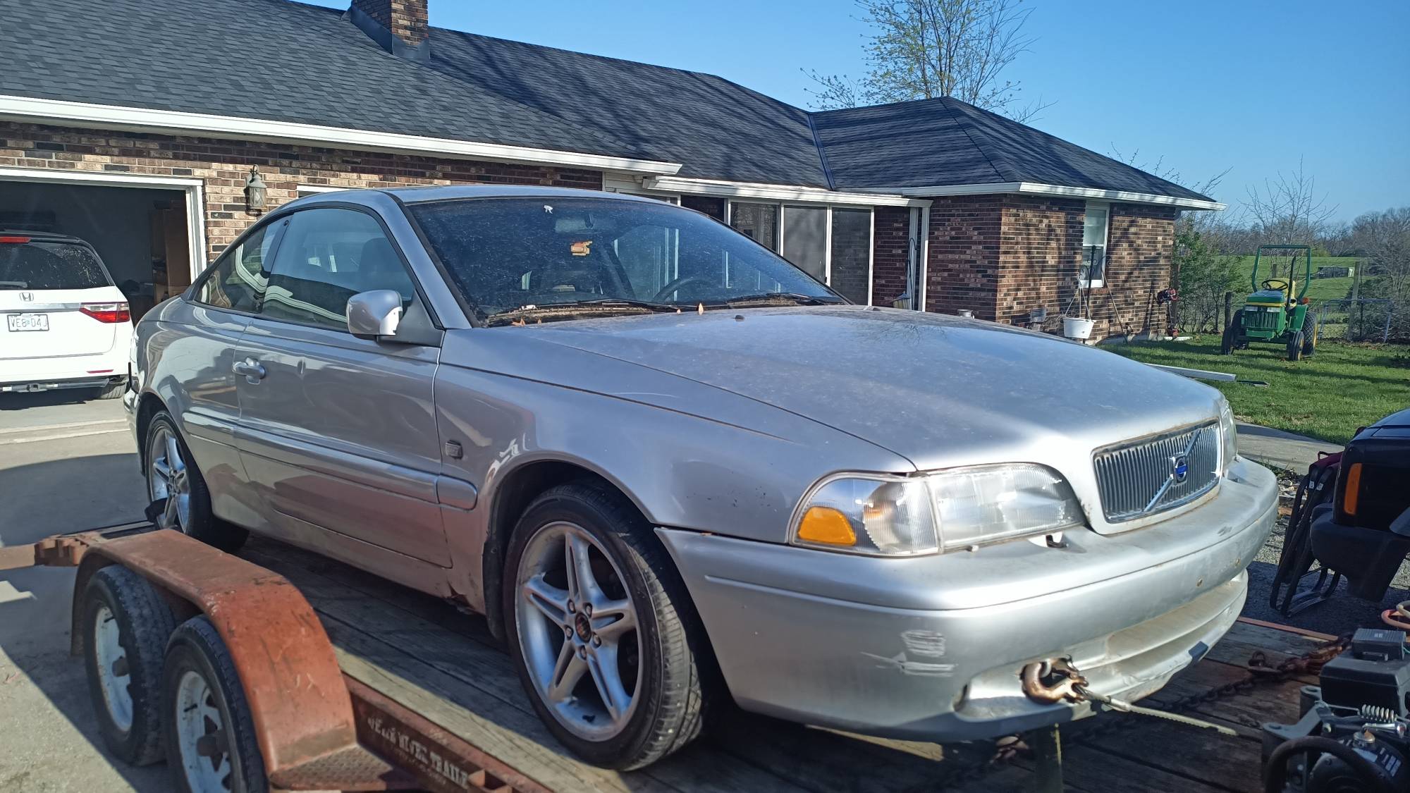

As someone that’s done vast amounts of research into manual swapping my 98 AWD, I have a couple thoughts.
That C70 does not have a transmission that will allow you to keep the AWD. You’d need to swap the trans/pedals/sifter/cables as well as the entire rear end, fuel tank, exhaust, etc and FWD swap your V70 to make it work. It’s been done, but it sounds like you want to keep AWD and that won’t get you there.
Being that you bought a hardtop, factory manual C70, I’d personally fix that car up and have fun with it. They are quite rare and very fun when tweaked properly.
To properly manual swap your 98 AWD and keep it AWD, you’re going to need either an M58 (factory 5 speed AWD manual for P80 fitment), which you’d need to import from Europe or Canada, or you need a T5 AWD M66 P1 car (05+ S40 or V50) and use that transmission/shifter/cables. Both of these have been done before and are well documented.

Fix the Coupe! I am a wagon guy all the way, but you will be in pain as many AWD parts are NLA.
And the p80 AWD system isn't known for it's deefiness anyhow, so parts you find might be worn beyond use.
