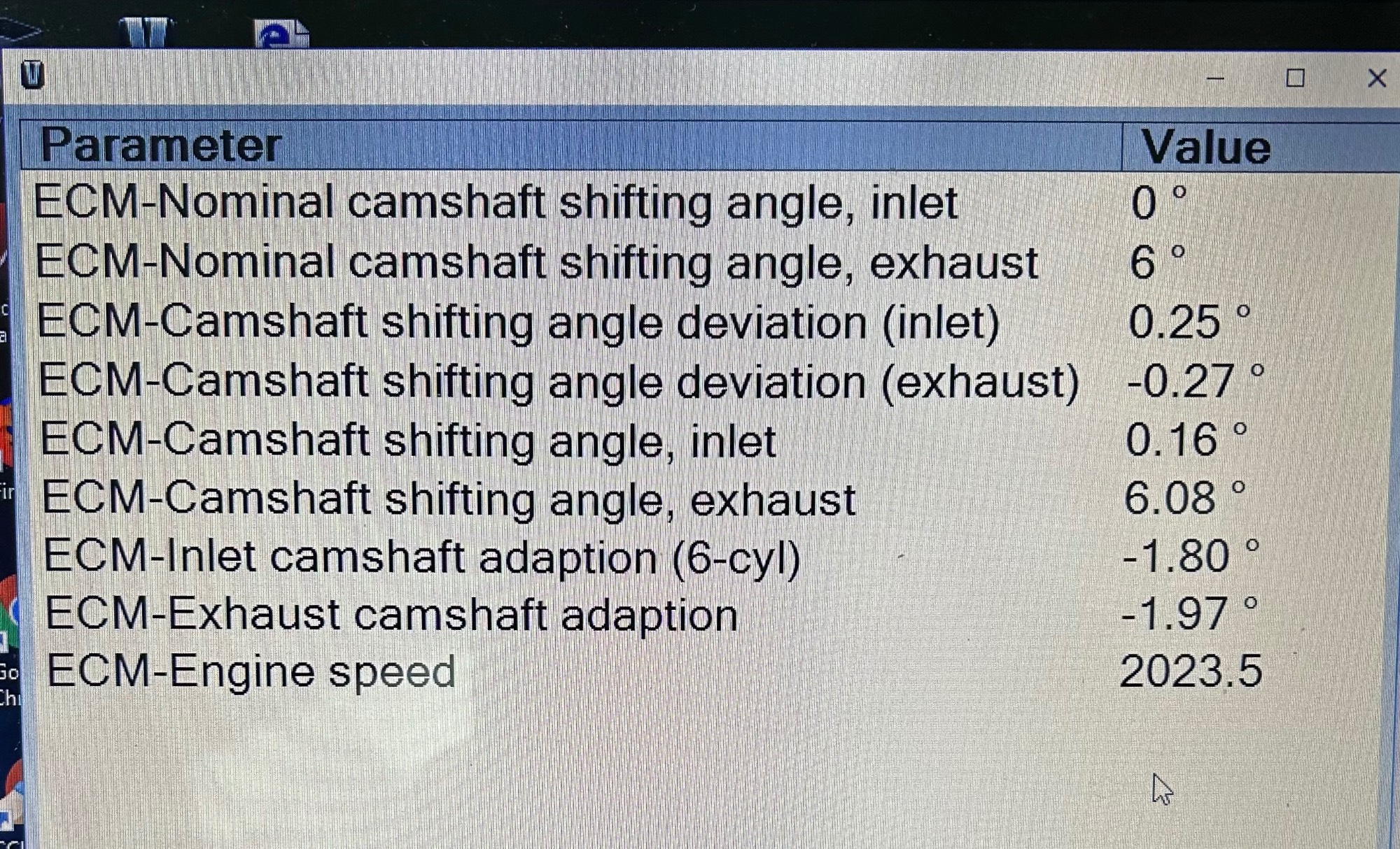

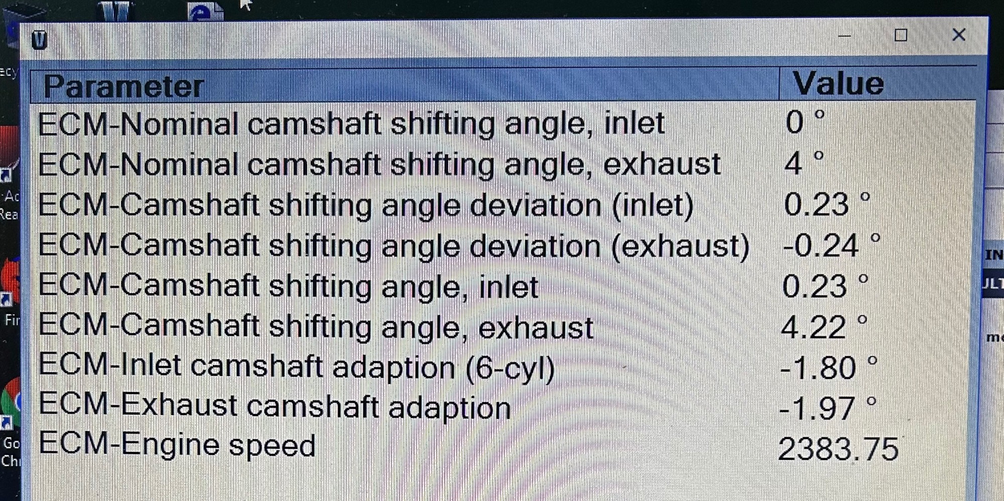

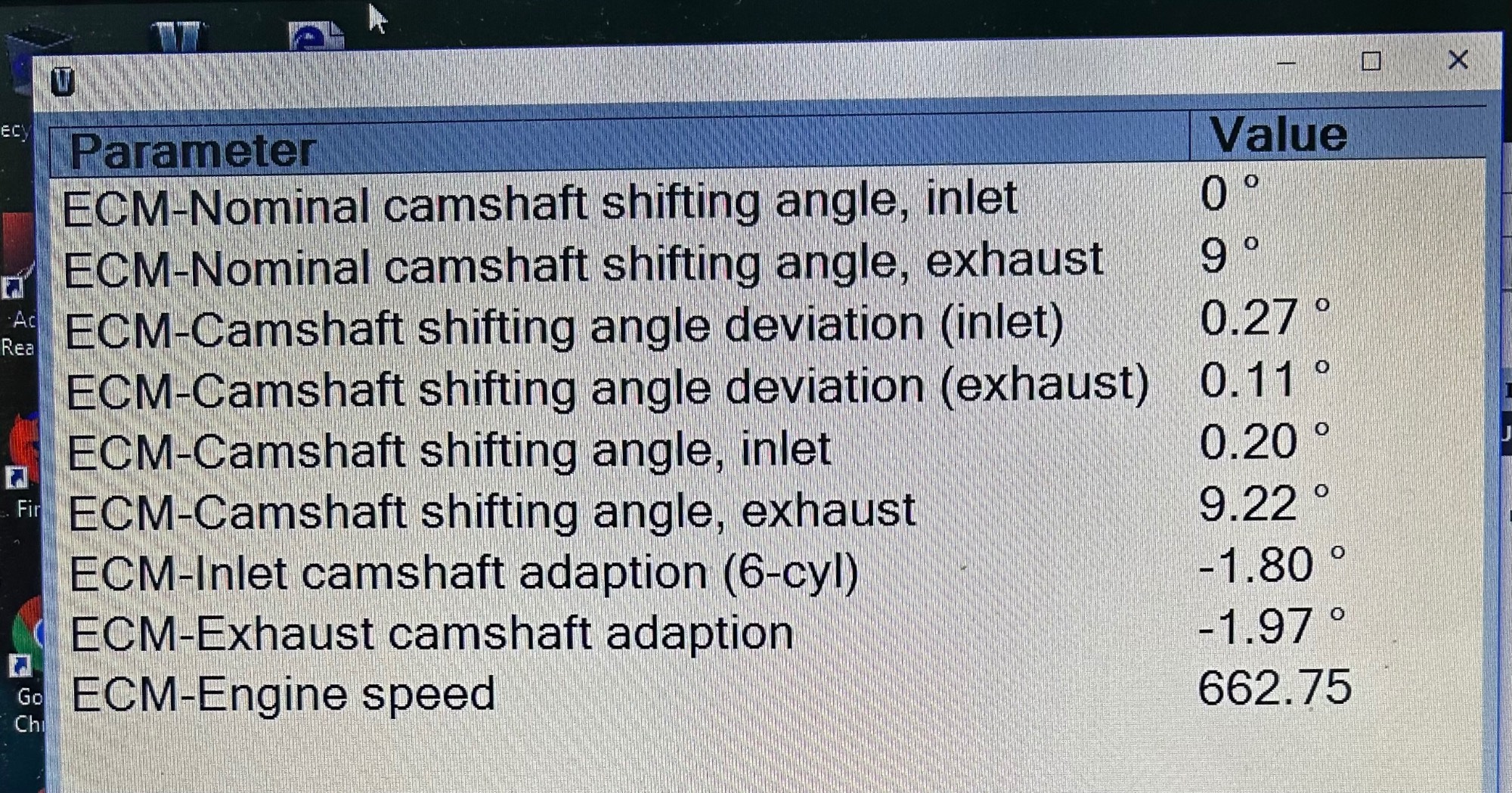

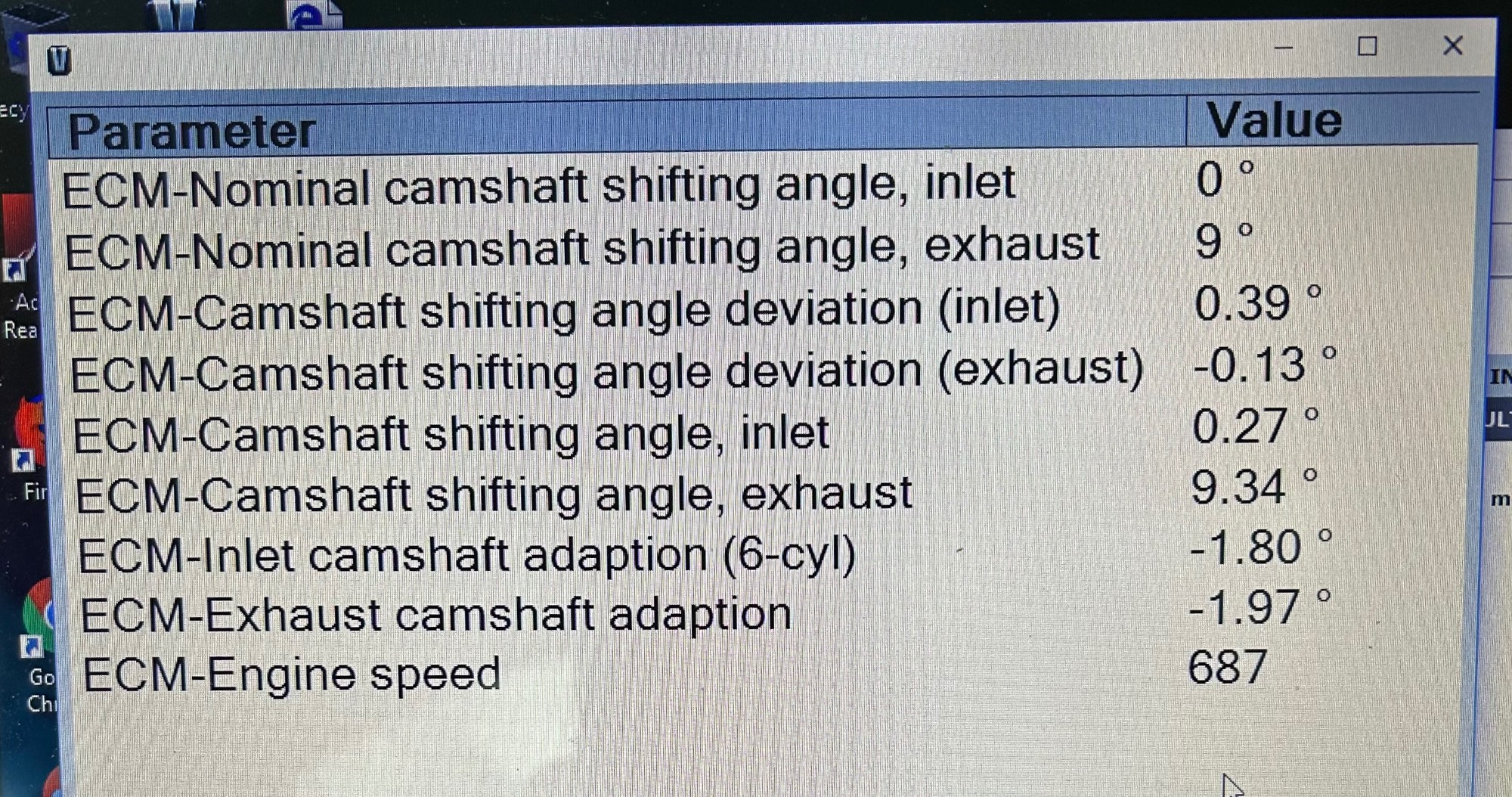

Here is a pair of screenshots, low and high rpm, note Engine Speed is in the pics. At the higher rpm there was some clear vibration from the engine chugging.
pair 1, low RPM pair 1, high RPM pair 2, low RPM pair 2, high RPM
Exhaust is somehow off by about a tooth, too far advanced? I was very careful to rotate VVT clockwise before timing it but maybe I disturbed it when I tightened down the center torx.

Or maybe it is shifting angle? The adaptation angle is unchanging regardless of revs. Each time I start the engine I get slightly different value but it then stays completely unchanged unless I start the engine again.vtl wrote: 01 Apr 2024, 07:00 With VIDA connected to the car, rev up slowly above 1500-2000 RPM and make a screenshot of adaptation angles. Maybe needs to be done on the go, under real load.

Adaptation is tested the first time the engine is reaching 1500 RPM after start.erikv11 wrote: 01 Apr 2024, 17:27 Or maybe it is shifting angle? The adaptation angle is unchanging regardless of revs. Each time I start the engine I get slightly different value but it then stays completely unchanged unless I start the engine again.

Thanks again for the explanation.vtl wrote: 01 Apr 2024, 18:14 Adaptation is tested the first time the engine is reaching 1500 RPM after start.
I have checked many times in VIDA now, adaptation is usually between 0 and -2.5, farthest off I saw it was -3.6, so seems imperfect but good.
Also ran the VVT test in VIDA several times, and both VVTs look great, never off my more than 1 degree.
All of this was done in the driveway, not under load. No codes.
I interpret timing is fine and so I did not, in the end, take off the timing belt and re-check the camshafts with the tool. Instead I will move on to other sources of the chug. Anyone disagree, could it still be timing issue? Something else to check?

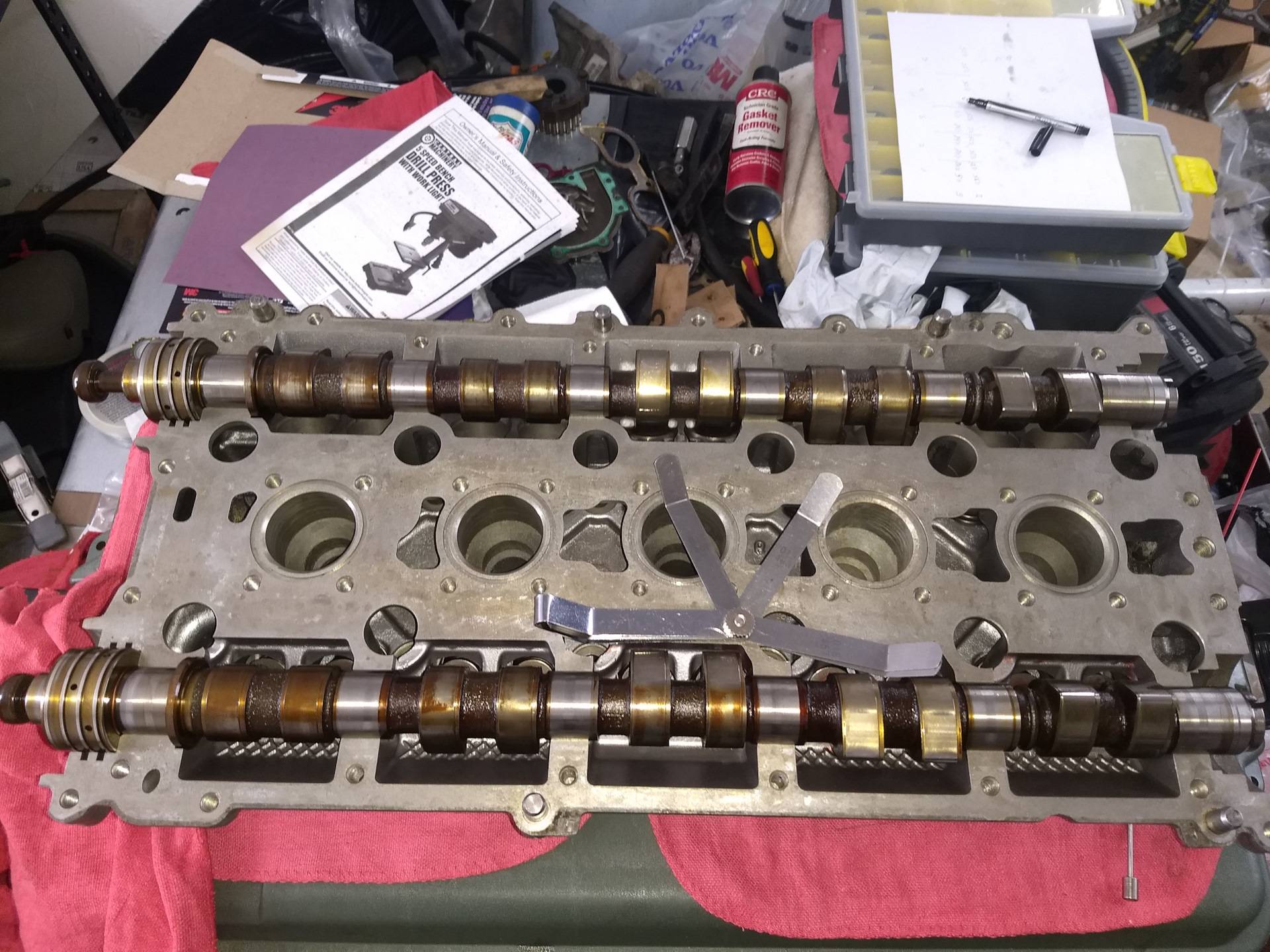

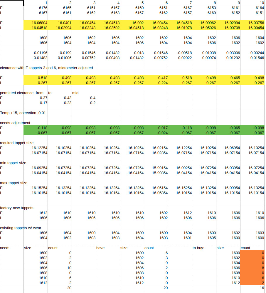

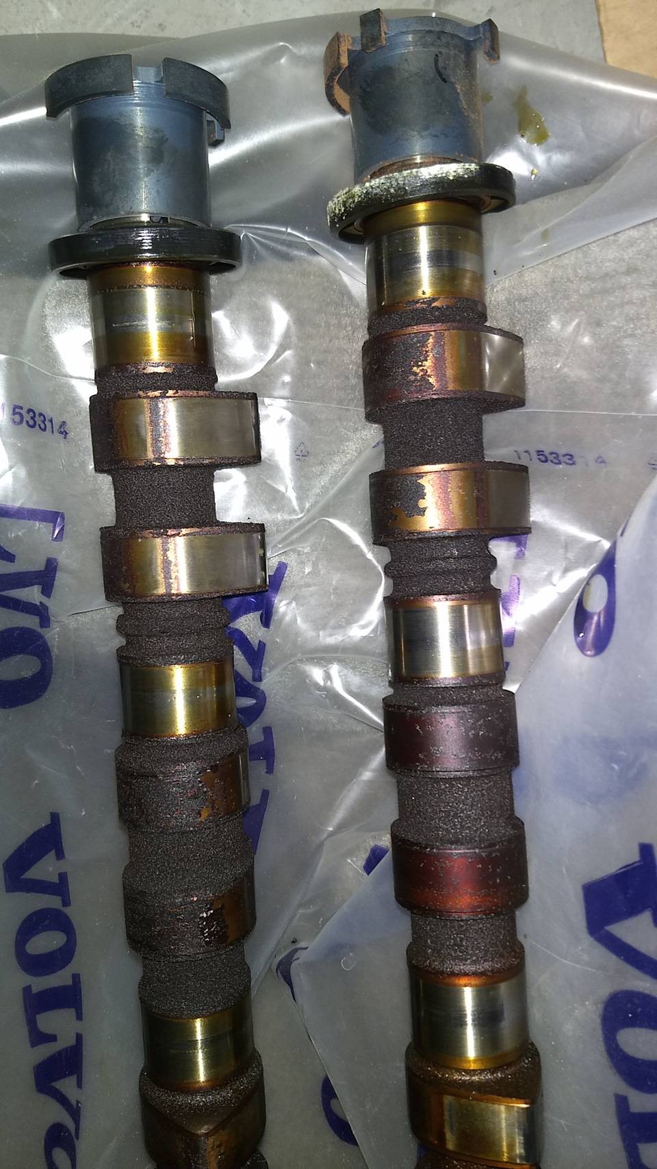

I would check the valve clearance next. My understanding the tappets are softer than the valves and the camshafts, so they wear quicker than valve seat and face, so the valve clearance does not need to be adjusted if you're okay with a bit worse engine performance. However, if the cylinder head warps in the middle, it reduces valve clearance in the middle, and the valves may not seal properly anymore.
Another potential problem could be the back of the lobes covered with hard oil deposits. I don't know if these deposits are hard enough to prevent valves from closing properly, though. Example from the donor engine w/ 220k miles I took apart:
That's my engine with burnt valve. It was much cleaner:
No head warpage, and I actually measured all tappets to be worn. Had to buy 16 new tappets to bring the valve clearance to spec.

4 degrees of shifting angle means you are spot on , tooth wise. I would look elsewhere for the chug. One tooth off is about 8 degrees cam angle , (or 16-17 degrees crank angle reported in VIDA) if the p2 is the same teeth ration as p80, which I think is true
