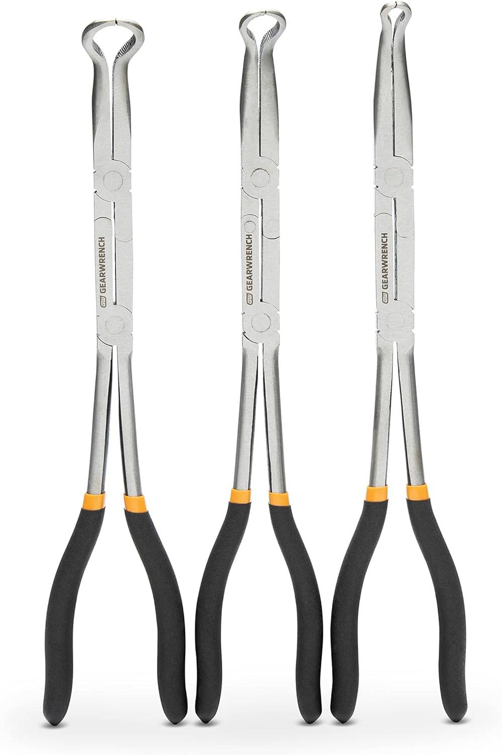

vtl
Posts: 4926
Joined: 16 Aug 2012, 13:35
Year and Model: 2005 XC70
Location: Boston
Has thanked: 129 times
Been thanked: 686 times
Post by vtl »
I went to amazon to find a picture of double joint pliers that proved to be very useful and found a double joint hose pliers! I wish I had them years ago when I was dealing regularly with all those small hoses hidden below other stuff.
