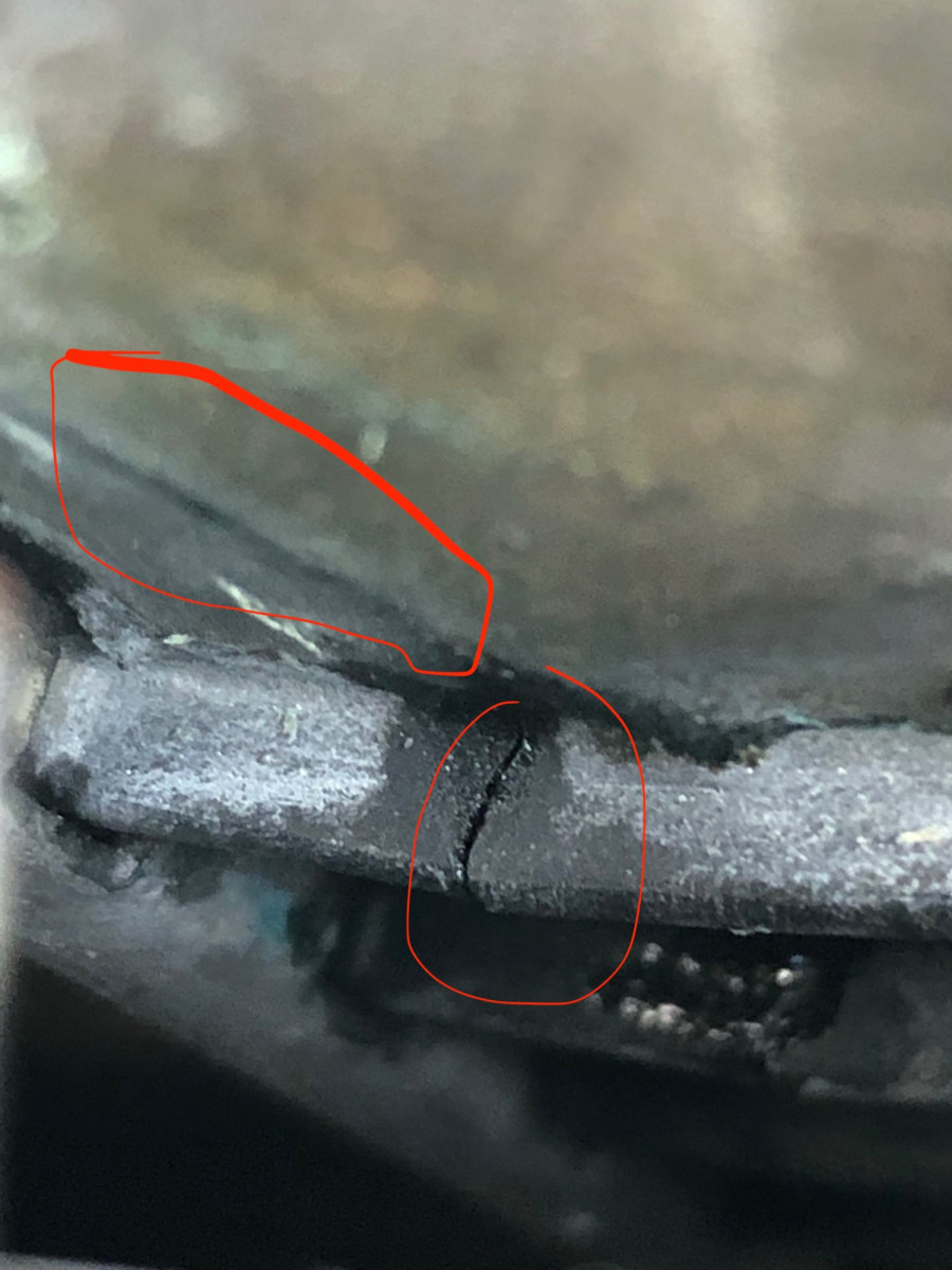

Time for new radiator.
Or, if you want to save money and roll the dice, get a used radiator.
Ah dang it, I was hoping you'd say I can "plastic weld" that, or slap some epoxy/sealant on top. I wonder if I can get an OEM steel one (if one exists) to avoid this issue In the future.
