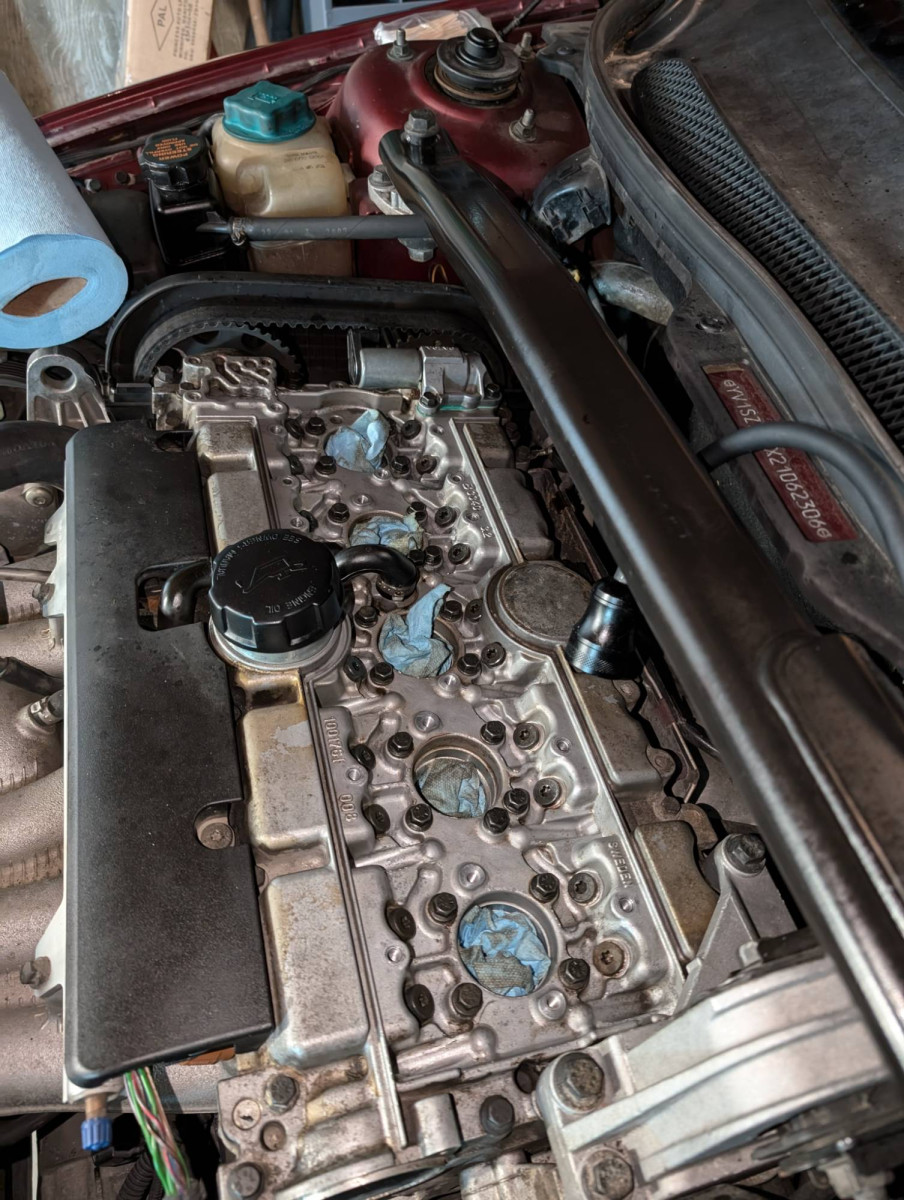

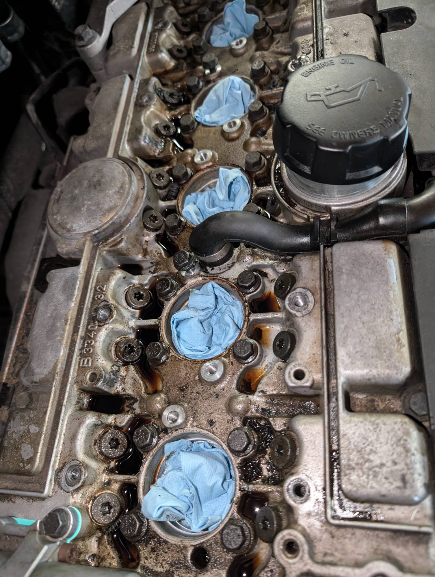

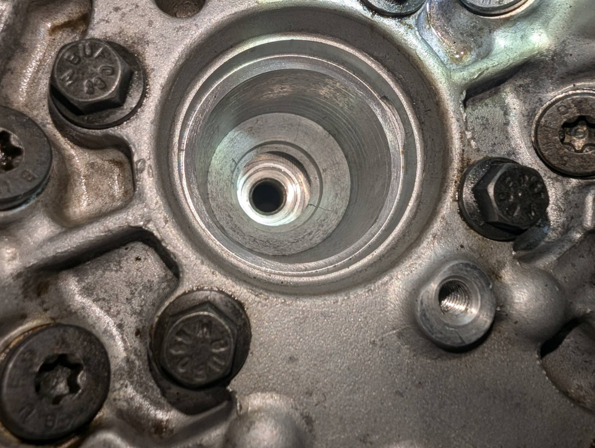

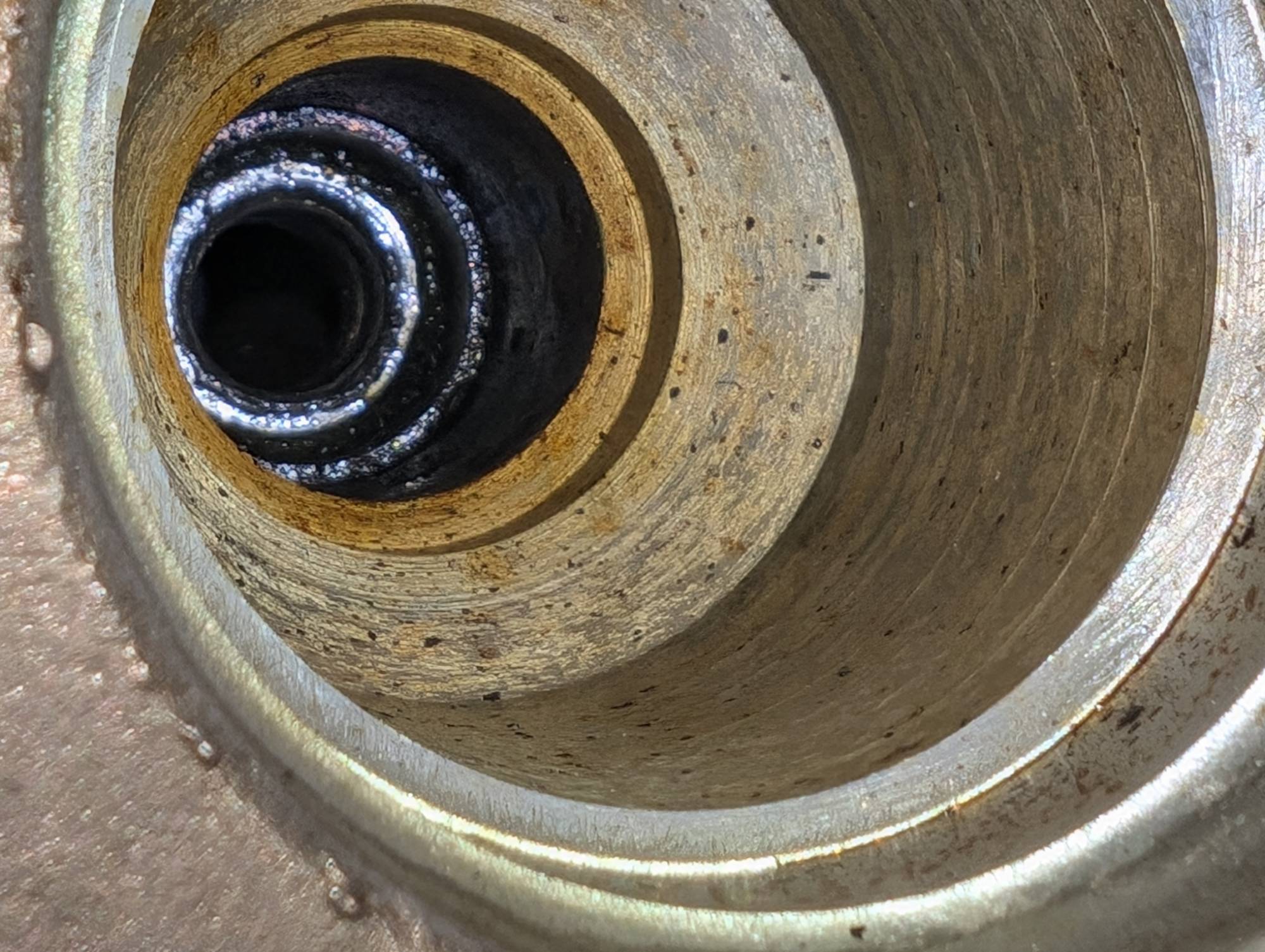

Again, limited time today. Cleaned the horrible oily spark plug tubes. I hate cleaning them as they are hard to see down and these had sticky gooey baked oil in them.
I have also now gapped the new spark plugs ready for install. The next things are to clean the throttle body (TB), and then re-place the crusty CVVT and coil pack cable harness wires with ne heat resistant plastic tubing.

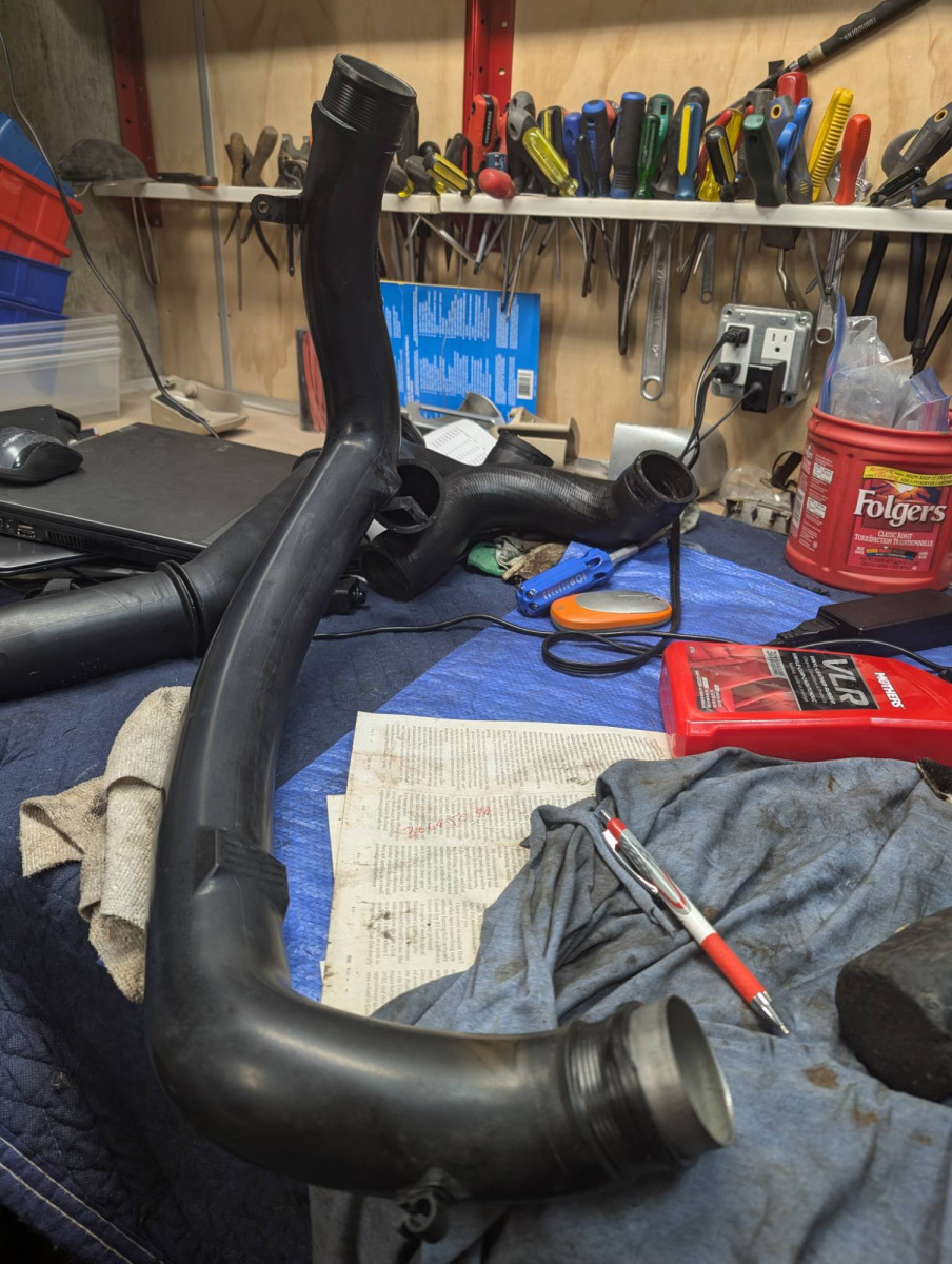

I glued the old and 'new' tubes today with Permatex high temp automotive epoxy. I cleaned both parts where I was going to glue between the flex joints with rubbing alcohol. I was going to use acetone, but as the plastic is so thin I was concerned it might do more harm than good.
I roughened the area with sandpaper, cleaned it with the rubbing alcohol (IPA) and let it dry. Mixed the epoxy and used a tooth pick to apply it between the ribs of the joints. I will leave it now for a full 24 hours. I picked up a tube of the Permatex high temp (up to 650C) RTV and tomorrow I will clean the area again with the rubbing alcohol and then apply the RTV. I also bought a roll of the double thick extra sticky Gorilla black tape. I plan to use that so it straddles the joint, and then 2 more strips, one either side overlapping the first strip.
I'll post pictures of the progress tomorrow. I plan to use the 'new' one, but at least I will have the spare as a back up should I need it.

That gave me time to put the high temperature RTV onto the intercooler to throttle body plastic pipe joints for protection after gluing them yesterday. I cleaned the area with a paint degreaser and put the RTV into the channel between the ribs one the stretched joint on the 'new' pipe and both joints on the old one. Tomorrow when the RTV has cured I will use the extra thick/sticky Gorilla tape to finish the repair ready to re-install.

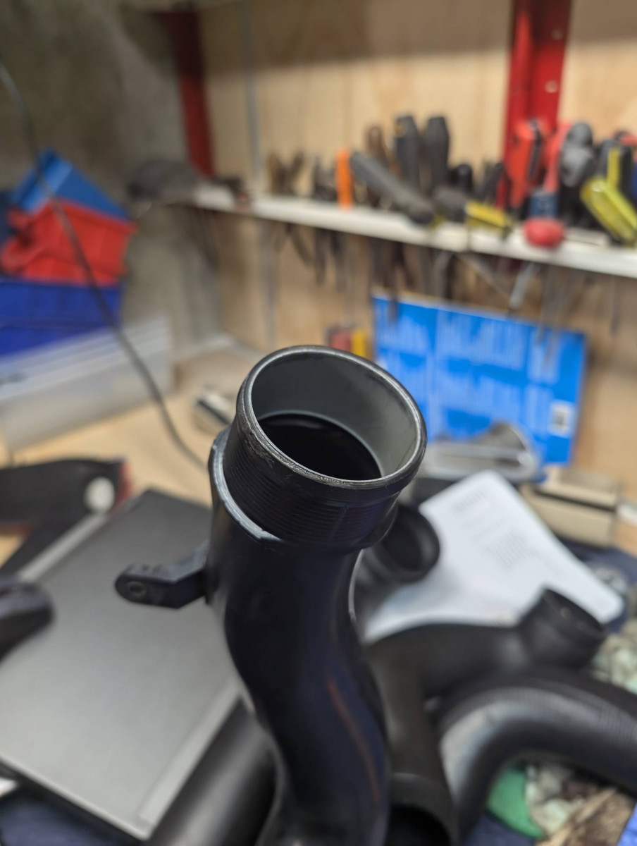

One other thing I did yesterday was complete cleaning all the plastic pipes, covers and other stuff that had been removed. One thing I discovered was the metal reinforcing bands on both ends of the plastic hose from the turbo that runs over the top of the engine to the rubber hose into the intercooler were not where they should be. The purpose is to give the plastic hose shape and strength to tighten the worm clamps firmly. Without them the pipe would get crushed. In fact, the end at the turbo end had almost come fully out, and the other end was partially out. So the turbo end was not tightened onto the metal so had flattened and deformed the hose:
You can see above that at the bottom of the picture the hose end is deformed and the metal band would not go back in. The other end was maybe 50% out and tapped back in with a hammer easily as it was not deformed. The end above would not go back in.
I warmed the end of the pipe with a heat gun, pushed the metal band partially in (if this happens to you, check the metal band has a slight chamfer on it), then turned it so the metal band was down on the anvil part of my bench vise and pushed it in. This worked perfectly and reformed the plastic end and as it cooled it tightened the band in place:

After letting the high temp RTV set over night, I tried to wrap the joints with the extra sticky and double think Gorilla tape. Total waste of time. Should have bought the narrow stuff as it would not fold around the ribs as the are on a curve. Also even though the surface was cleaned with cleaner, the sticky stuff was disappointing in this case. In the end I just used multiple layers of electricians tape as it at least stuck, and it formed easily as it is stretchy. Not ideal, but for the purpose of trying to improve the running at minimal cost it is fine for now.
