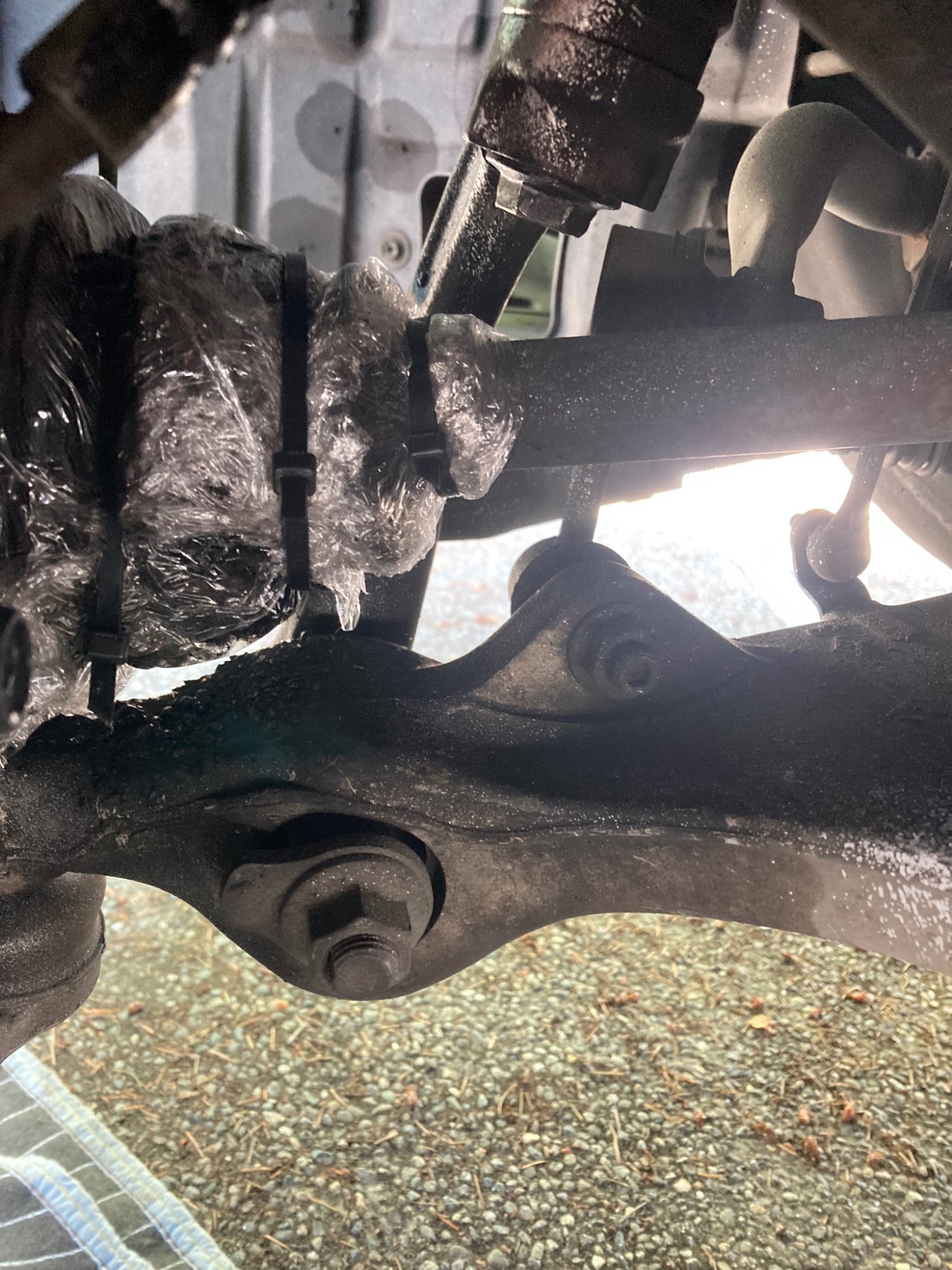

A) if the inner is not shredded, and you don’t want to deal immediately, you can run a while with saran wrap and zip ties to keep it from flinging grease. Sounds ghetto, but honestly it works.
B) If the inner is NOT trilobal on the can (the can is smooth all the way around, not indented externally for the lobe grooves), the UK-made “Bailcast” split boots are in fact decent products. I used one once in a pinch and was impressed. $20/$22 on Prime. These are quality rubber and work OK if installed carefully/correctly:
https://www.amazon.com/Bailcast-CVS18- ... B0080DLLIY
C) For the Oetiker clamp that failed, a strong large zip tie works just as well. Really, they do. I learned this from the autocross community where boot repair is a constant thing. The boots fail long before the wide zip ties, in autocross or in street use.
Looks bad, but works in a pinch for grease control. I have my Lexus GS (that’s the pic) wrapped this way now; it has been for a few weeks until I could get to the axle in this coming week:

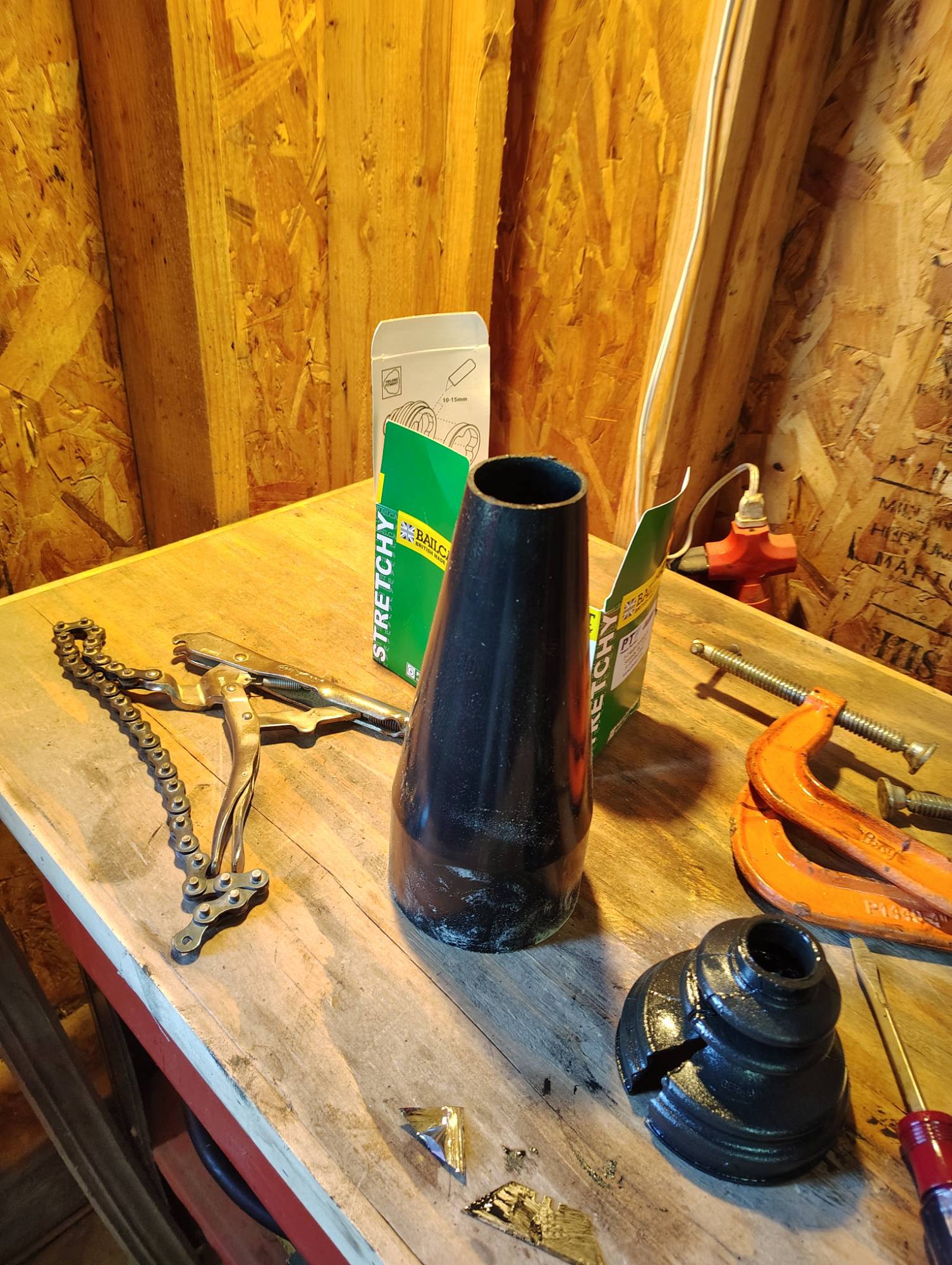

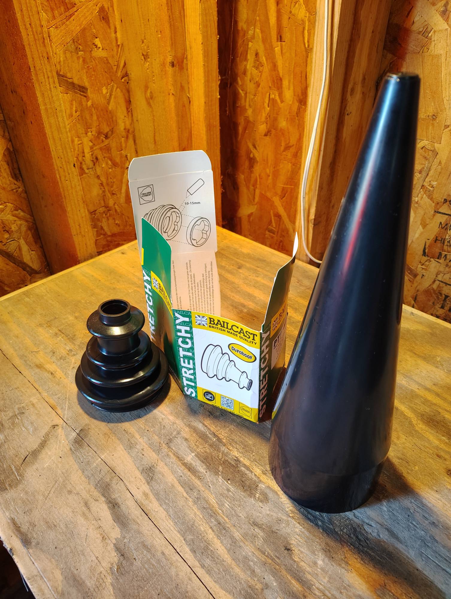

Well I finally finished the " project ". I can easily say it was the worst experience working on Sveedy. Ever.
I measured everything, and selected the DCB300 stretch boot for the inner RHS. But it was obvious from the start that the stretch boot was going to be a real bitch to get over the installation cone. So....

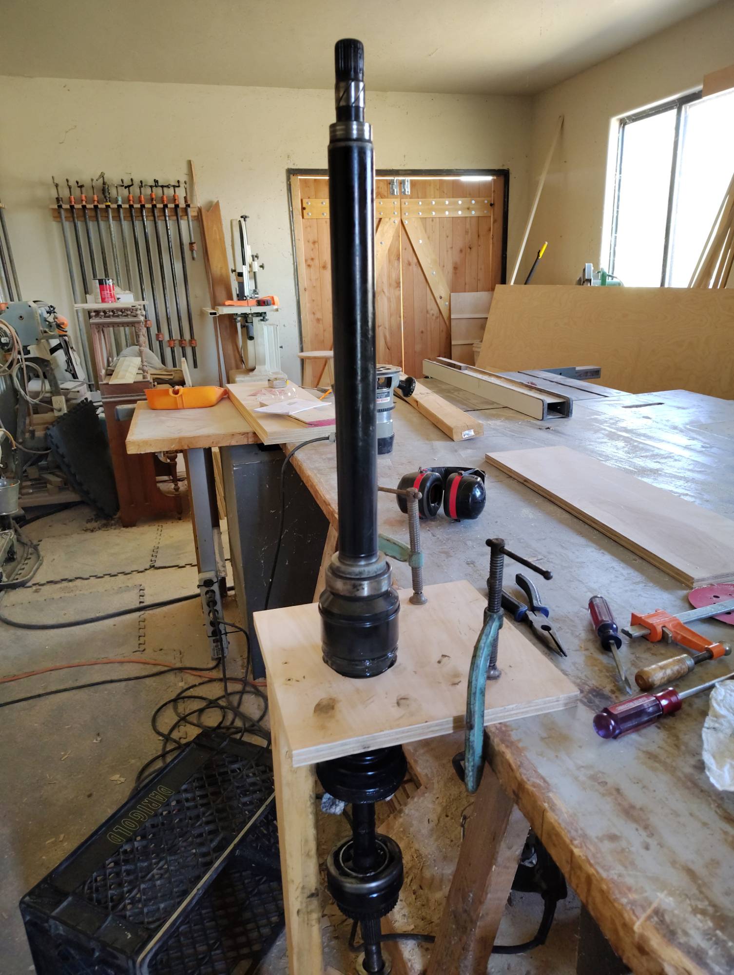

First I built a jig to hold the axle vertically, lubed everything up liberally with Marvel Mystery Oil, but it still took two of us to get the boot over the cone ( one pushing and one pulling ). Then had to switch to holding the axle horizontally with a set of chain vice grips and a rag. Talking about two construction types, not desk jockeys, so a tiny bit of force was needed to get the boot over the cone.
The cone is designed to be used from the outer end of the axle, not the inner, so I had to cut it to fit over the axle so I could do the inner boot.
Takeaways : Replace both boots, even if only one is bad. You DON'T want to do this again.
If possible, remove the outer c.v. joint and replace the boots from that end. Stretch boot should be a second choice.
Use a jig to hold the axle, no matter If removing the c.v. joint, or using a stretch boot w/ a cone installation tool.
Be prepared to recruit a second set of hands.
