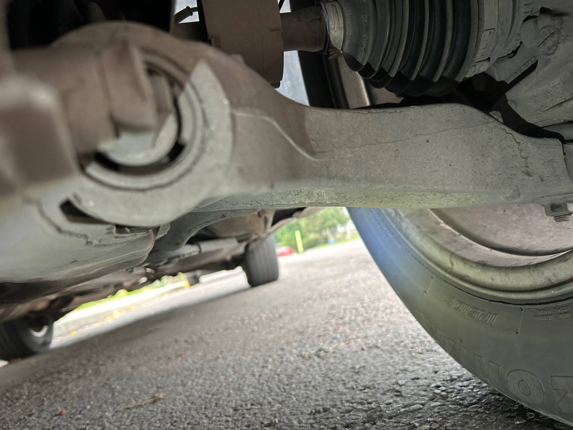

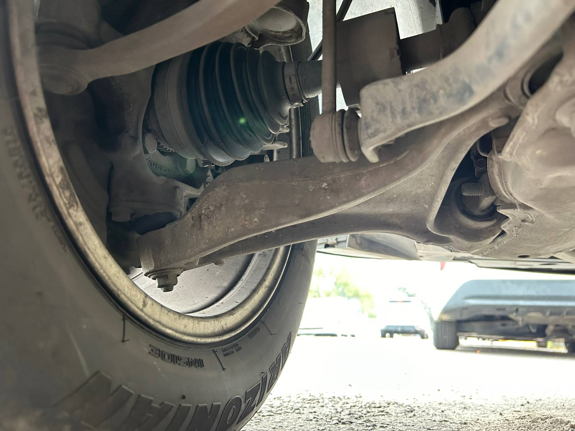

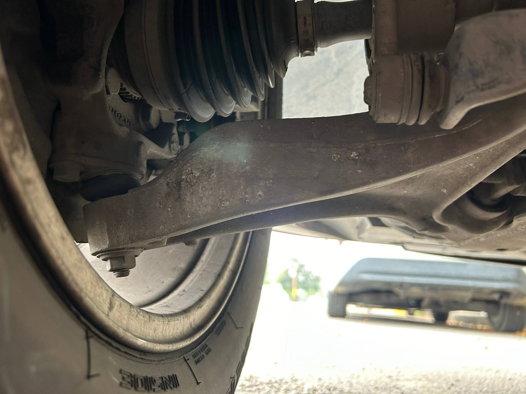

I crawled under. I'm not seeing anything resembling a steering stop here. Didn't I have them on my 850 - like a white nylon stop bolted on the side?
LF from the rear
LF from the front
These are the aluminum IPD HD control arms.
LF from the rear
LF from the front

No steering stops present from that pic. I only have them on my S60.
