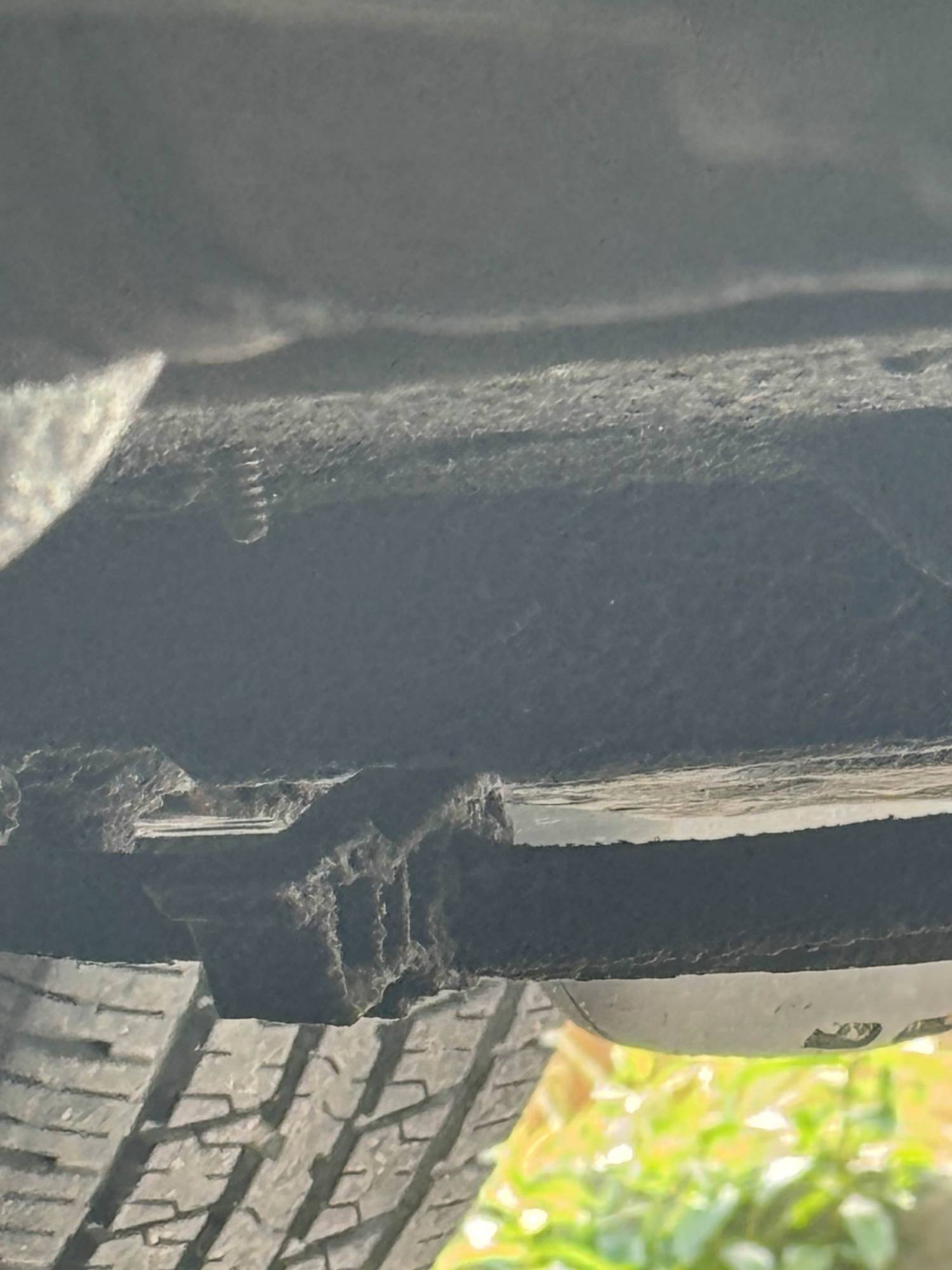

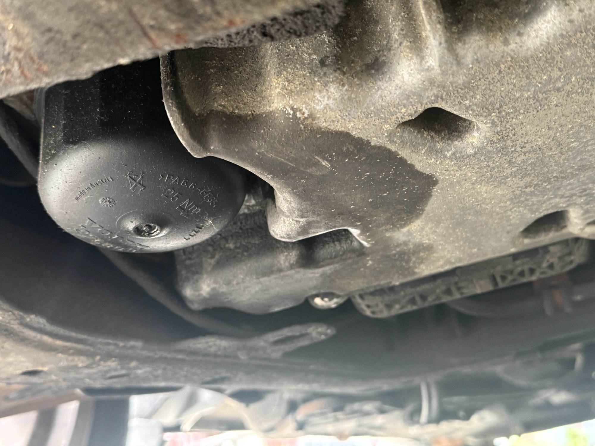

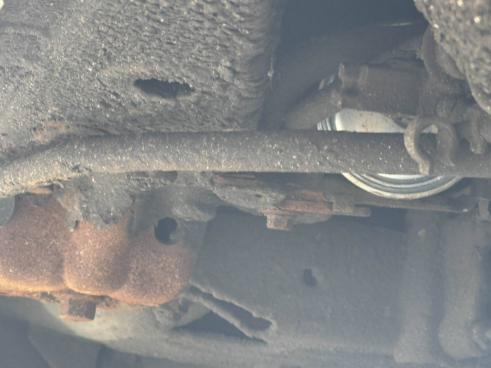

Please let me know what I should investigate regarding the underbody rust, as this is also a concern at this time. will likely need to scrub to get a better picture of the condition.

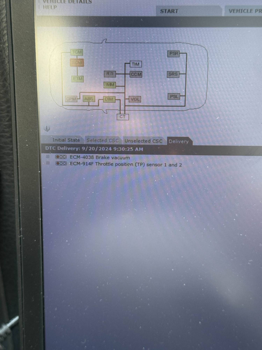

If you can find any engine codes and let us know what they are we may be able to point you to where to look for issues.

These cars, basically, don’t rust. I’ve got 4 of them which lived in the Northeast and never had structural rust of consequence.
If compression is bad, stop there and “ off with her head” rework the top.,,,graphic courtesy of foggy dog

It doesn't seem to lose coolant or cause any smoke. I'm not sure how to determine if theres coolant in the oil.
I will confirm and responding to further messages tomorrow after I charge the car. Will run Vida as well.
Just curious, when running v1da, I generally have the car off, but that is what killed the battery last time.
Should the car be running prior to booting up V1DA? I've experienced V1DA crashing when starting up the car when the fault trace asks me to restart the car, so not sure if im doing something wrong.

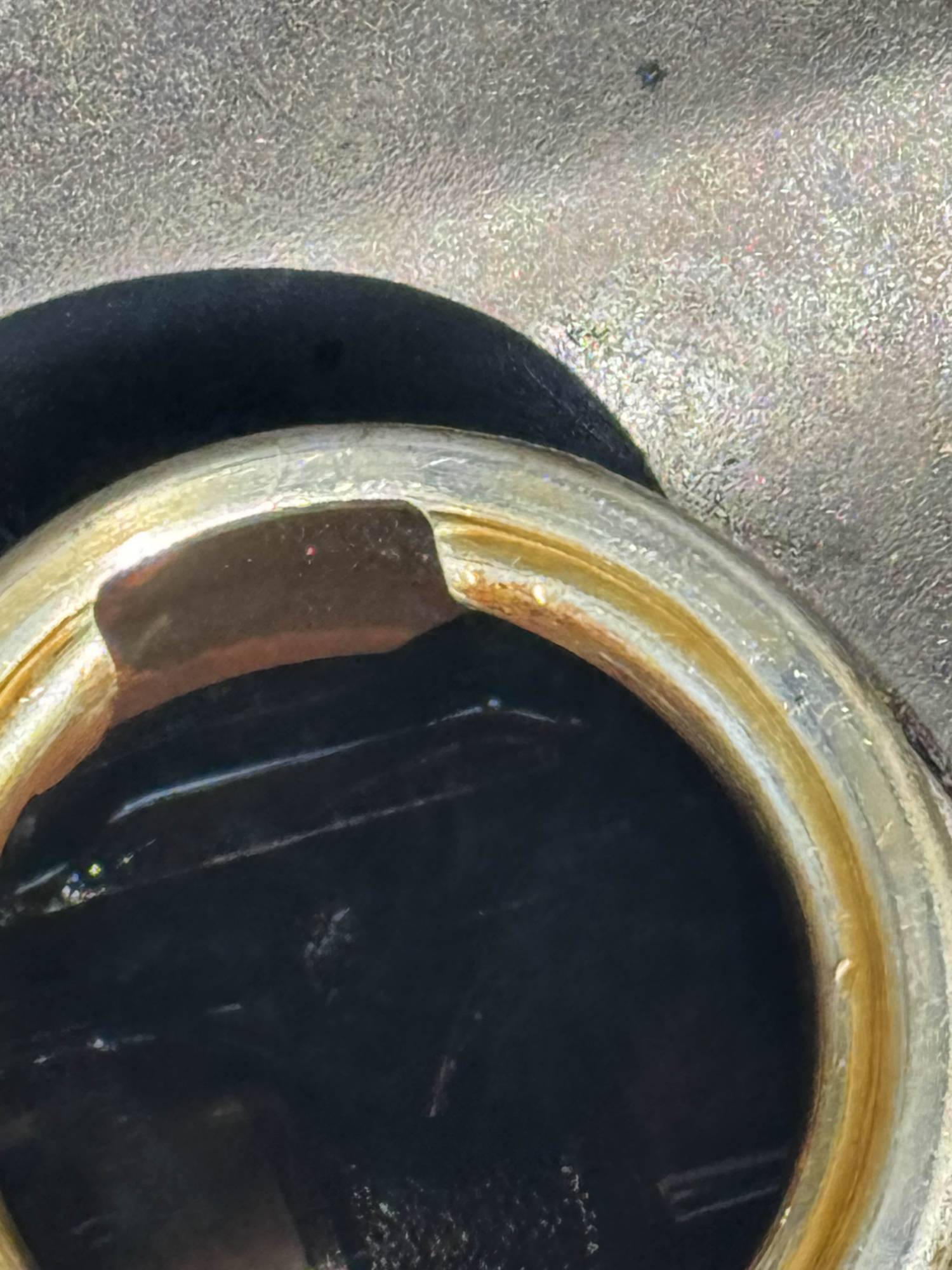

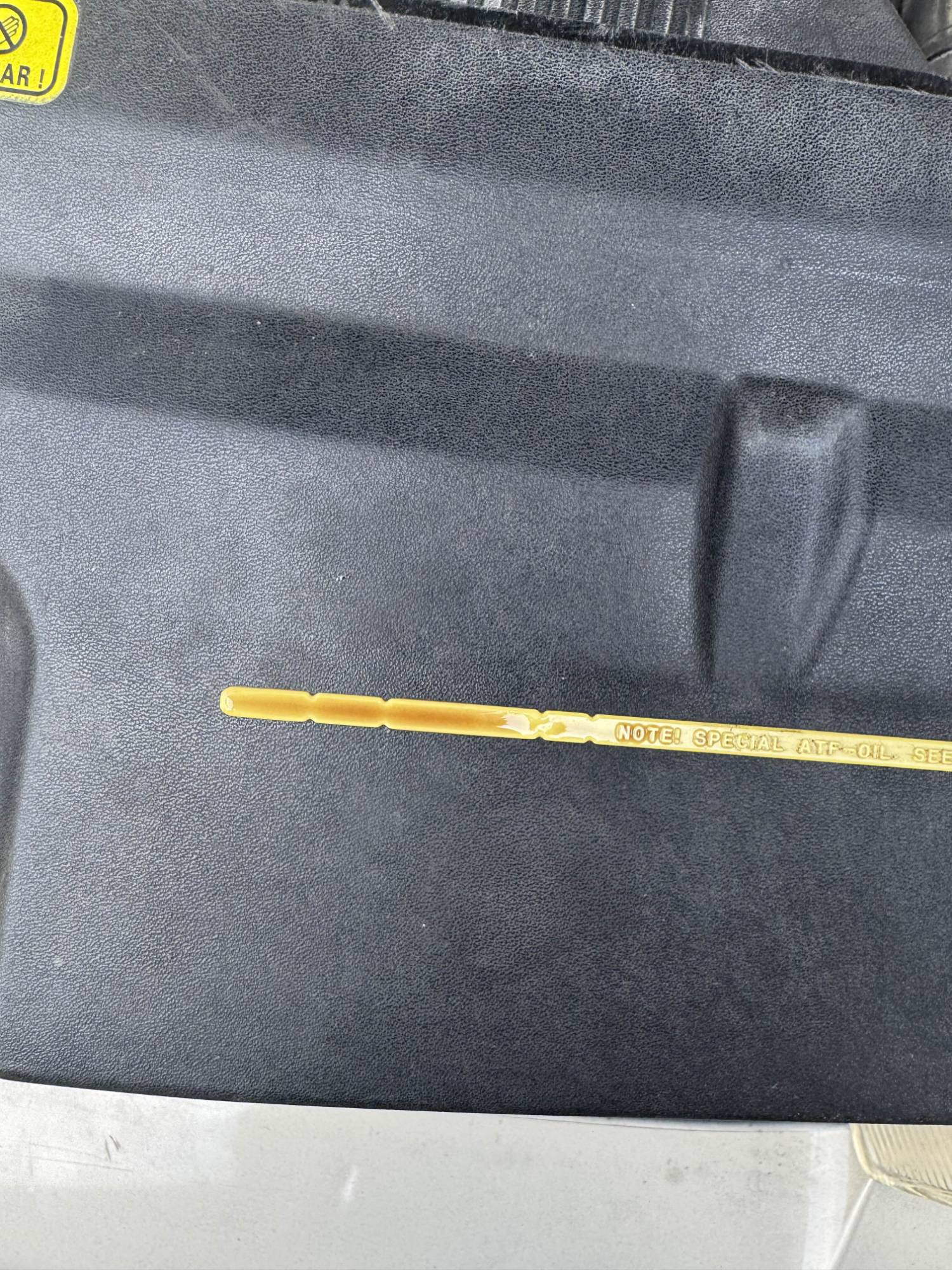

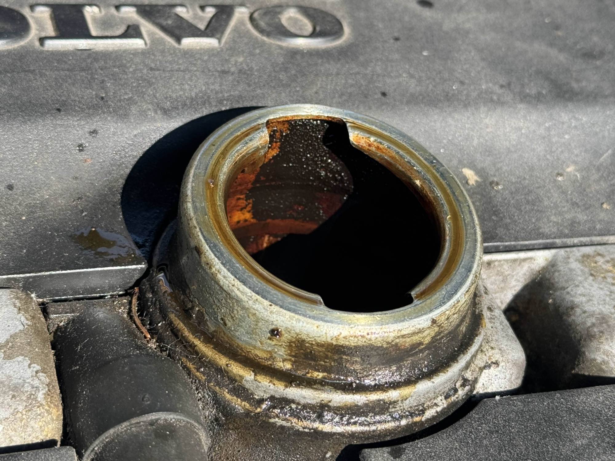

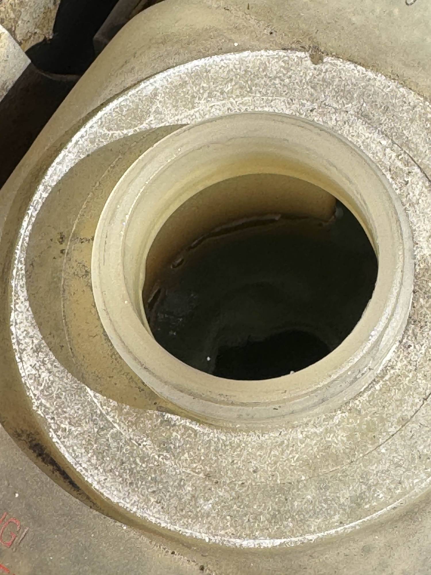

Watch for water in the oi and oil in the water. Remove the coolant reservoir tank cap and look for oil floating in the water. It should be obvious.
For water in the oil, remove the oil filler cap and check for a brown mayonnaise in the underside. You may get some caused by lots of short runs in a car that does not warm up enough and it can cause condensation on the cap.

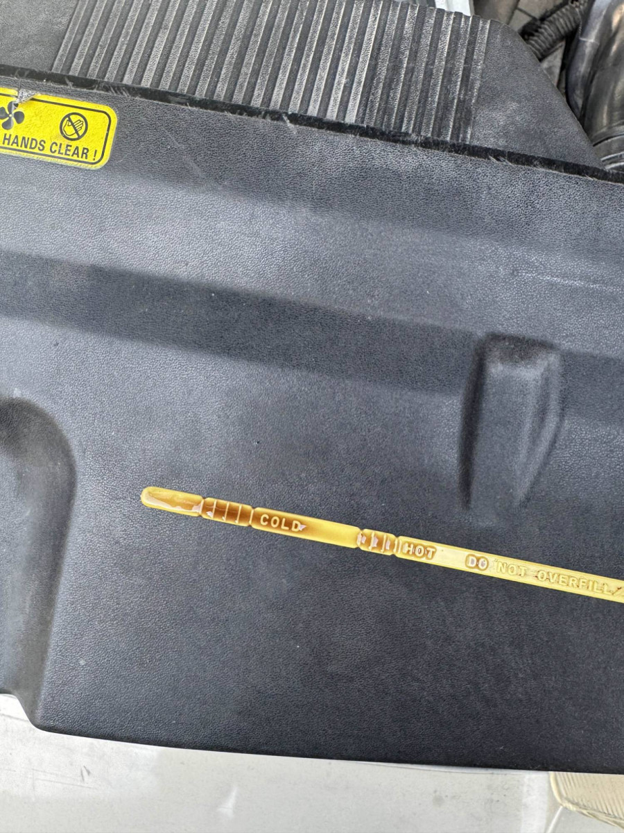

Pull the dipstick and check for same issue on that.
Also check the transmission oil. there should be a short yellow dipstick on the front of the transmission near the LHS (from driver's seat) bottom of the radiator. You may have to pull the air intake pipe to the airbox to get to it. It has a small metal clip that holds it in place. Check this also for brown sludge caused by a leaking transmission oil cooler on the rear of the oil pan.

Greetings Neil,
I'm not sure if its oil in the coolant, its hard to tell and its not very visible on the photo. It would appear there may be.
There is definitely some build up underneath the oil cap. The car has only really had short runs, but when I took off the cap it was smoking a little white.
The transmission oil was also checked and saw that it was hot but didn't seem to have build up.
I took a look at the oil pan, however even though there is a visible color difference it didn't actually feel wet. I'm not sure about this one.
I also noticed two unsecured cables and took photos of those and the above mentioned, including error codes.
I can't find a strictly metric tool kit, but the set i listed includes:
