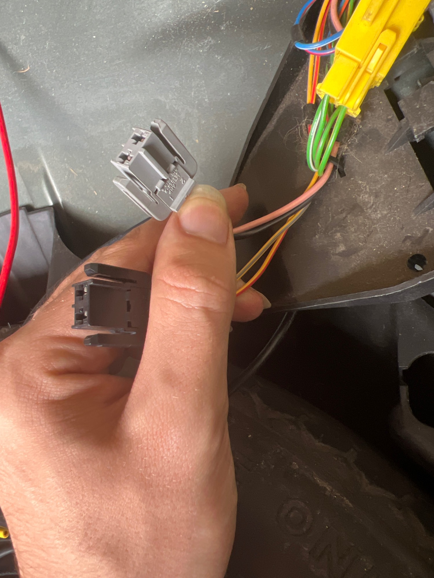

Also a reference photo of the ground connection from the back right side wiring harness. Access gained by unscrewing the T25 holding in the sill trim and prying it out, then lifting up some carpet. (Photo before vacuuming and giving the ground a good dose of wire brushing and a bit of dielectric grease to help conductivity)

Ground looks fine. Find that 5 volts!

DISCOVERY!
I believe I’ve found a source of the trouble! When comparing the photos in the DW guide for installing the wiring, I noted that the pink wire going into the gray connector is the positive (power) which (on Saskia at least) has the connector with a center ridge to keep from the wrong connector being put on. And it turns out, the positive and negative connectors on the VAST fuel pump are swapped!
I feel really silly just now noticing this even after I had compared the old and new fuel pump connectors side-by-side…
(I place a small blame on whatever current sickness I’ve got)
So hopefully a simple swap of connectors will do the trick
Update: it also just dawned on me that if the ground was getting voltage instead of ground, one of the wires on the ground connector runs into a connector that plugs into wiring that comes from elsewhere by the fuel tank, which if my understanding of the system is correct, is the electrical line that comes from the sending unit on the left side.

I should have caught this earlier. That fits the above perfectly.Lo and behold, it did make a difference. Still no start, still only getting 7.95V at the back when key turned to Pos. II, but now when the positive wire from the new pump is disconnected from the car, the gas gauge reads correctly!
