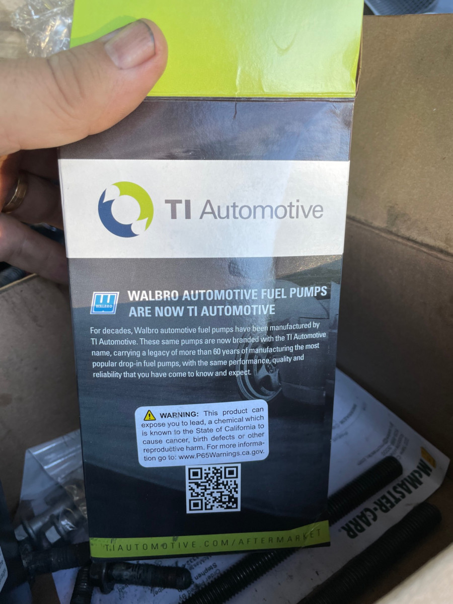

The above link is a more expensive pump, about $110, but it’s actually a Walbro design

The TI pumps above were more expensive but were assembled with the snout all good to go, no fitment issues. $110 but I’m sure feeling better about that with all that Labour
