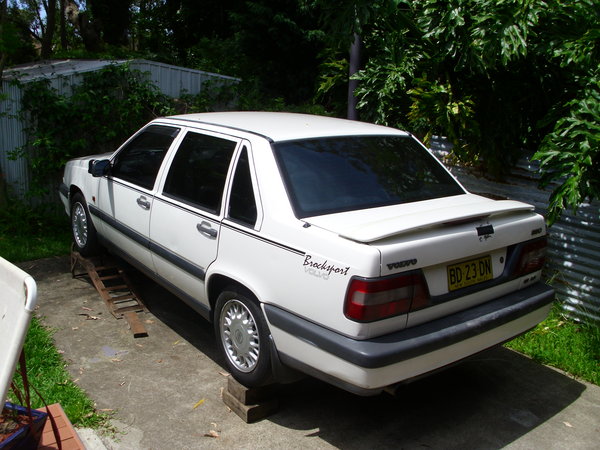

hi, i have a 95 850 with a dohc motor with B525S engine number so is this 20 v or 10v. car built sept 94. timming belts make me nervous ,dont know if changed car has 160k was told they were done,but no stickers any where , any one know any thing about brock sport models,thanks.lucky phil

Nice looking Brocksport lucky phil; I have a 95 10 valve wagon I'm about to complete after an engine swap/partial rebuild. Keep us posted how you go.
