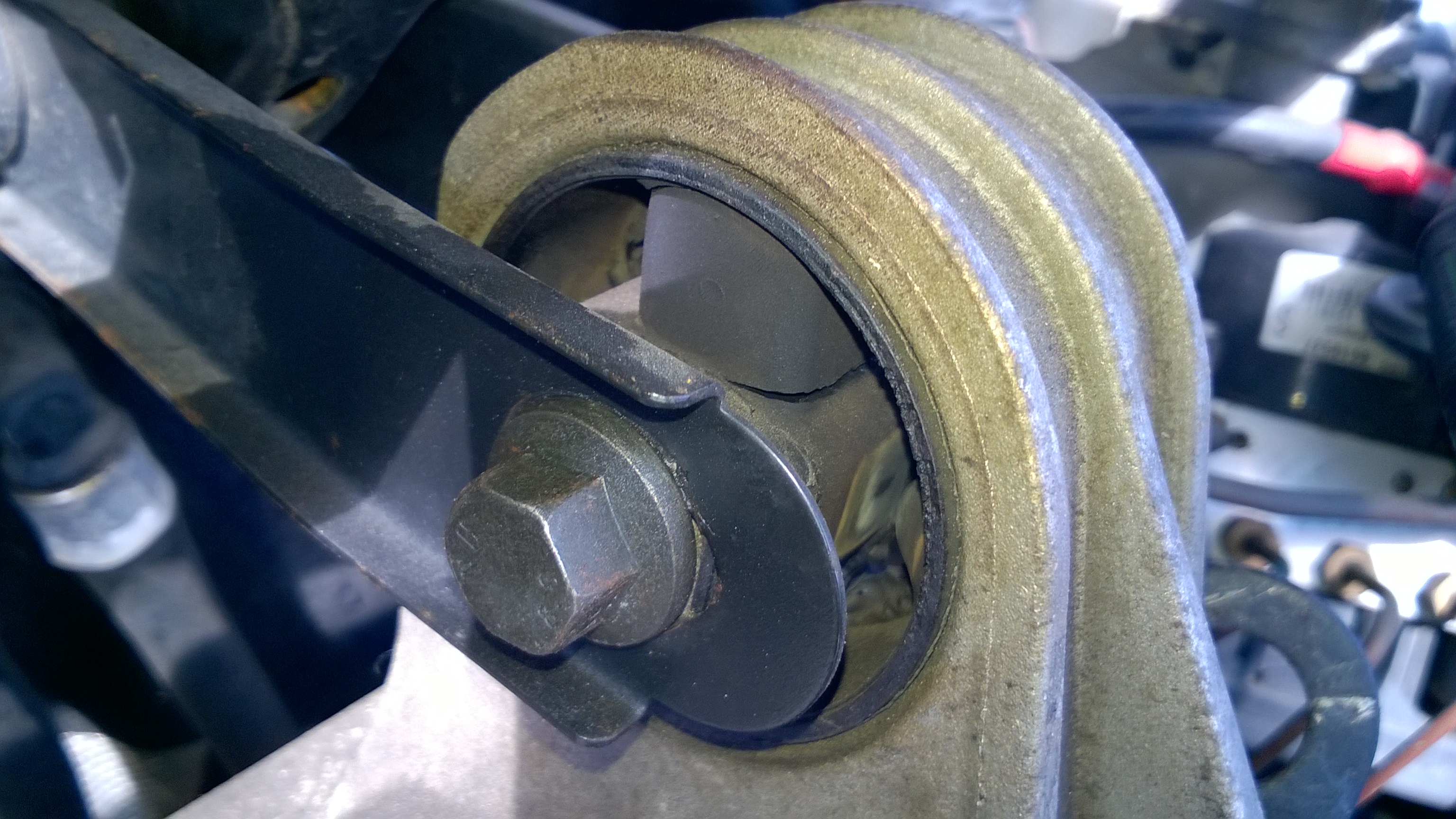

I done some searching on this forum for possible causes, I checked my top engine bush and the rubber is torn but I also read that if it is just the flashing part I don’t need to worry. The other posts I’ve read point towards a drive shaft being faulty, but I can’t see the connection between this and the cambelt change. I tried holding it in lower gears to check the vibration is not a function of engine speed and it isn’t.

Could be engine vibration transmitted through a worn engine mount. there are more mounts below the engine & transmission.

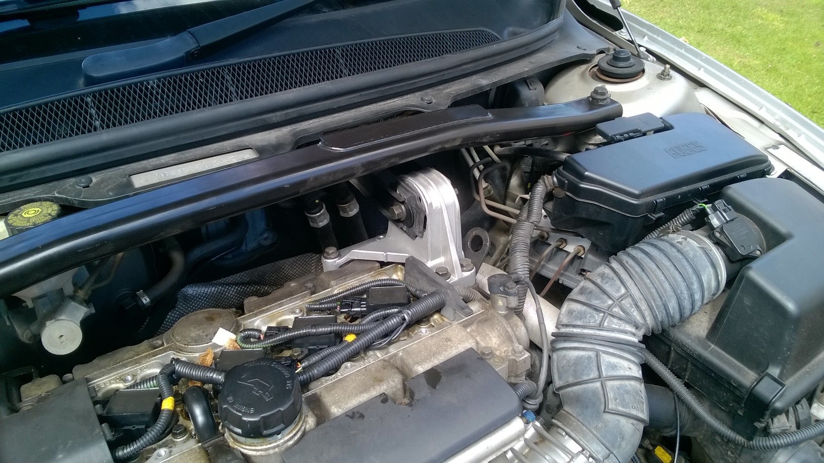

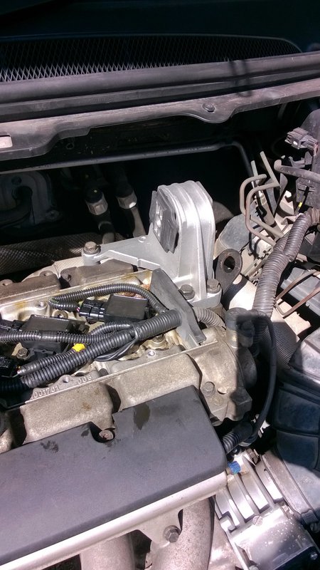

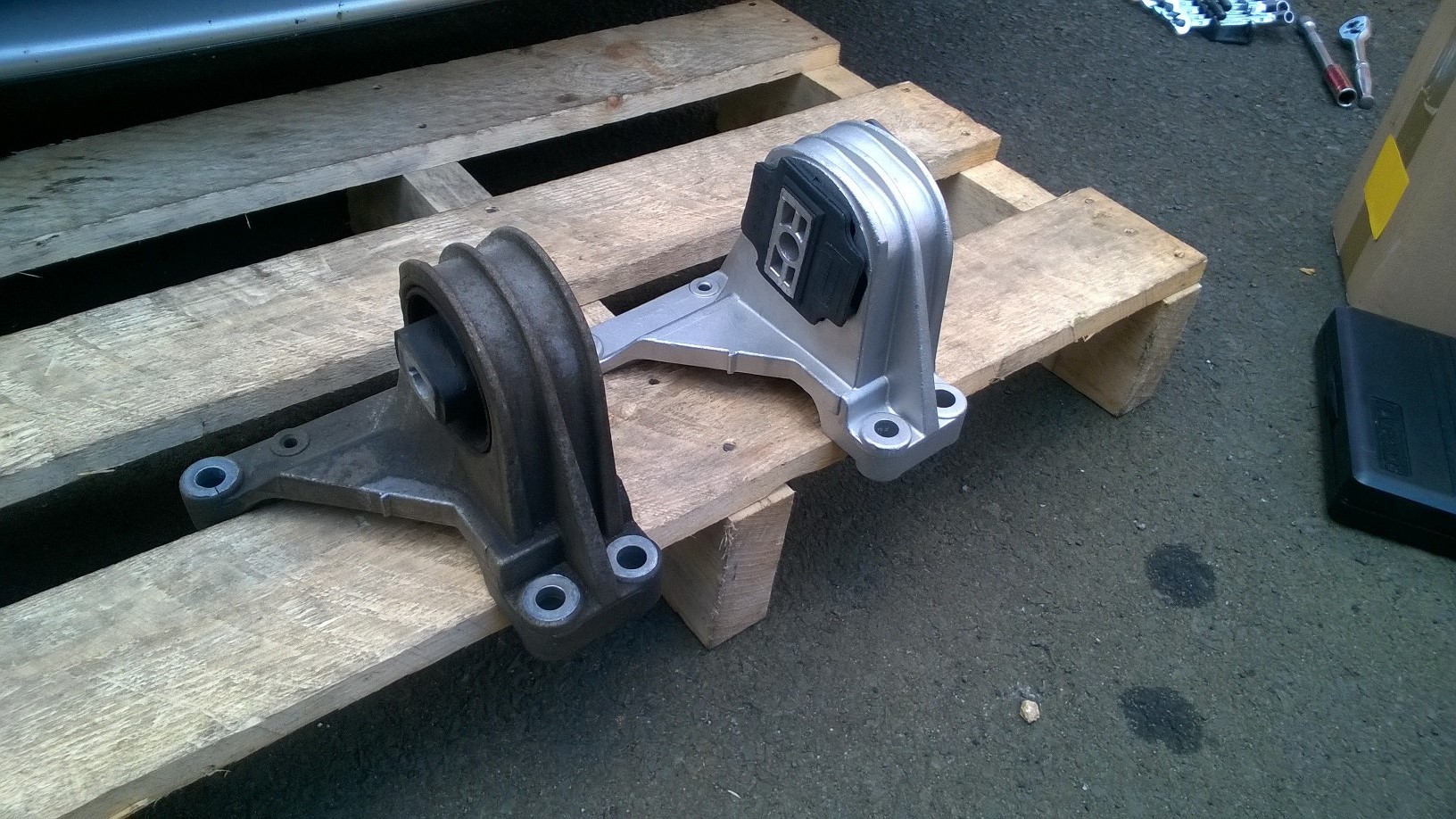

I changed the mount and the vibration is still there
This weekend I'm going have a look inside the inner CV joint boots, try and check for wear and repack them with grease.
The new mount is the square type

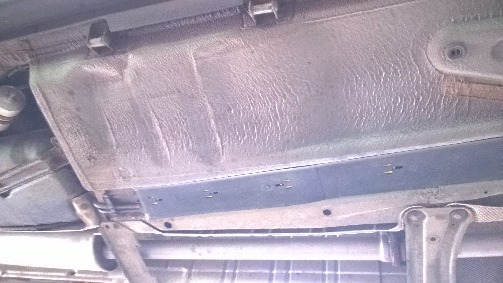

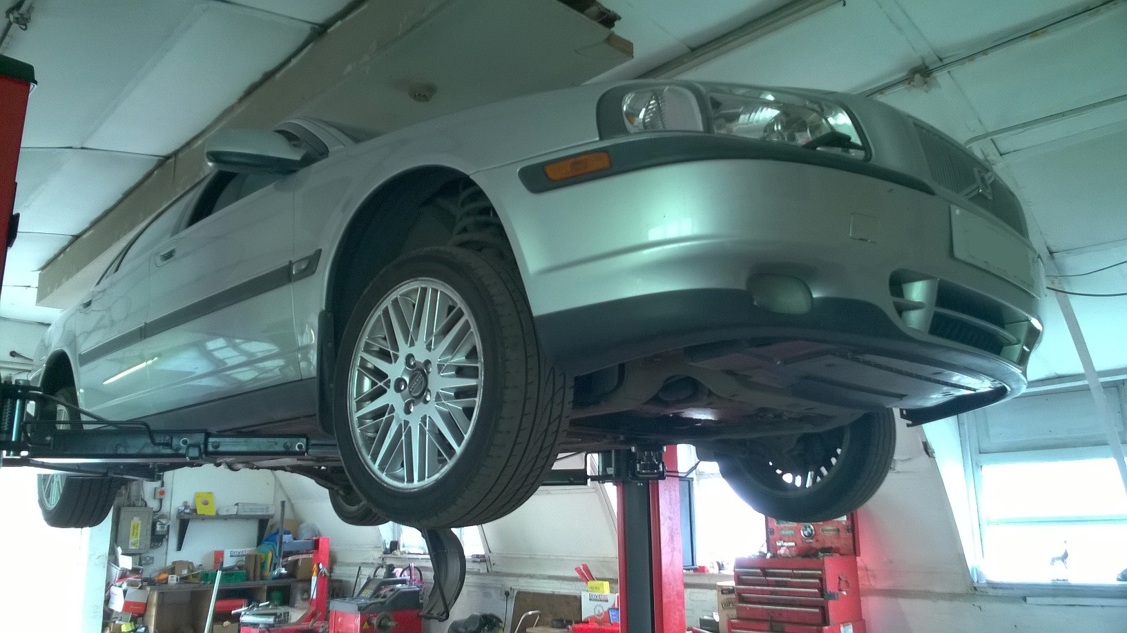

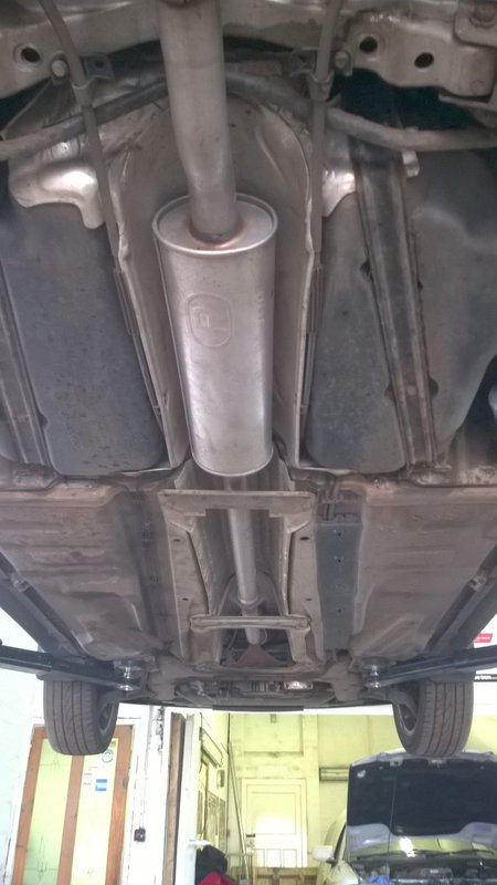

Yesterday I took the Volvo to the garage, to get new tyres fitted. I’m trying Goodride SA-37 Sport tyres from https://www.tyreleader.co.uk they’re the first Chinese tyres to get a decent review:
https://translate.google.co.uk/translat ... rev=search
The mechanic raised it up on the ramp so I could give the underside a good look over.
