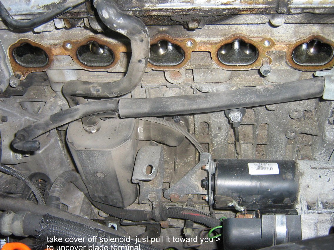

Terrence,
I had a similar problem with the same car - 98 V70 AWD. I ended up bypassing the PNP switch and it has been starting fine for 3 months or so. I had no other PNP symptoms other than not starting. I changed the key switch but that didn't help. It turned out the starter solenoid was not getting power to the small terminal. The terminal is under the intake manifold so it's a little hard to get to. There is a bypass "test" connector in the triangular fuse box and I connected a wire from it to the small terminal on the solenoid and that fixed the problem at least for now.
If you have a voltmeter, try checking the voltage at the small terminal when the key is turned to start. If there is none, this might be the problem.

I can visualize the blade (small) terminal on the starter solenoid, but not the other terminal (switched side of the starter relay). Tried getting the diagrams to open, but it conked in adobe. Maybe you can give a better description of the other terminal that the jumper wire needs connecting to?
Much obliged.
holler1
Posts: 756
Joined: 25 June 2008
Year and Model:
Location: West Virginia
Post by holler1 »
Jumper wire should go to the small blade terminal. Unless the solenoid is bad or current is not getting to main starter terminal, this should kick the solenoid in and cause the starter to crank.

Here is starter pdf file from 850 manual and a photo of the top of the starter and solenoid. The wiring diagram in the pdf is pretty good.
