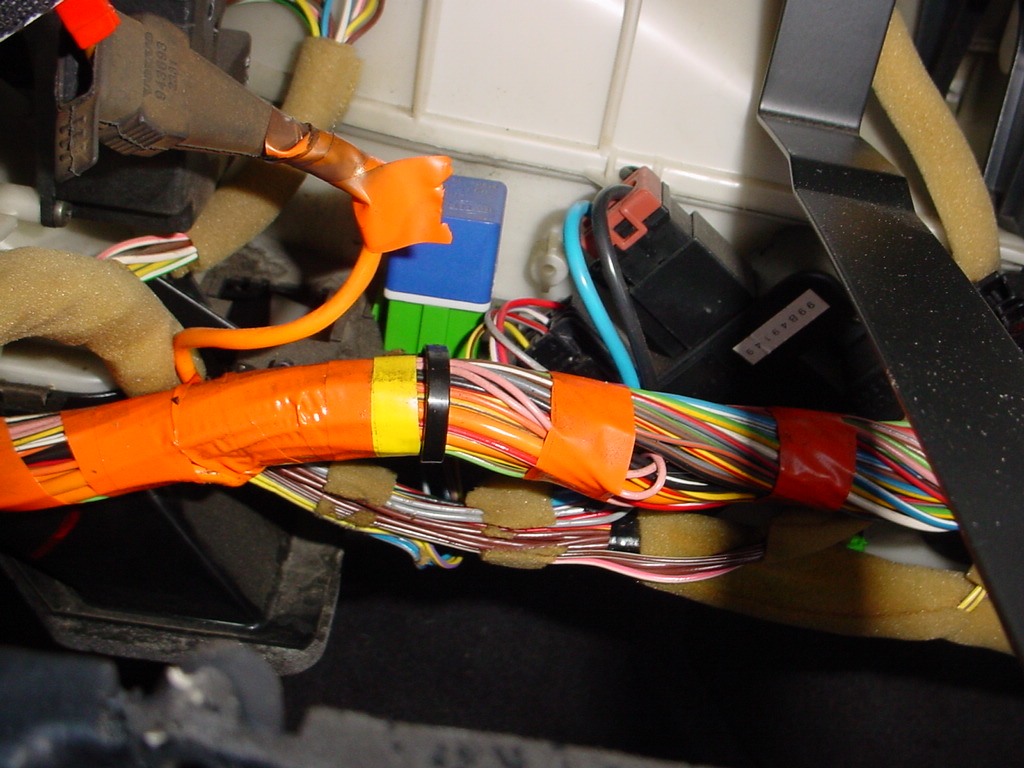

And the location of this resister is on the blower assembly?
Actually it is inset into the air duct just to the left (left hand drive) side of the blower.
It is the device with the Blue wire and the Black wire in this picture.
This is for the ECC, the wire colors and the connectors are different for the MCC but the MCC blower resistor is in the same location.
