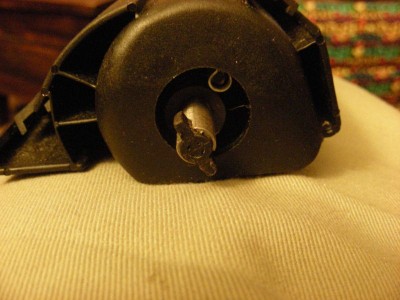

In this picture Image.
Do you need to remove the black center of axel?
How to remove the broken plastic white (picture spacer4.jpg) and put in the cooper piece?
I am try to translate to spanish your tutorial to post it in a spainsh volvo forum, can i do it?
