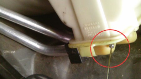

Well, my turn. I'm going through this now. And of course T-5 has the Turbo in the way... I'm not qualified, nor brave enough, to remove it - but right now I think I need to in order to reach the return line hose clamp. How wrong am I? Have other T-5 owners succeeded at this and left the Turbo in place? The photo shows what I see when looking down at it. Cramped eh? And turbo components and various hoses kill the angle to get to the clamp.
Next, similar to other questions on this, is the handling of the interior pipes to the core. It seems to me that I must disconnect the pipes at the lower end with the single screw that screws in towards front (which is the mounting screw I secured when I put the new core in last year. Am I right? I may have misunderstood an earlier post that I should be able to remove the pipes from the firewall connector, but I see no clean way to disconnect the upper end of the pipes to the connector. Wrong assumption? I should be able to disconnect at the top without dismounting the pipes at the lower junction?
Any comments appreciated, as I'm hanging fire on getting this completed - and there's a wife involved... lol.
