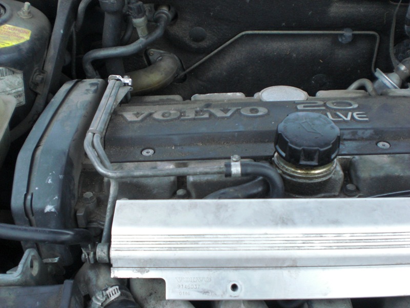

Also, I understand there are several different looks of the 850 engine, depending on turbo or non-turbo. Mine is a 5-cylinder, non-turbo. My fuel rail is simple to take off and the injectors came right out. The job was very easy. The toughest part for me was getting electrical connectors to "pop" back on the injectors.

Here is a very short illustration of the install of the f.p.r. I did. Nothing close to a how-to but there are several people who have viewed this thread, so I figured this may help somebody. :D And remember, I didn't start taking pics until I started to put it back on.
By the way, do you all think its time for new injectors? I'm sure everything on this car is original, including the injectors. They look bad, but they don't misfire anything. This car has been well taken care of, but as I found out yesterday, even the tailight bulbs have never been replaced. The one that was burned out had a long life though. I just went ahead and replaced all of them.

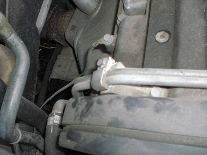

I guess the fuel lines are different on certain models b/c my Chilton manual told me to use two wrenches to disconnect them. Well, obviously I only needed to unscrew the bolt which holds them together. This takes an 8mm socket.

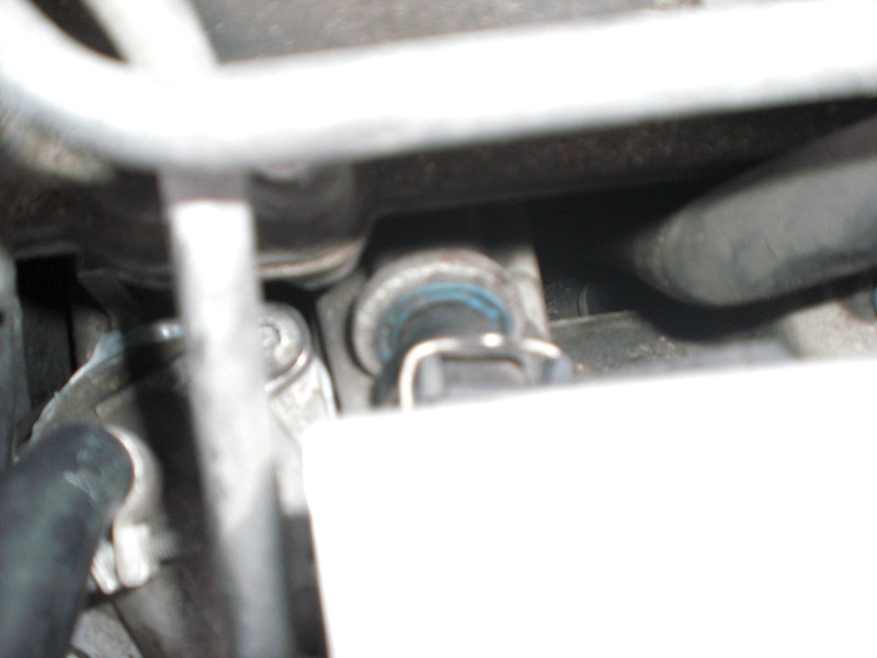

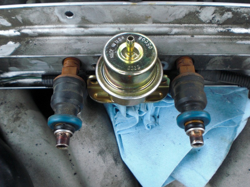

f.p.r. in fuel rail. This was a little tricky b/c I wasn't sure if I had it in far enough. I just kept pushing straight (don't wiggle side to side) and it "popped in."

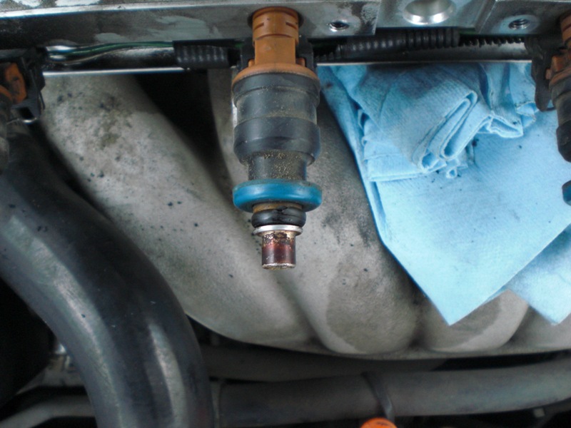

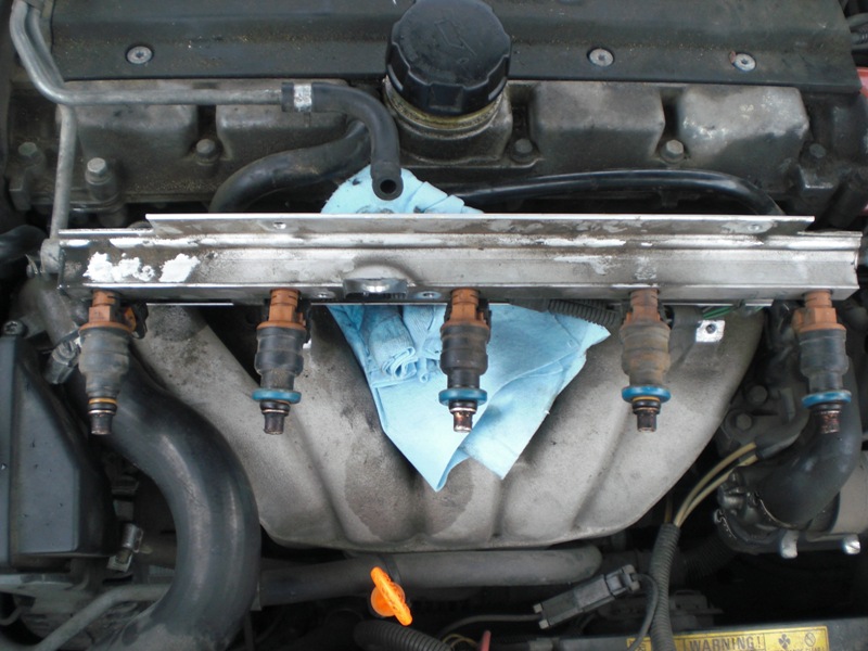

A look at the injectors. They are D-I-R-T-Y. Don't worry, I cleaned them up the best I could before I put them back in. Also, you can see where the gas stained the manifold. The leak pooled at the top of the manifold and leaked down to cause that stain.

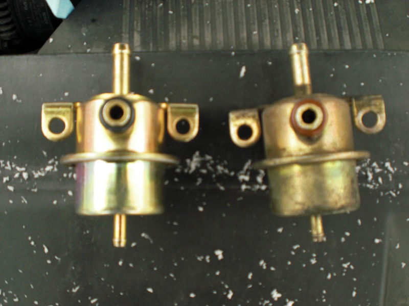

The new f.p.r. on the left and the old f.p.r. on the right. If this is the cause of my leak, the only thing I can think of is maybe the orange o-ring shrunk. Everything else looks ok.

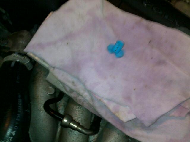

I just did this job on a 2000 V70, NA. It's basically the same. The only difference is that the fuel line is a quick disconnect type line and requires a special tool to get it apart. At Harbor Freight the set cost like, $5.99 and it's called a fuel line AC quick disconnect. The light blue one will do the trick.

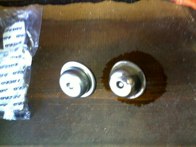

This is the Fuel Dampers for 2000 V70 (old and new).
Fuel line with special tool.
