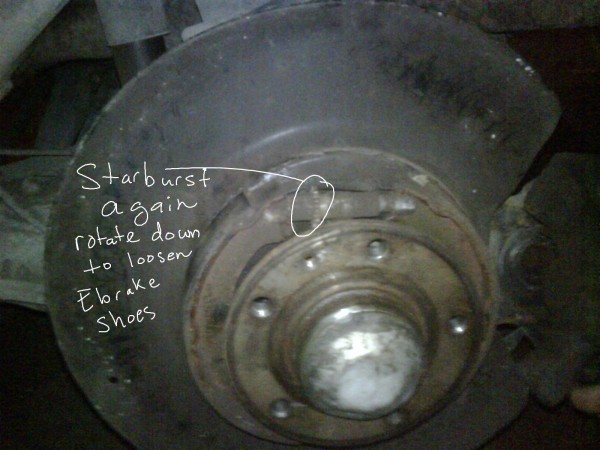

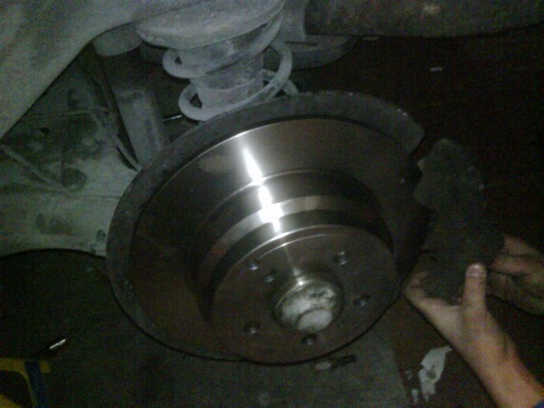

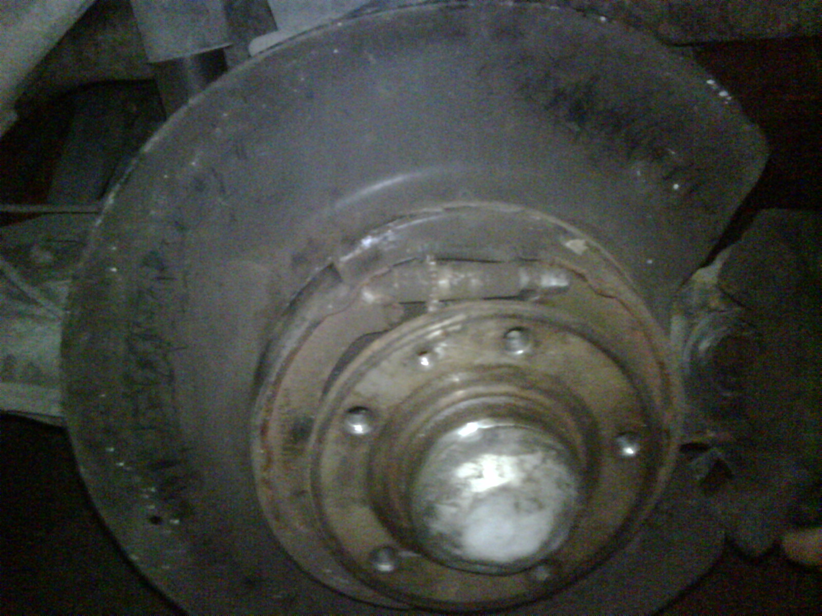

Ok ladies and gentlemen..or I mean gentlemen..I doubt there were any women responders..

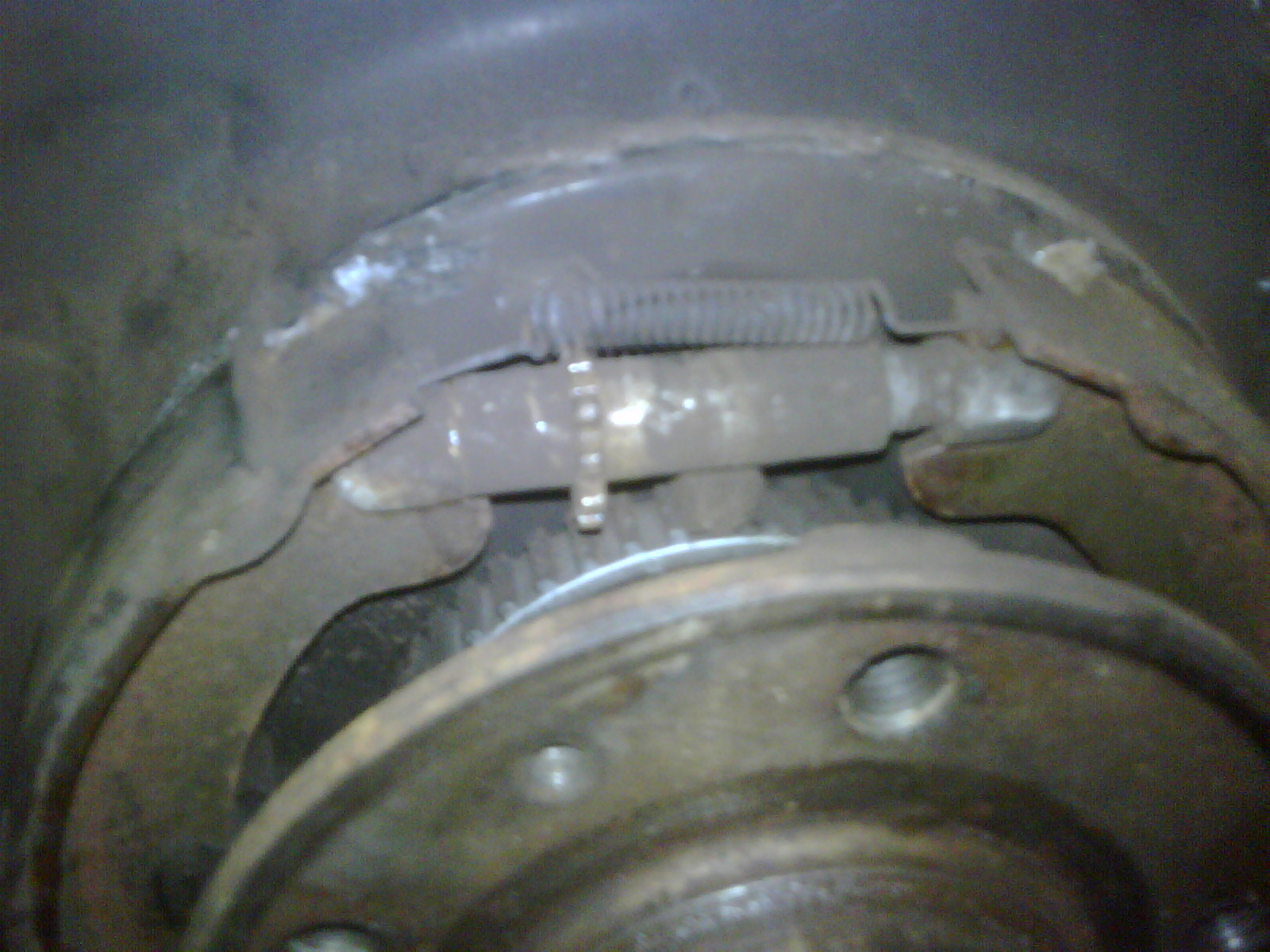

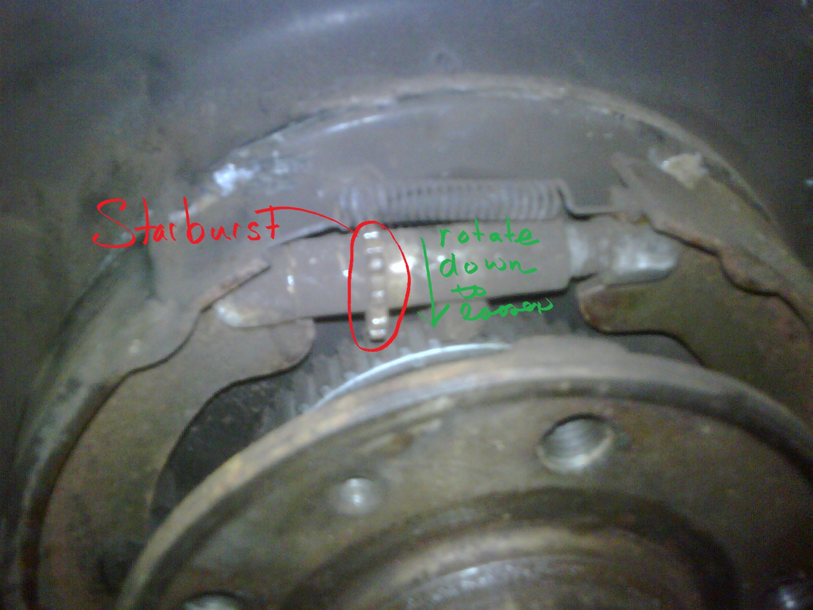

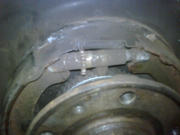

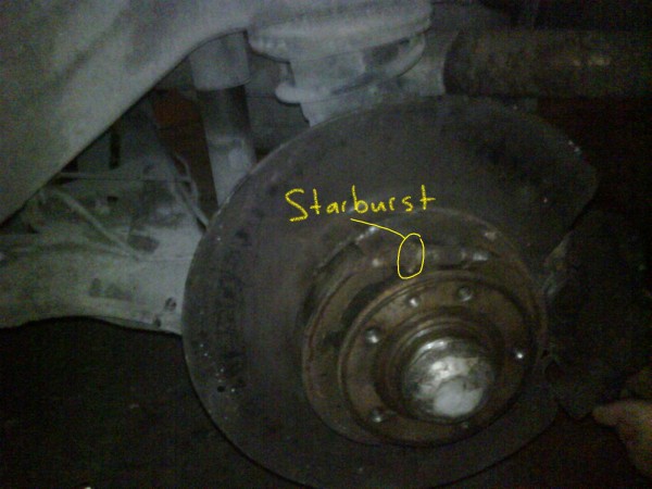

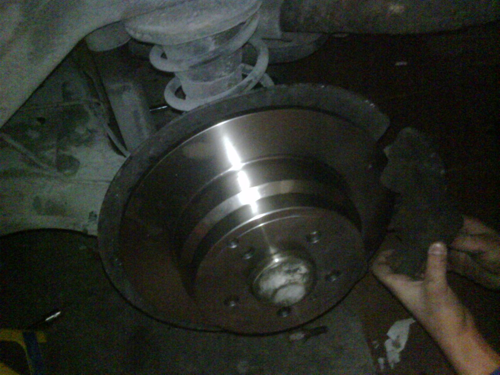

... With the generous help of John aka JDS60R..we have resolved the problem with rotors seeming to be attached to the hub.
In actual point of fact they were not attached to the hub. They were attached to the Emergency brake shoes. The Ebrake shoes were applying too much pressure on them and as such no matter how many hammer hits I did I still couldn't get the rotors off(both rear sides).
One side...like I said earlier I'm sure I damaged a little ..I hit the old rotor like 20 times at-least.... I kept thinking the rotor was being held to the hub by rust and corrosion...and that so many hits with the hammer would free it...boy was I wrong
JRL knew exactly why they were attached and how to detach them.
At about the 10-11 O'clock position there is a starburst type of bolt hat must be adjusted to decrease the tension of the E-brake on the rotor(gain access by rotating the disc hole to that position..the hole opposite of the one that unscrew in the disc retaining bolt)). With a flat head screw driver you have to keep rotating the starburst ...but literally by wedging the flathead screwdriver between the grooves in the star and making the star rotate downward (to loosen the E-brake...rotating the star upward will tighten the E-brake)..literally when you can rotate the star downward no longer ...you should have the E-brake shoes backed off at the maximum. The rotor should slide right out now,fairly easily, wiggle a little if needed.
Ta-Dah...that wasn't too bad...
Now don't forget to tighten the starburst bolt after you've installed the new rotor...otherwise you will have no E- brake.
If you think of tightening it before installing the new rotor you may end up with a rotor that won't fit....due to the extended E-brake shoes....I tried this...so I'm telling you from my experience.
