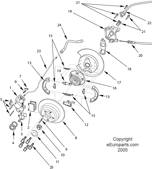

You did remove the disc guide screw (#9), right?

Yeah Al I did.
