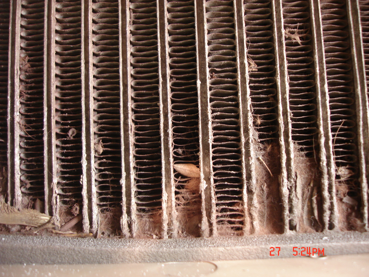

On cleaning the intake. When I look down the intake tube I see the blades
of the blower fan. Do you mean this area or the area under the plastic water
diverter above the filter? I didn't see much in either area. Just a little dust.
I will be replacing my blower and blower resistor shortly. I was thinking of
sending down a homemade camera probe to see what I is going down in the evaporator and
heater core area. Is this feasible given what you know about the hose routing?
Can I clean more with the blower out or is it just too difficult...

Volvo850 Deep Probe I gets a shot of my evaporator:
Quite a few leaves and bugs....my new cabin air filter should eliminate this problem.
