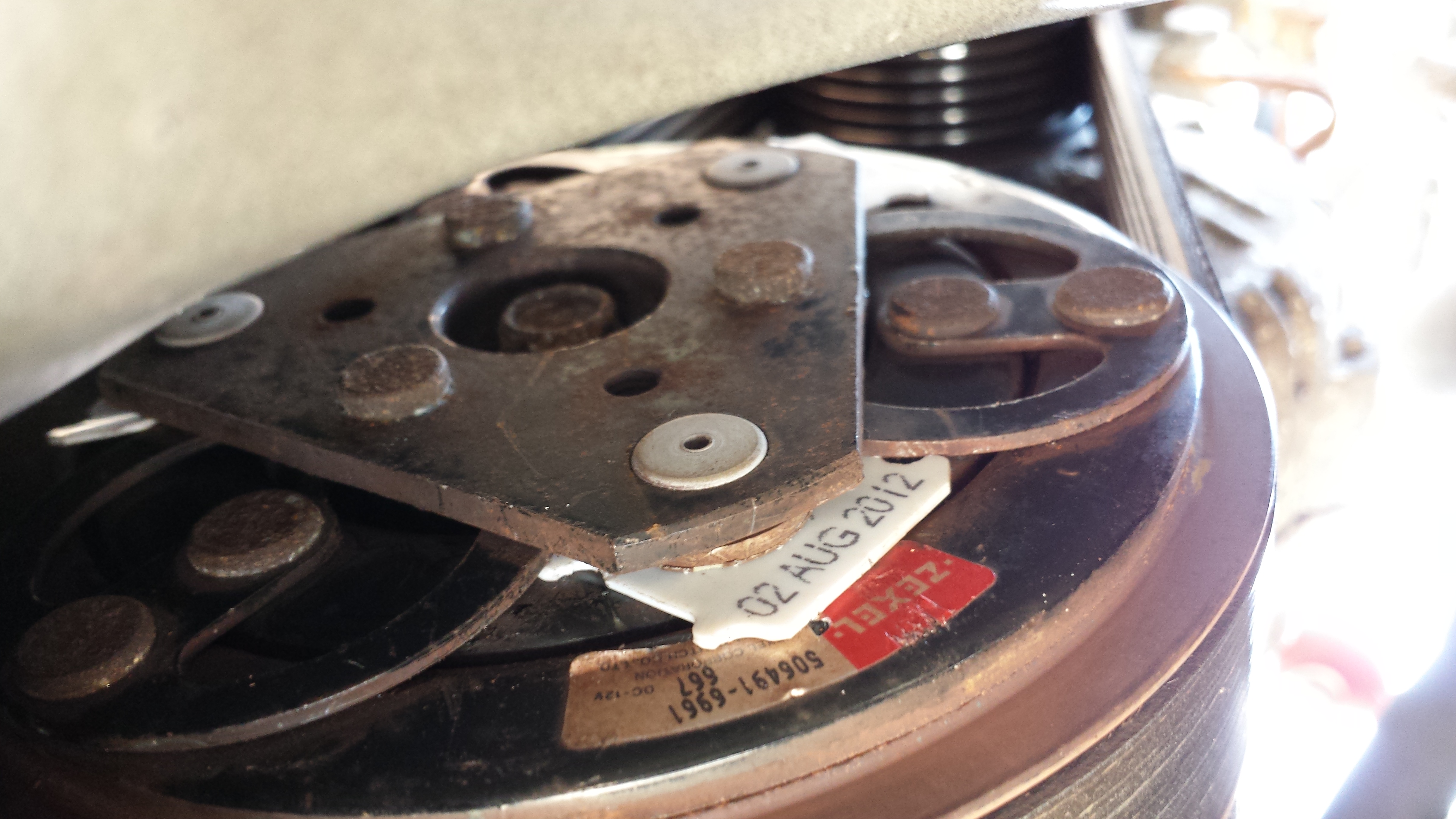

I see now. I wish I could tell you if it matters. It doesn't look like it would make any difference, but I honestly don't know and my clutch fix was too far in the distant past for me to remember that fine of a detail. I am trying too think about the physics of what is pushing what in which direction in that picture and what the moving parts are. When you turn the clutch to all the visible parts rotate?
Of course, one side of me is very curious why you can't get that space open enough to slide in the clip then the other side says, "just try it and see if it works" (before applying the glue - just in case). Sorry I can't be more helpful.......

C@lvin wrote:I see now. I wish I could tell you if it matters. It doesn't look like it would make any difference, but I honestly don't know and my clutch fix was too far in the distant past for me to remember that fine of a detail. I am trying too think about the physics of what is pushing what in which direction in that picture and what the moving parts are. When you turn the clutch to all the visible parts rotate?
Everythng to the left of the clutch gap rotates.
There a fix on volvospeed showing shims placed where the right arrow points.
If i can't get then to the left of the washer, I'll put them on the right

C@lvin wrote:If it works to on the right let us know so we can add that to our collective knowledge base.
Glad the heat has backed off for you.
Regards,
Sure thing.
Is there a minimum the cluth gap can be? The gap is 0.035+ (largest feeler I have). The clips are ~0.030. So it will be less than 0.020 if I use them.

I had the same problem sliding the shims between the rubber bumper/washer and the spring, so I put brass shims to the right (as shown in Osmium's picture above). I used cyanoacrylate super glue to hold the shims. It's been working for about 4 days so far. I'm keeping my eye on them.
This is the second time I've applied shims (the first time was with polyethylene shims and Duco cement... two of the three shims flew out after about 2 days of short trip driving around town).

VADIS says the clutch gap should be .3mm to .5mm. I think you are measuring in inches. If so, then yes, .02 inches (.5mm) is the maximum end of the acceptible range and .01 inches (.3mm) would be the minimum.osmium wrote:Is there a minimum the cluth gap can be? The gap is 0.035+ (largest feeler I have). The clips are ~0.030. So it will be less than 0.020 if I use them.

C@lvin wrote:VADIS says the clutch gap should be .3mm to .5mm. I think you are measuring in inches. If so, then yes, .02 inches (.5mm) is the maximum end of the acceptible range and .01 inches (.3mm) would be the minimum.osmium wrote:Is there a minimum the cluth gap can be? The gap is 0.035+ (largest feeler I have). The clips are ~0.030. So it will be less than 0.020 if I use them.
Thanks for the info.
My first attempt using the utility knife blades failed as 2 of the flew out on the test drive. Must not have gotten enough contact with the super glue.

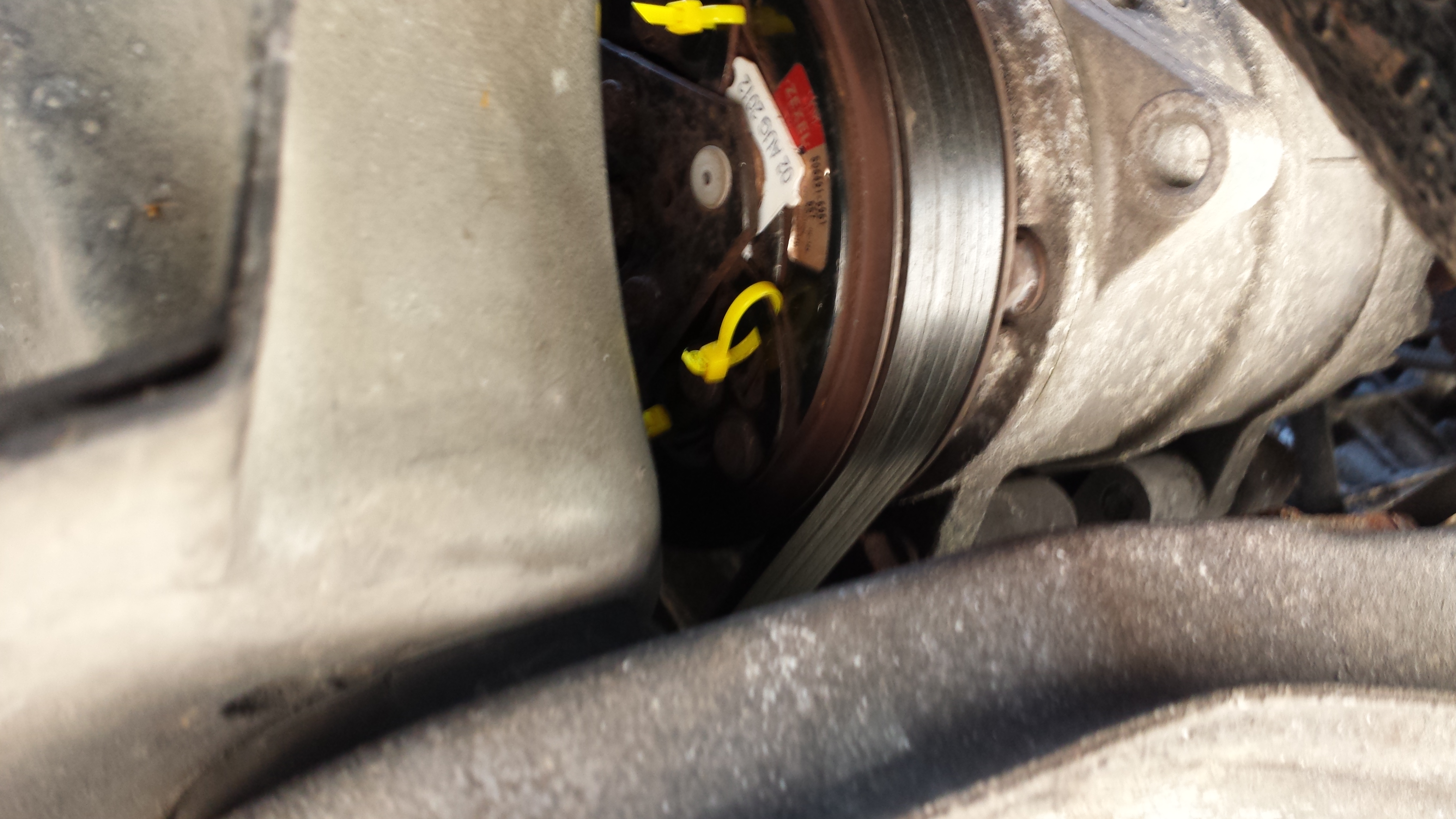

Alright so I've been working with this for a while. I was originally trying to get the bread clips and/or zip ties INTO the gap. I turned on the car and the AC clutch went around once then stopped.
I went back and read this post again and realized that I misunderstood and that it should be on the outside. Right? See photos: I forced 3 bread clips under those spots on the clutch and it didn't work. SO then I added zip ties after watching one of Robert's videos on another post. Still nothing. Am I putting this stuff in the right spot?
Are the small Yellow zip ties in the correct locations for optimum success? Do I need thicker zip ties?
See photo:
