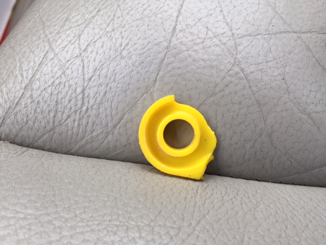

I am having the same shift problem as described above. Luckily, I came across this post, and today went to my dealer with only a picture of the yellow and black parts shown above. Parts guy knew immediately what they were and got me the last on-hand repair kit.

I have a 2005 s60 2.5T and this post depicted my exact problem with the shifter going from automatic to manual shift. I took the car to a local mechanic who removed the console to find the yellow plastic shifter part broken just like what was in this post. The local mechanic charged $180.00 which I thought was very fair for his time and parts.

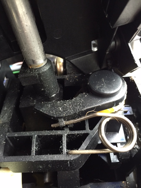

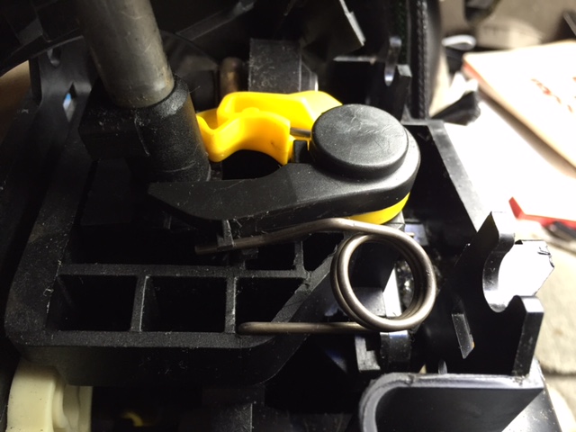

-Now you more than likely see a broke yellow piece of plastic and 2 springs. Remember how the springs are placed, this is important.
-Take the forward spring out, then with a small screwdriver, pop off the black plastic peg that holds the whole assembly together. Remove the broken yellow piece and black plastic piece with spring.
-Assemble the new clips (yellow on bottom, spring in the middle, and black clip on top), then put the new plastic peg through the assembly, hold that in one hand, move the shifter to the manual mode side and press the assembly onto the plastic stud until you hear it click. You may have to rotate the upper square cover for better clearance. Yes you will scrape your hand doing this, it sucks. While pressing onto the stud, you may need to open the "jaw" of the assembly to fit around the shaft of the gear selector.
-Orient the forward spring just as you found it. The end of the spring that has the 90 degree angle on it has to fit into a small recess deep inside that locks it in place, otherwise, after you put everything back together, this will pop back out and you will have to do this all over again. After it fits flush into the recess, bend it back so that the straight part slides into the side of the black plastic clip.

He's making it very confusing. The black Rivet needs to be pulled off. That's in his pics but he don't say anything about it.HHB wrote: 06 Nov 2010, 11:36 I'm assuming the cover from the rear is closest to the dash board, I must be doing something wrong, it aint budging. I see the u-clamps your talking about, just have no idea how to get them out. What tool did u use? Just don't want to brake anything
