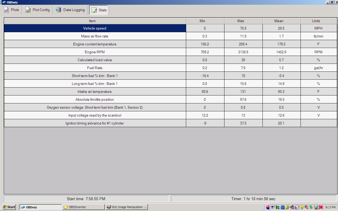

Finally, I got a scantool.net cable and SW (OBDwiz) and run a short test. Before I throw my data, I want to explain what has been going on. When I get O2 code, I feel the car getting sluggish (but still its an awesome ride. not really bad at all.) Then, I disconnect the battery, and try starting the engine a few times to discharge and clear ECU. When I reconnect the battery, the car feels restored. Then, it gets progressively worse little by little and I get the code again in 3-7 days. I have been repeating this for a while. So, what people has been saying here are bad MAF, bad O2 sensor connection, incompatible O2 sensor, leak around O2 sensor, vacuum leak and unmetered air, bad fuel injector and may be there was more.
I still have no clue what is causing my problem, but I got some data so that you can take a look and make more informed guesses.
Currently, I have no code or CEL on. I have been driving about 70 miles since I reset ECU a couple of days ago. However, I feel the car is getting sluggish especially when it is hot outside 90*F. I wouldn't be surprised if I get CEL on now.

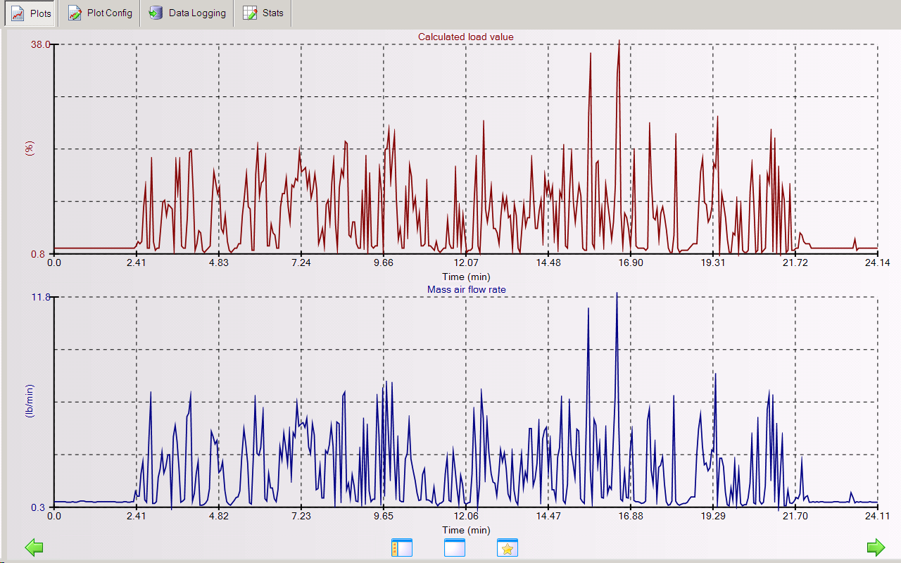

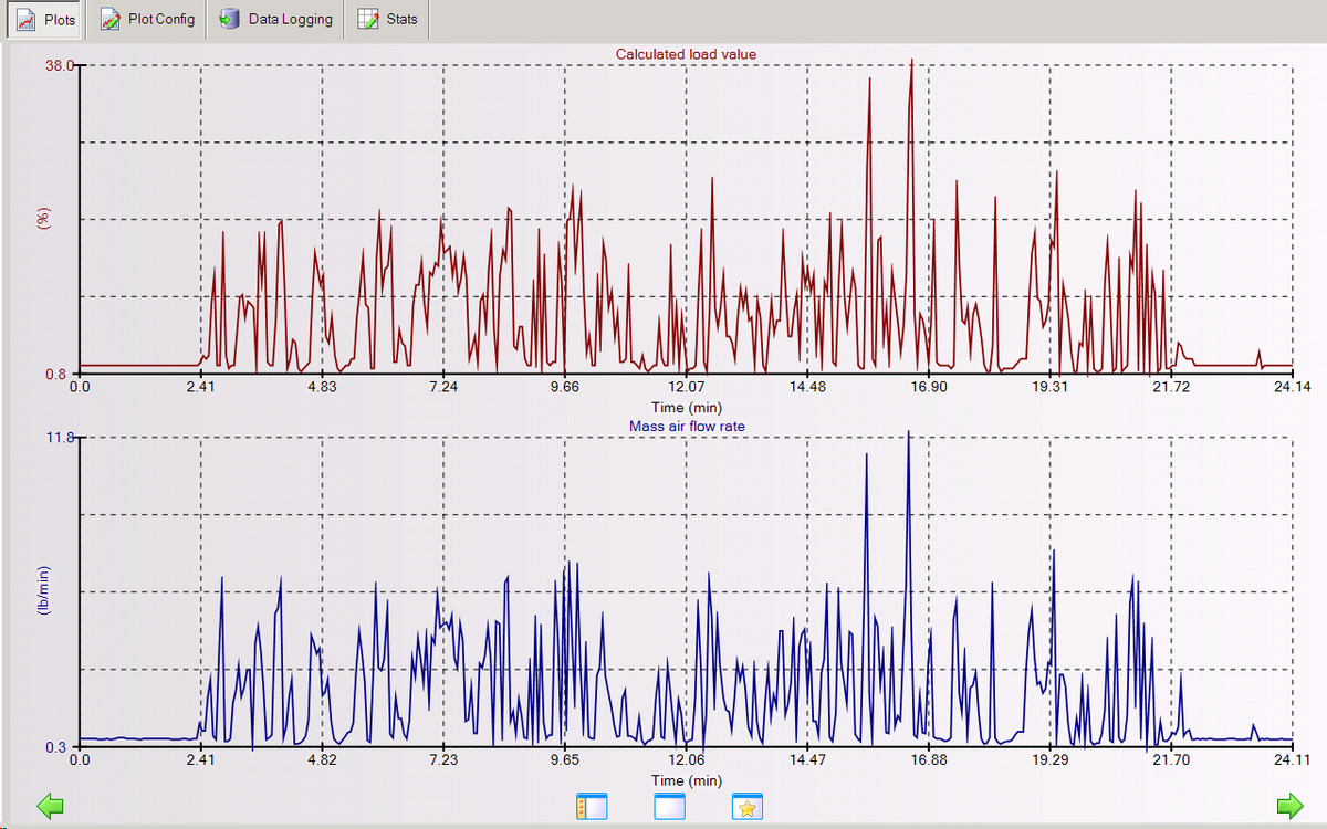

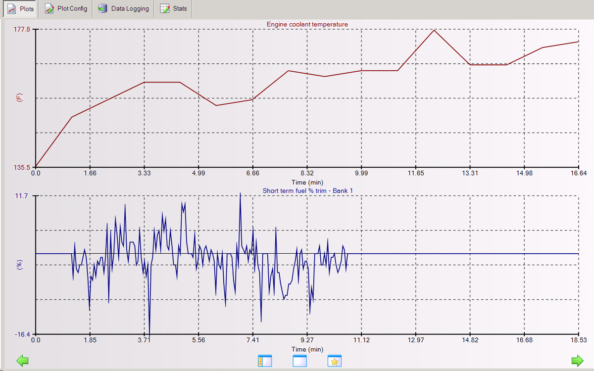

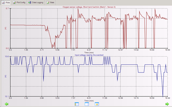

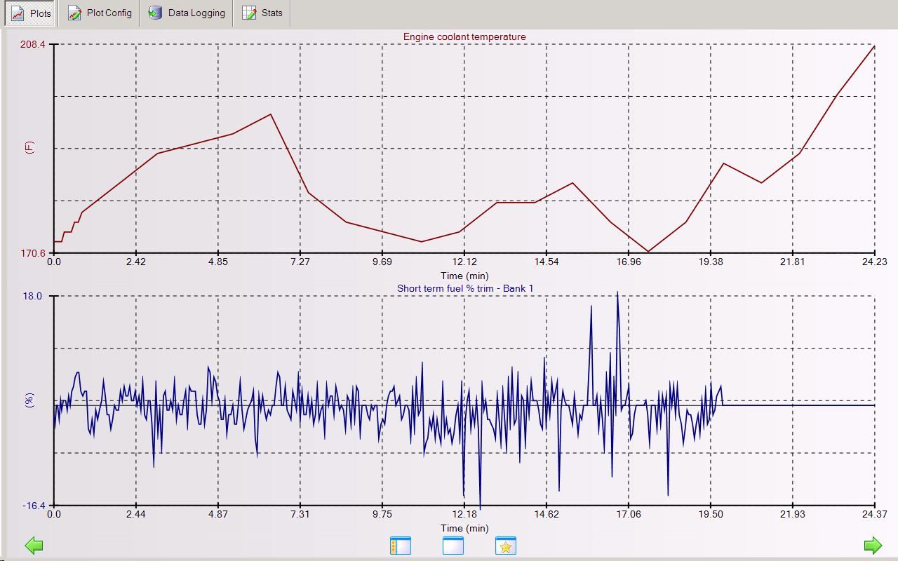

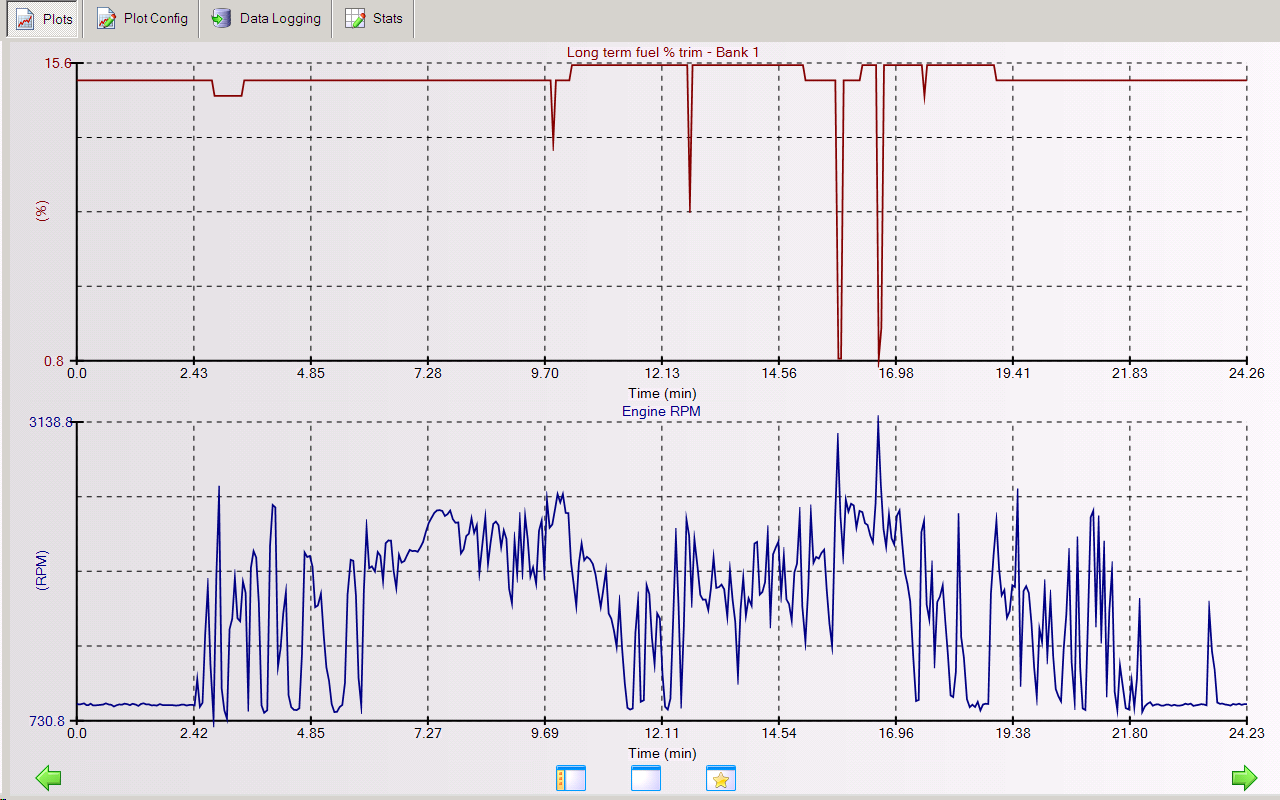

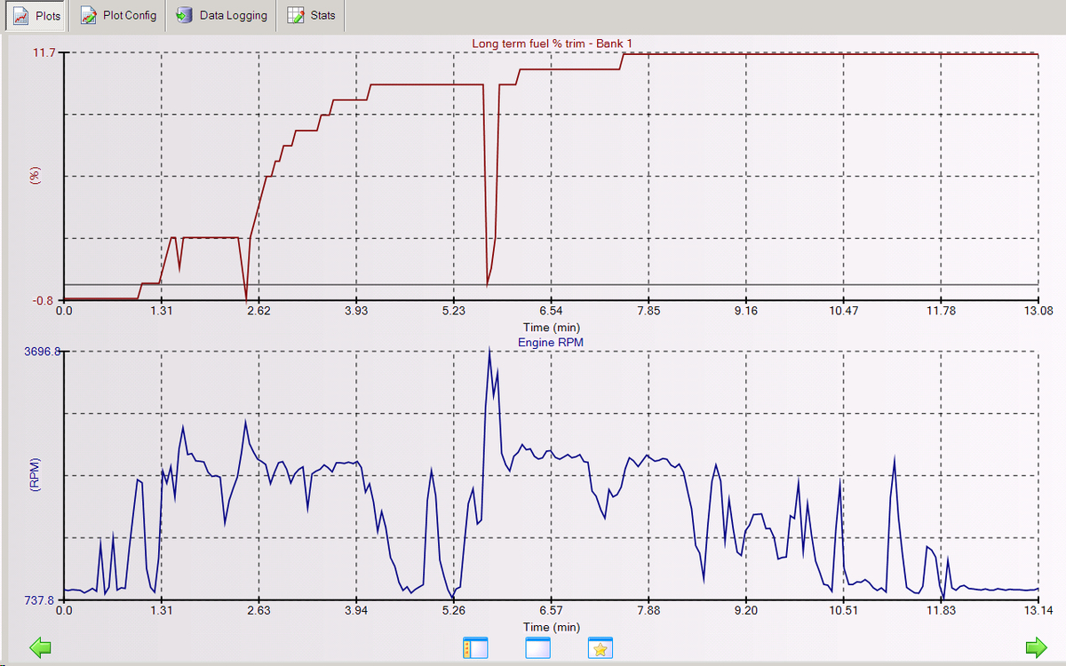

Now, I have two more sets of data. One set records when CEL comes on, and the other records after the reset. In the following two plot you will see when the front O2 sensor stopped working and the LTFT keeps increasing until it reaches a certain point since the reset.
right after ECU reset.
CEL came on around 10 min 30 se

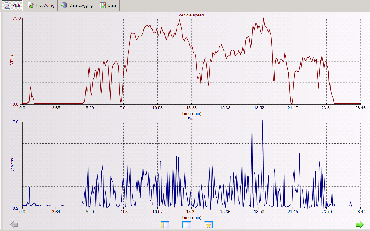

Ok, I did my homework and calculated Air-Fuel-Ratio. Still, I am not sure what I am doing is correct. Based on the data collected from two test runs, when CEL came on and after ECU reset,
When CEL came on
Mean (throughout the run)
Air: 2.3 lb/min = 2.3 lb/min x 60 min/hr = 138 lb/hr
Fuel: 1.6 gal/hr = 1.6 gal/hr x 6.15 pounds/gal = 9.84 pounds/hr
AFR: 138/9.84 = 14.024
at Max load (around 16 min)
Air: 15.8 lb/min = 15.8 lbs/min x 60 min/hr = 948 lbs/hr
Fuel: 10.5 gal/hr = 10.5 gal/hr x 6.15 pounds/gal = 64.575 pounds/hr
AFR: 948/64.585 = 14.681
After ECU reset
Mean
Fuel: 1.5 gal/hr = 1.5 gal/hr x 6.15 pounds/gal = 9.225 pounds/hr
AFR: 138/9.225 = 14.959
at max load (around 6 min)
Air: 13 lb/min = 13 lbs/min x 60 min/hr = 780 lbs/hr
Fuel: 8.6 gal/hr = 8.6 gal/hr x 6.15 pounds/gal = 52.89 pounds/hr
AFR: 948/64.585 = 14.748
So, according to these results, ECU is doing the right thing as long as the MAF and fuel sensor are generating the correct data, right? In this case, most likely the front O2 sensor is also doing nothing wrong considering its voltage range (0-0.7V) and the mean value (0.5V), which is consistent thought all three test runs. The only thing weird is that the ECU stopped reporting STFT when CEL came on even though the front O2 sensor voltage seems normal.
My guess on the increasing LTFT right after ECU reset is that the ECU is adapting to the high-flow K&N filter. So, it is how it supposed to be, settling around 11.7. But when CEL came on, LTFT was around 14.8, which is about 3% higher.
Any insight?
Other questions I have are how to calculate expected air mass entering? So, at Wide-Open-Throttle, MAF should report how much air mass? If I don't have WOT data, can I use the calculated load value and compute the proportional value of air mass at WOT?
EDIT: I just discovered that this tool I am using calculated fuel flow by a formula like this Fuel Flow Rate = MAF x Target Air/Fuel Ratio. So, this is putting me back to where I started.

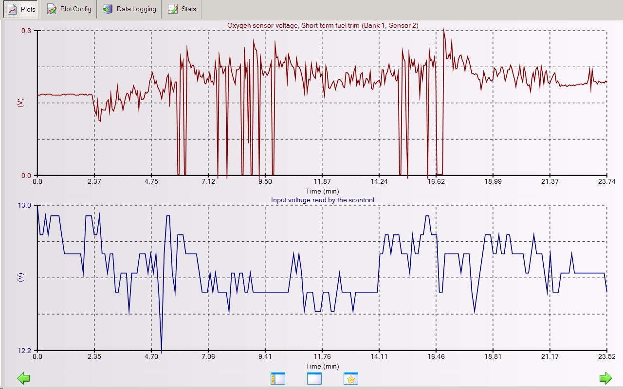

Even when ECU stopped reporting STFT the front O2 sensor voltage seems normal

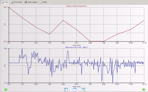

STFT when LTFT increases after ECU reset

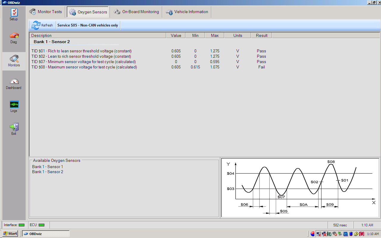

I got another code P0137, and the scan tool I have showed the following info saying that the sensor has failed one test. Can this be the source of my problem or just a result of my problem?
