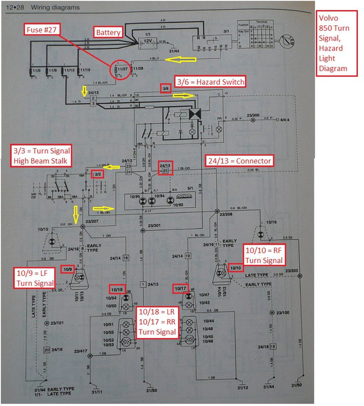

The posts by BEJinFbk and Teddy1975 seem to contradict each other.
My review of the electrical diagram shows that:
Battery ---> Ignition Switch ---> Fuse #27 ---> Hazard Switch ---> Turn Signal Stalk ---> R or L turn signal lights.
YELLOW arrows show the path from battery ---> Turn Signal lights.
See diagram below:
Thanks for the offer though!
See diagram below:

I'm not sure why, you'd think so. I'm fully agreeing with BEJ
As you say, the power runs through the hazard switch assembly on the way to the signal lights with a branch out to the turn signal stalk. So a problem with the circuit board in the hazard switch can cut the flow of power to the stalk = turn signal not working while hazards work fine.

Teddy1975,
I am thinking problem with Connector 24/13, yellow arrow ---> Turn Signal Stalk.
This explains my symptoms.
This is b/c if you look at the Hazard Switch, the power supply for the hazard switch and the wire (GN-R) that feed the Turn Signal is the same.
So the "break" has to be downstream of the hazard switch.

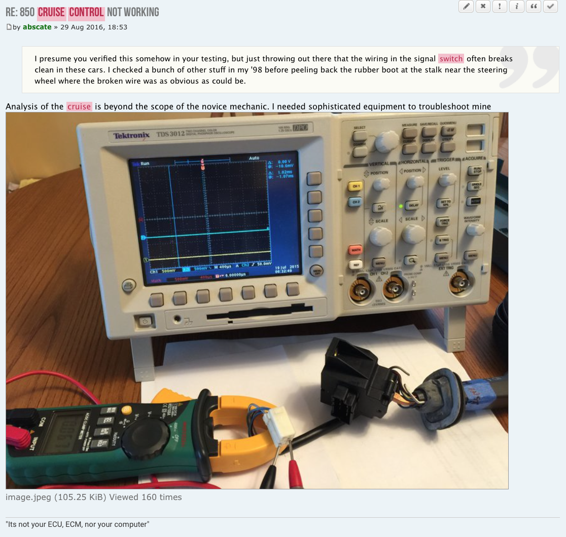

you need advanced equipment to test the turn signal switch - see here
Careful study of the waveform reveals why the cruise was inoperative
