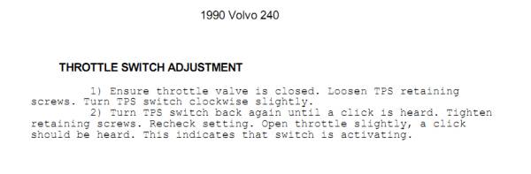

anyhoo, I've got the new TPS installed per my last post, and still no difference. To adjust my TPS, My Haynes manual is suggesting that I loosen both retaining screws that hold the TPS to the throttle body and either turn clock wise or counter clockwise, with making changes to the throttle control rod, & back out the throttle stop screw, etc. This NOT in any order, I"m just throwing out these steps that are part of making adjustments.
Despite changing the ATF it also feels like when I'm trying to accelerate it's wanting to go into the higher gear but it's waiting for something, so I let up on the gas pedal just a bit and it will fall into that gear. Does that help any ??

This is the Volvo instruction for adjusting the throttle position switch.
It is possible that getting the TPS adjusted properly will help the gear changes.

I wrote a response yesterday to your last post but I don't see it anywhere. Basically, I performed the adjustment on the TPS and was able to confirm the click etc., tighten up the retaining screws but no difference.
It's bizzare, though I have to gingerly feather the gas pedal at all stages of acceleration from zero up to 75MPH, once I"m at a cruising speed the car feels great, but when I slow down or come to a stop it happens each time I go to give it gas.
Last night after the car sat for most of the day, when I started it up and went around the blocked it drove great for the first few mins. then it went back to the same problem of poor acceleration. This morning I unplugged the TPS, started the car up and drove around the block and it did not give me any hesitation. I could tell no difference when it's plugged in or out. and once again after a few mins. it was back to the same issue.
I have a new code that sprung up yesterday, 1-2-1, fault in signal for air mass meter. Why this code should pop up all of the sudden is beyond me. I'm finding it a bid dangerous with the kids in the car as I can never guarantee that I will pull out into oncoming traffic & not accelerate quick enough.
