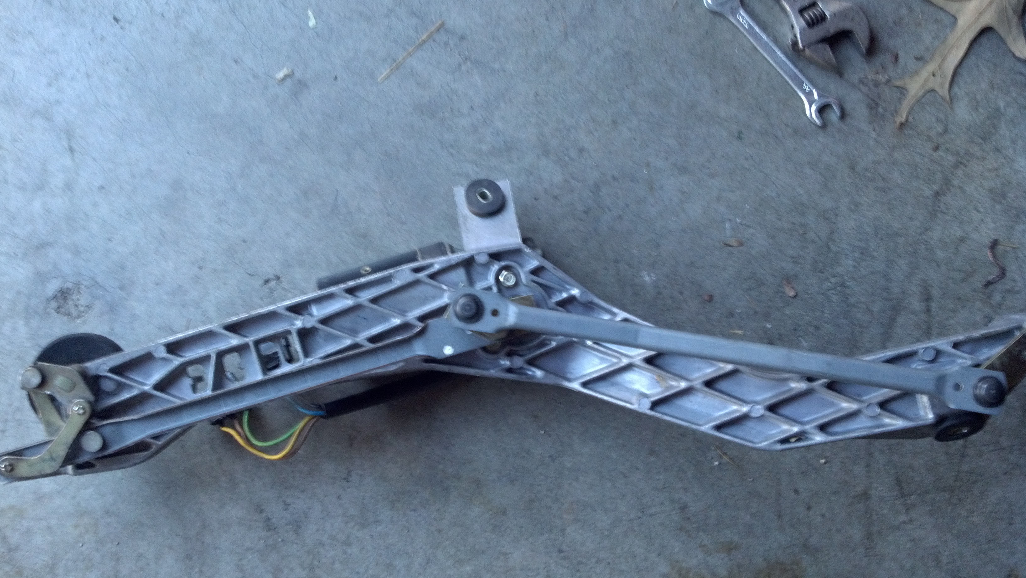

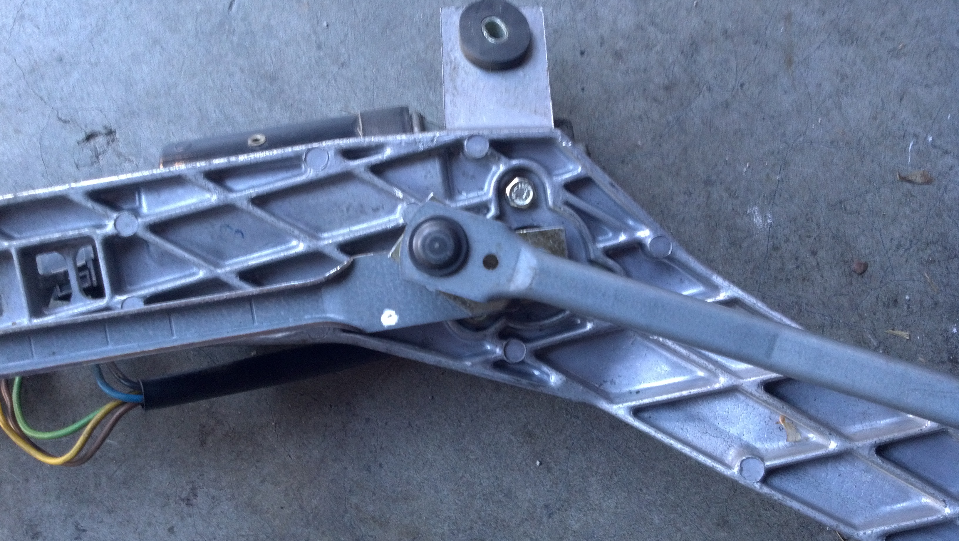

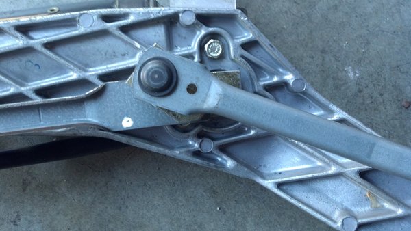

It's been so long that I've been on here...haven't done this in such a long time but going to try to put this in the repair database.
As far as I can tell (I've searched extensively), there is no such write-up or explanation on how to adjust your wiper linkage (also known as transmission or frame) anywhere on the web. My adventure was very frustrating to say the least but finally I got things working like they should. The following is a culmination of determination, hardheadedness and refusal to give up and take it to a Volvo mechanic.
Basically, you should be careful when you pull the old Linkage out to mark it or take a picture so when you replace it, you can get things aligned right without much headache...if you screw up here, you're in the same boat as I was. Remember that with this contraption, just a little adjustment goes a long way and can mess up not only where your wiper blades will end its cycle but also the direction as to which way they will travel (my first screw up was that the wiper blades started at the bottom of the windshield and wanted to go down (not up) into the engine compartment. So you won't have to go through all of this craziness, I have written this tutorial and tips on what and what not to do. Don't fret- Below is how to get things right again:
Before you start, make sure the motor is in the "parked" or off position (arms at the base of the windshield). If you aren't sure of this (even if you've already taken the wiper arms off), connect the motor back up and turn the lever on for the windshield wipers a couple of times and to the off position before turning the key off for your car. Stopping the wipers by turning the key off DOES NOT put them in the "parked" positions. This is vitally important and something I probably did wrong my first time.
1. Forget VADIS if you have it- none of what was in VADIS worked on my 850 (although- disclaimer- it could work for your car).
2. Haynes Manual is correct but imprecise- you do have to adjust things so that the brass section connecting to the motor is "parallel" to the next linkage just above it, but they should have said that the brass portion that connects to the motor extends out from the next closest linkage arm. Don't put the section that connects to the motor under and parallel to the linkage arm above it or your wiper blades will "park" or stop on the upswing.
3. Hold the brass knob looking portion that is at the highest level with an open ended wrench (I used an adjustable- worked fine) as a counter hold while you take off the motor and when you put it back on. Sockets won't work- you need a spanner here, trust me.
4. Make sure that the linkage arm (closest to the actual turning shaft that the arm attaches to on the driver's side) conforms to the frame of the device- in other words, not jutting out in the opposite direction- this was one of my issues early on as well. Hope this makes sense.
5. You can use some thread lock on the main nut to the motor if you're worried that it might work itself loose after awhile. I would stay away from the "red," which really locks things up as you might have to make minor adjustments as you go.
6. Taking the cowl and drain hoses off is the easy part but you don't want to have to do this over and over again (like I did) until you get things right. Also, only two bolts hold the linkage frame in- one end slides into a spongy bushing- twist back and forth to get it out- no need to tug on it. A big trick for me that worked great was to put the nuts on the shaft, mark them so you can see them rotate and leave the arms off until you're sure you have things right- this way you don't have to go through doing and undoing everything over and over and you lessen your chance of screwing up things on the shaft by taking the arms on and off.
7. Take the trim piece off from under the windshield glass while you try to put the motor and linkage back in...you can always put the trim on after these are in place. I chipped mine by leaving it in place- after years of being there, this piece gets brittle. No biggie, as the view of this piece is somewhat obstructed, but still it doesn't look good when chipped and chipping it causes grown men to curse.
8. Put the passenger side wiper arm first (leave the driver's side off) and turn the motor on and make adjustments. When things are right, then stop the wiper motor by turning the car key off with the wiper blade at the very top of its arch. Then attach the driver's side wiper arm with the edge about 1/2 inch from the edge of the glass. Note that the driver's side wiper blade is suppose to be slightly up on the glass at the stopped/lower position compared to the passenger side.
8. Finally, three views of the Volvo 850 Wiper Linkage adjusted properly below- so that the arms park as the bottom of the windshield and go up to the top as they ought to. Note the brass pieces and how they are turned and positioned.
