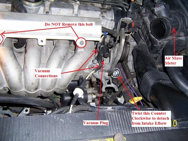

MathewRe-routing if necessary to bypass the fragile OEM setup, like the one that goes from the PTC nipple to the Super Evil™ passenger side (North America) manifold nipple. The one that throws a P0172 if it's not on.
Where does the vacuum hose go to from the intake manifold? I have a non-turbo. Is it easy to get at to replace the whole hose and re-rote it across the front?
