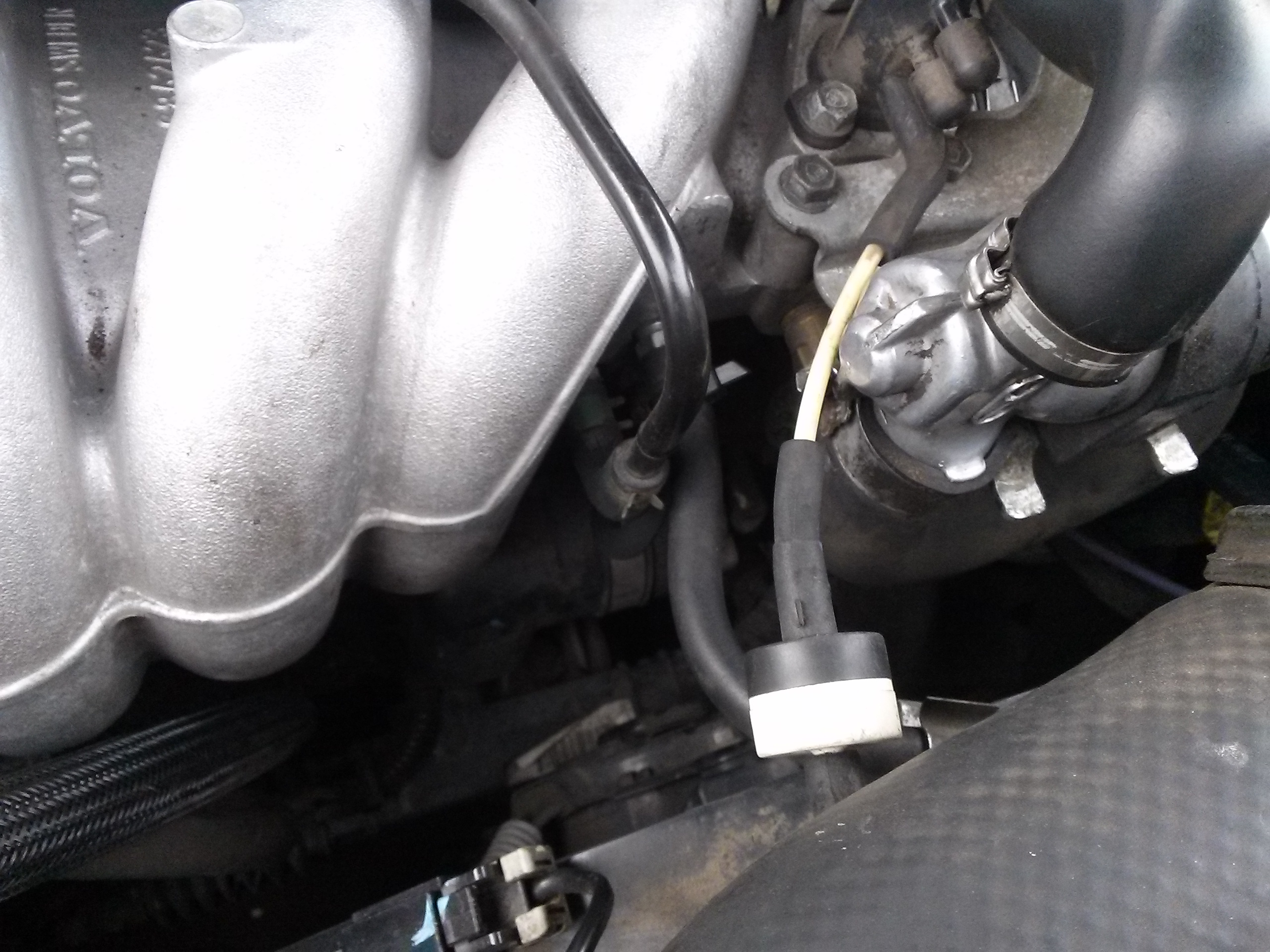

Hello friends, in the process of changing all the hoses in my 98 S70t5 and I've got an elbow jutting out of my manifold to a hardline. that is just absolutely decrepit. I plan on replacing it. My only concern is its fuel, rather than vacuum and I don't want to be without the part if it disintegrates upon removal.
So, pic is attached, on hand I have plenty of 5mm silicone tubing from other vacuum lines I've replaced. Will they work in my application? Thanks in advance.
Rubber elbow. Fuel or vacuum?

If you are referring to the line from the vacuum tree( thing with line and two capped ports), then plastic, then to the vacuum check valve(black/white disk), yes it is a vacuum line
If, on the other hand, you mean the larger plastic tube, that is emissions tubing, so yes, silicone can be used there also.-edit, d'oh thanks Erik
Current Volvos:
The elbow in question connects to the black hardline that is crossing above the manifold in my picture. Probably on its way to my fuel pressure regulator near the passenger wheel well.
I've never used silicone hose as a fuel hose if it turned out to be one. so that's where my trepidation occurred. If it is no issue, I will replace with confidence.

It is indeed a vacuum line, and runs vacuum (to the FPR), not fuel. You are good to go with silicone.

+1 on erikv11's comment. I've had a short piece of blue silicone tubing in that location for the past four or five years, ever since my original one developed cracks and crumbled. I used the thick wall tubing because it resists kinking a little better than the regular thin wall tubing. The angle from the intake manifold nipple to the black metal line is pretty sharp and occurs over a short distance.
