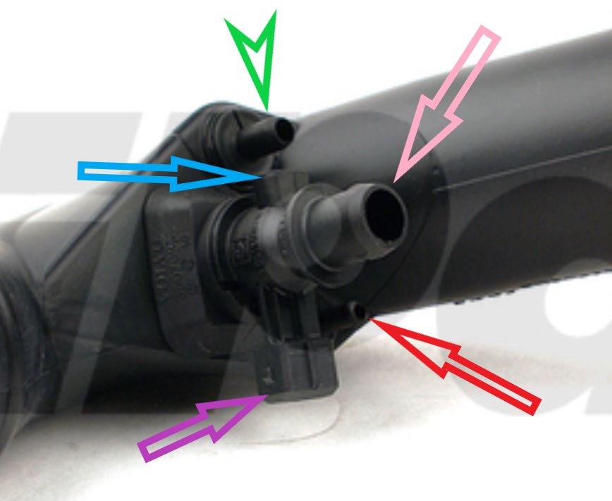

After drawing a diagram I checked all the hoses to verify where they're connected to.
Green: EVAP purge valve
Pink: PCV oil trapper
Red: Turbo boost solenoid
Purple: PTC electrical connection
Blue: ?
There is nothing connected to the PTC nipple pointing to the blue arrow. Am I missing a hose or is this tiny port for ventilation?

Blue is not a port. It houses sensors. The PTC can be pulled off from the pipe for cleaning, but be careful. Wetness from moisture is normal.

Post by XC70Rider »
The diagram in my first post shows an elbow hose connected to it but that must be for earlier volvos. There is a thru hole in that flat sided housing section so I can see inside the air intake pipe.
That open hole had me judging that is why she is running slightly lean. No codes but she starts off at 5% lean then makes it down to 1% after a 15min warmup. I changed all the vacuum hoses. The break system holds most vacuum overnight. The vacuum pump still comes on for a few seconds only after several hours of sitting so it's not abnormal.
The PTC port for the PCV hose had no crud when I removed the air intake pipe so I just gave it another easy cleaning.
