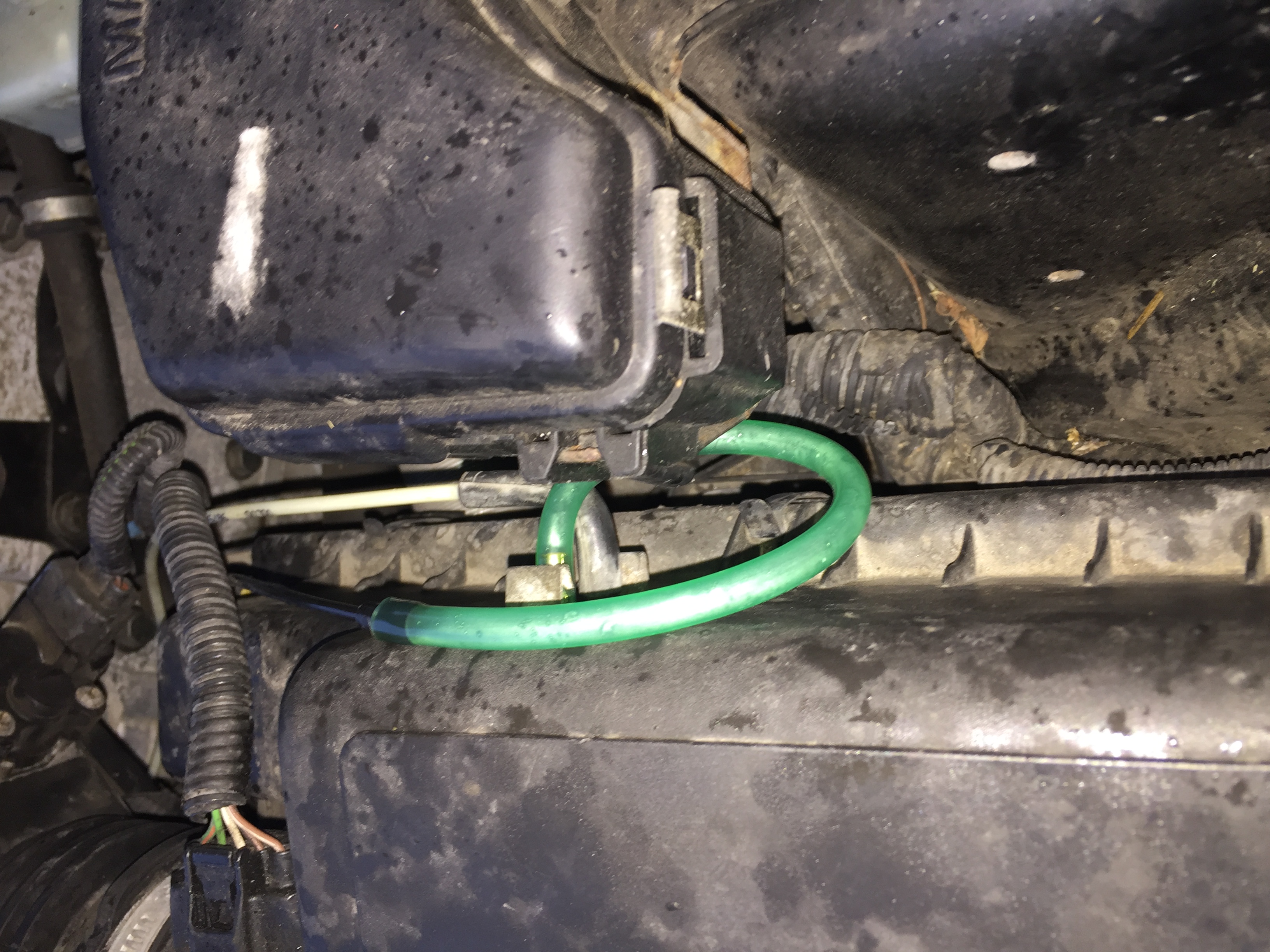

Hi all, I had the problem of breaking the connection between the black hose and the top half of the airbox. I fixed it using some green tubing (petrol hose for a dirt bike) with an inner diameter of 5 mm. See the pic.
Best Bart
