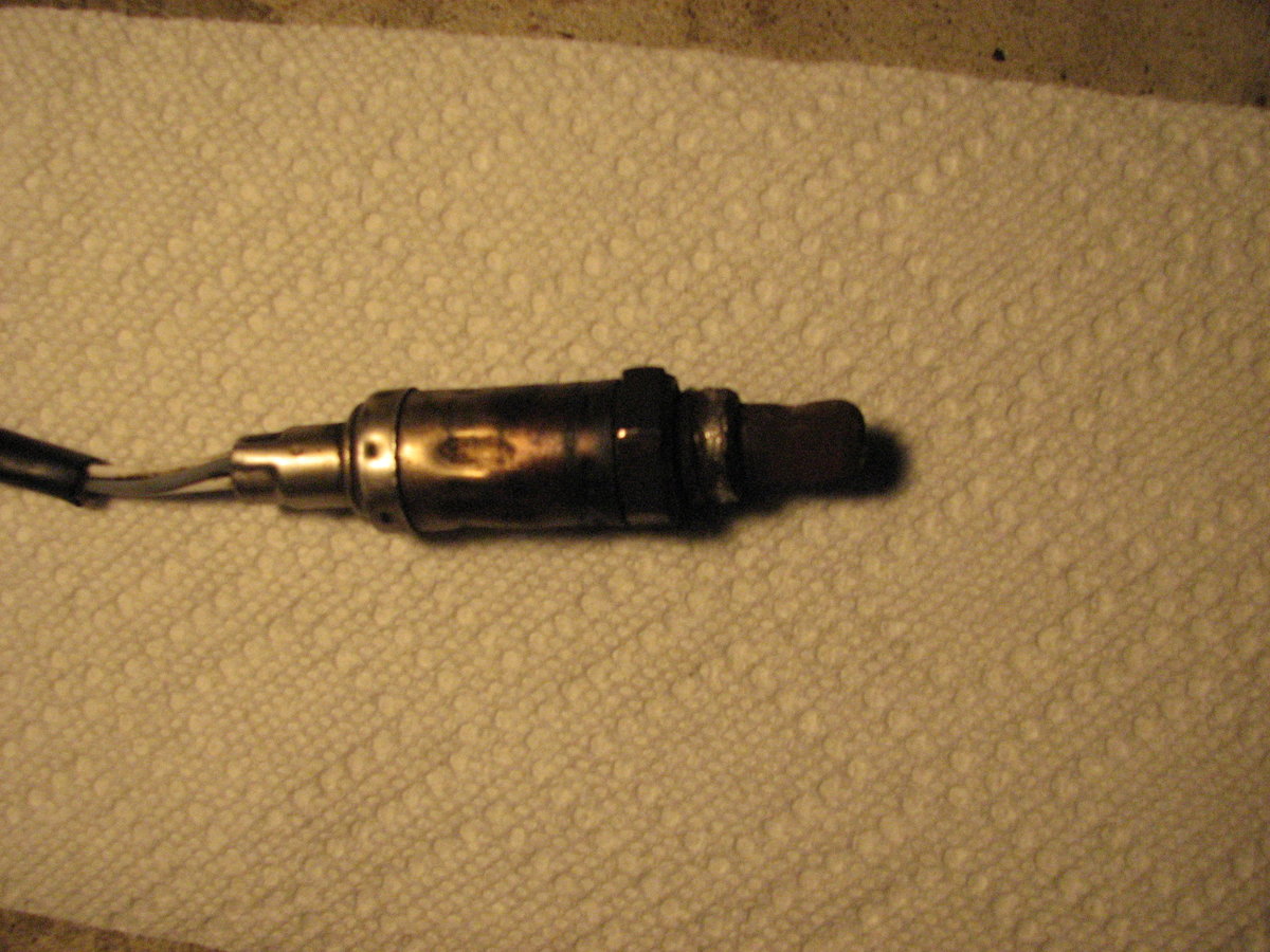

I wanted to add something relevant to this thread. Only yesterday, I replaced the front O2 sensor.
This should not be overlooked. As I have replaced most all of the parts relating to ignition, timing, fuel delivery and aspiration. I neglected one of the pieces linking it all together.
Old O2 Sensor. I don't think it was Bosch either. The new one is.
Without going into the details of the function of the O2 sensor, it was the cause of power inefficiencies across the board. It is now a completely different and consistent driving experience. Most all previous issues and symptoms are gone and the new parts and simple modifications have begun to operate as intended.
Previously, I would have expected a code for an O2 failure, but being a '93 with OBD I diagnostics, it was not apparent.
I am happy to share this today because it has put my mind to rest of some irksome performance issues, and proved all the parts investments in these areas to be worthwhile.

Ben850 - Thanks for sharing your experience. I can't seem to be able to edit my original post or I would add O2 to the list.
I had a front O2 issues shortly after I bought my car, but being an OBDII it quickly threw a CEL and was easy to diagnose.

Good info to know. I was planning to wait on the code like my V70 throws. This way, I can just fix it now and not worry about getting stranded later.

Looks like a pretty thorough thread so far. I have experienced intermediate idle/acceleration issues since I purchased the car 4.5 years ago (had 124, 000 miles at purchase). I finally think I have it mostly worked out. Replaced all the vacuum lines and rerouted the hose around the manifold. Also replaced the IAC which was intermittently cutting out and was difficult to diagnose. Pulled a couple at junkyard and have a couple extra if someone would like to try that. Went through a cheap MAS then got a Bosch. I had been holding off on replacing the front O2 sensor because many have said it usually is vac lines. I completely agree with what some have said here, if you are unsure and the car has over 100,000 miles, just replace it. Completely changed the performance, steadied the idle and acceleration. For ~$90 on amazon just do it. Takes about 30 minutes.
I think most of us come into the relationship with our Volvo not knowing the maintenance history. Just take your time, go through the possibilities, and keep reading this site. Such a wealth of information that can save many headaches and hits to the pocket book.
So again, if you have checked the vac lines, IAC, plugs etc., try a new front sensor.
